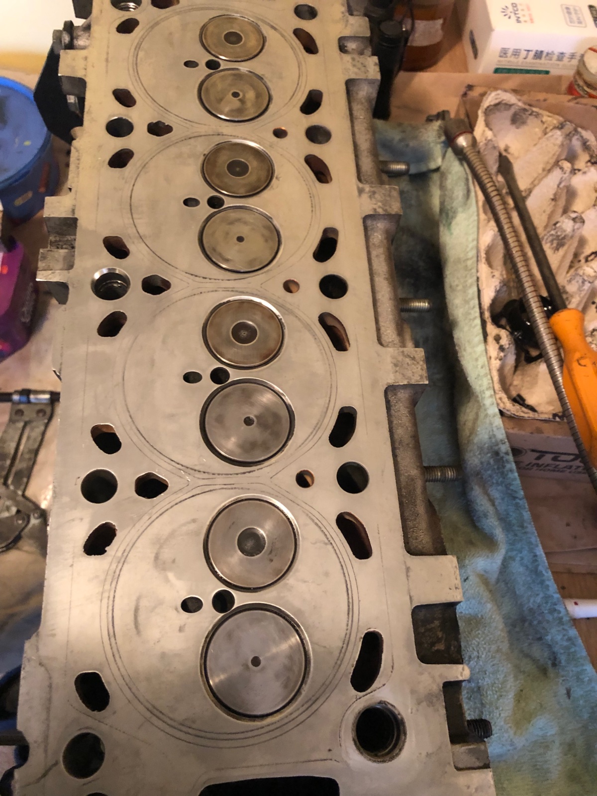

moizeau wrote: 05 Feb 2026, 15:30 Have I done a Quantum Leap? How has this gone from a cylinder head rebuild to a solenoid?
Skull’s- HDi head assembly
No you’re quite sane moizeau 8-[ Just about anyway …
Just a bit of a :offtopic: tangent thrown ….the head has gone back on today ….jeez I had to extend my torque wrench with an axle stand tube just to get the necessary leverage to manage the angle torques ….done ….

Skull wrote: 05 Feb 2026, 16:39
That's looking nice!
Correct thickness for new gasket as previously mentioned?
Do you think we'll be on for the GRAND DEPART this weekend?

Rhothgar wrote: 05 Feb 2026, 16:51 That's looking nice!
Yes - 1.35mm gasket (2 notch)
and
No - dog sitting a limpet of a Cocker Spaniel for a week won’t be able to do much but will clean up inlet manifold /coolant outlet and try dressing the camshaft dink anything else will be the week after ….

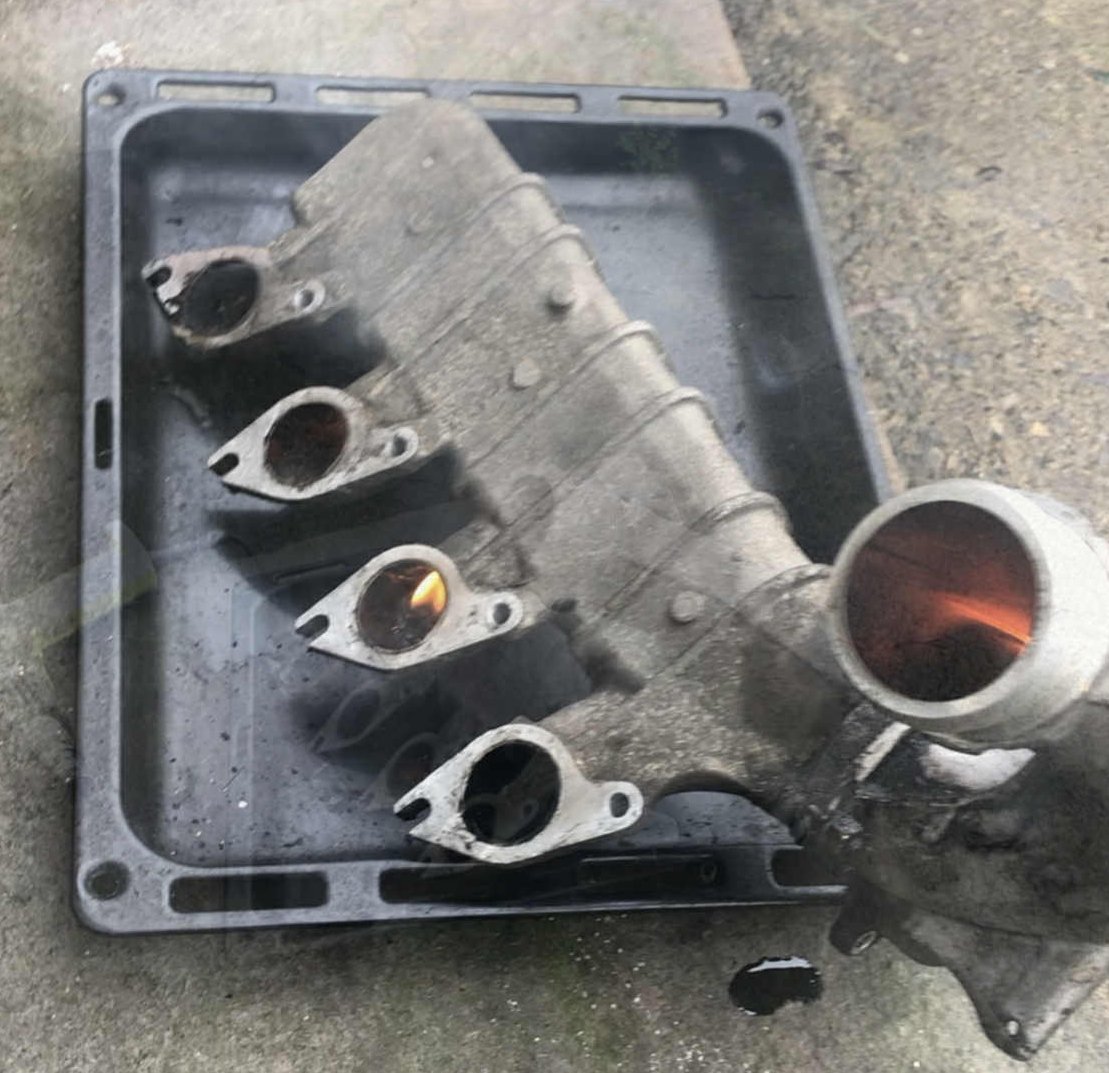

How manky is your inlet manifold? It’s a job I need to do on mine. Will you be using the ‘firestarter’ method? 😁
I think it was MattBLancs who did a post on it.

Unread post by MattBLancs »
Hello, head arsonist, you called :rofl2:
EGR pipework clean out:
viewtopic.php?p=784253&hilit=Fire#p784253
I'll find the DW10 inlet manifold cleaning image shortly
Edit: here we go:
viewtopic.php?p=731043#p731043

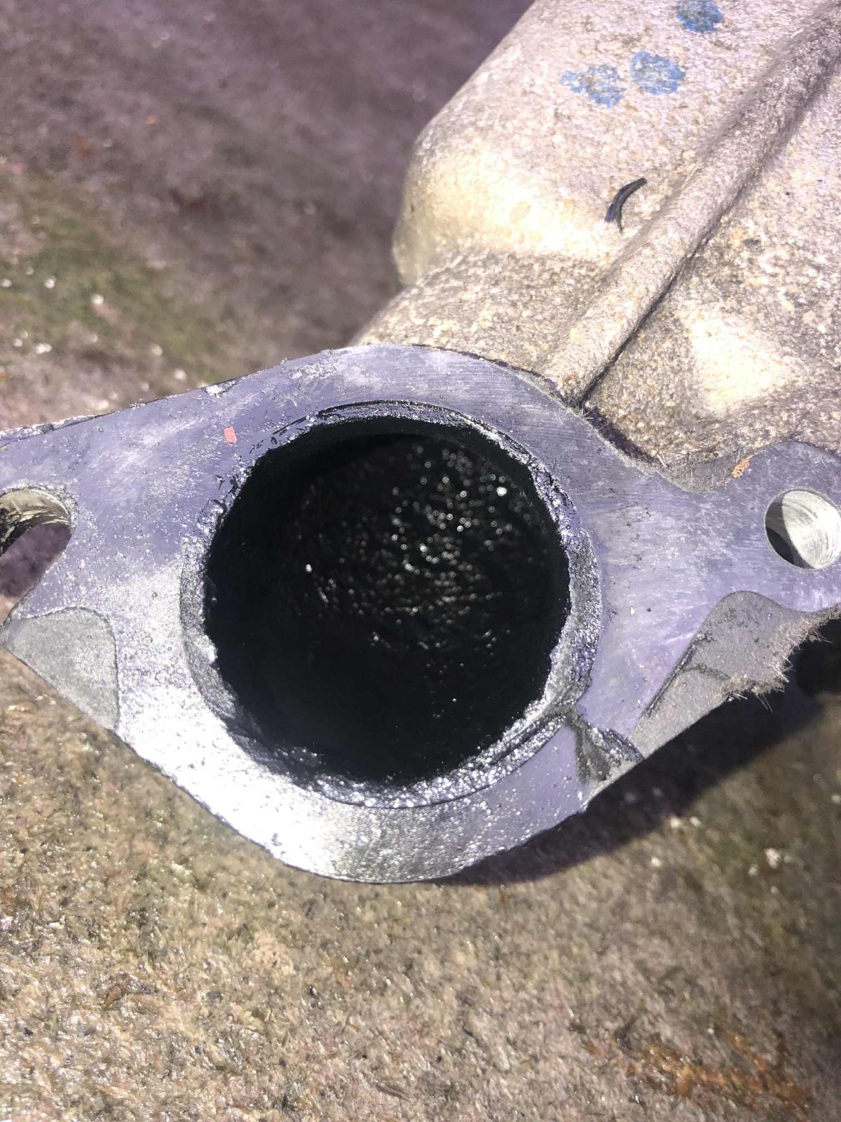

Unread post by Skull »
Cheers MattBLancs
I didn't think mine was too bad :?:
Skull's - HDi Intake manifold
but soon caught fire ...
Skull's - HDi Flame on
There's a lovely video of my garden instead of what I wanted my wife to video :roll:
