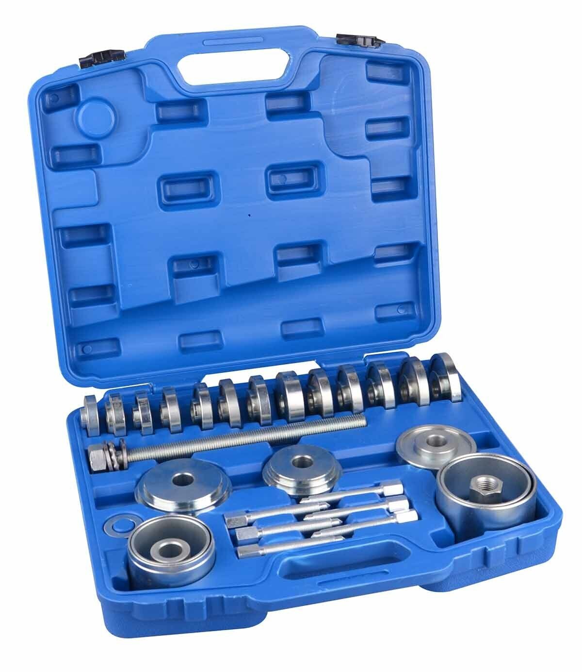

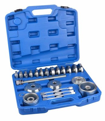

Getting a bearing on things...
So I have another problem now... drivers side front wheel bearing...
Can anyone tell me if these can be pressed out with one of these below kits?
Or do I need to let a pukka garage do it on one of their big hydraulic presses?
I only ask because no one seems to have posted anything about replacing these online, so I wonder it its a bit more tricky than a suspension bush?

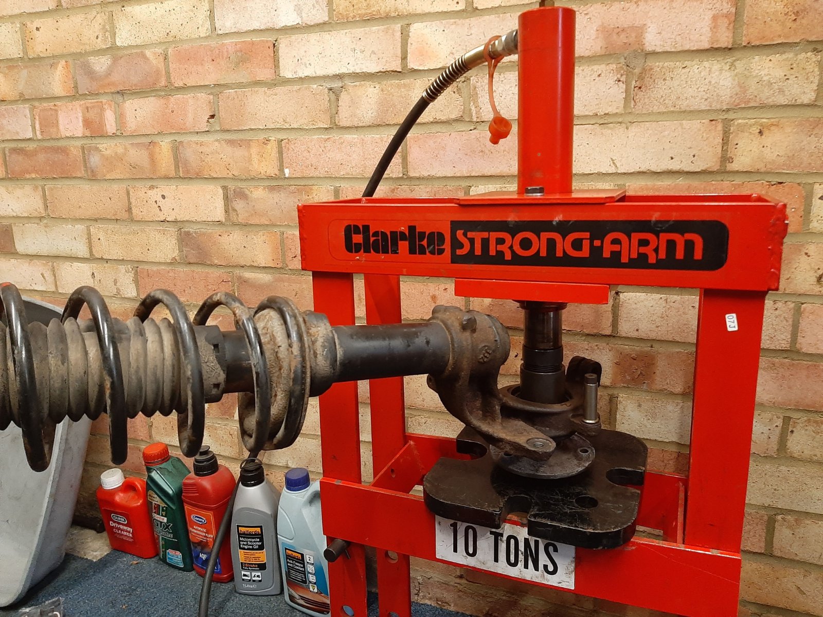

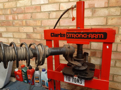

My experiece is that wheel bearings are very snug in their housings after a few years Chris and take quite a lot to evict them...
Many years ago I recall reading in the Pug 205 Haynes - press out the bearings using a vice and sockets complete with pictures making the job look a doddle..
I tried and found it was anything but. I borrowed time on a hydraulic press and they needed almost 10 tons of pressure to release them. As they released they went off with a huge bang with scared my mate, who was watching with interest, almost half to death - he ran out of the workshop and hid
I then bough my own little 10 ton press and it's been one of the most useful tools in my workshop. It's done hundreds of Xantia, XM, Saxo, 106 and AX bearings over the years and assisted in rebuilding a few gearboxes...
So, short answer is no, I'm sorry to say that kit is not likely to be a guaranteed success. I'd spend a bit more and buy a press, you'll never regret it, I promise.

It could be a great buy! Yes, 10 Tons is normally enough but some need a little more... I've pushed mine so hard I've bent the bed and wrapped the pressure gauge needle around the end stop and bent it...Armidillo wrote: 29 Nov 2023, 11:17No bids yet - you might get it for cheap! Will 10 ton be enough? Just enough, according to Jimmickthemaverick wrote: 29 Nov 2023, 11:15 Bit of a spooky here, this just came to my attention having just read this thread. May be useful to you Chris as it's not too far away from you:![]()
https://www.i-bidder.com/en-gb/auction- ... c800ebadce.
Particularly well rusted XM wheel bearings tested mine to the limit but it did the job eventually... So in short, 10 tons will do, especially if got cheap enough

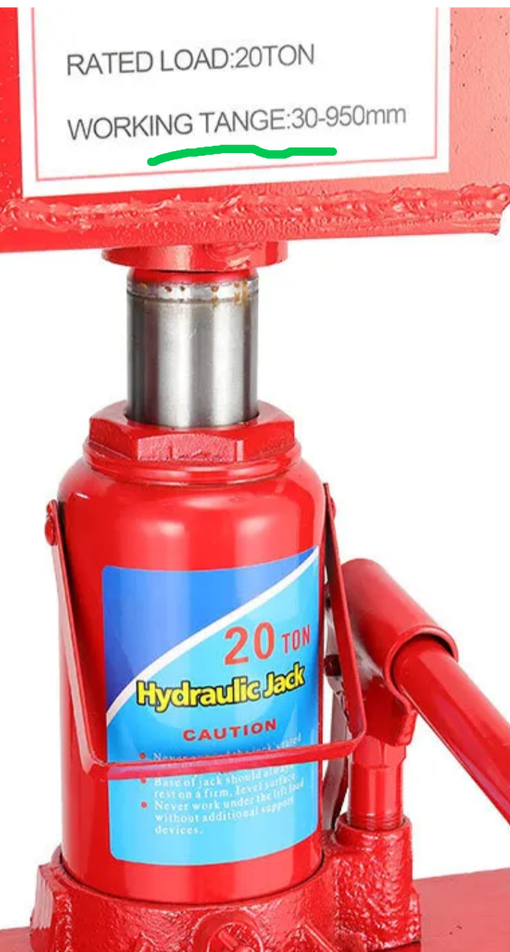

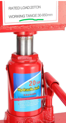

https://www.ebay.co.uk/itm/134717964137?
Just a comparative, new cheap tat alternative, £146, claimed 20 Ton capacity.
Hope whoever did the calcs for the capacity was paid more than the translator!

Defined as 'The explosive result of trying to lift 20 tons with a little bottle jack' The figure is how far in mm the debris will fly...
TANGE - that's my new word of the dayMattBLancs wrote: 29 Nov 2023, 20:50 Hope whoever did the calcs for the capacity was paid more than the translator!![]()
