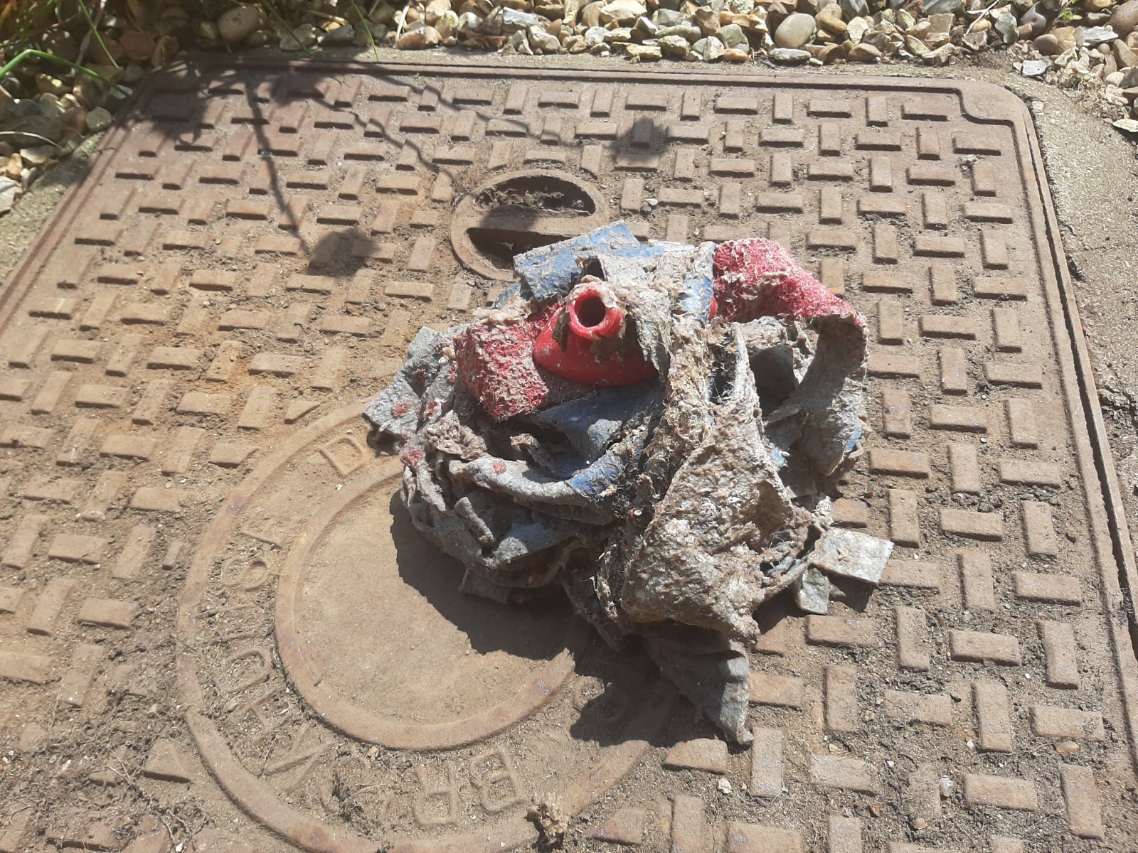

It's been a bit of a $h1t morning
Late last night I heard my downstairs loo gurgle. I know my downstairs loo. If it gurgles it's a proper harbinger of doom and I know I have a bit of 'fun' (and something else) on my hands
This morning I found my and four of my neighbours drains blocked and backing-up. We five share a common drain all running on our own land. It was urgent as I was not far off having raw sewage spilling into my house. Ditto two of my neighbours.
I got my rods out and found the cause... A mop-head jammed in the pipe leading to the sewer interceptor
Took ages to pull the bloody thing out. All done lying on my front and leaning down into a deep inspection pit and feeling the blockage.. Literally up to my neck in the aforementioned smelly stuff...
At first I thought the mop-head was a clump of roots... It felt a bit like it... It was made worse by having a load of baby wipes clumped around it... Those were the final straw and responsible for the final plugging of the pipe...
A properly sh1tty job - literally - and it took three hours all told. I fear it's set my recovery back a bit
But job done
It's not the first time I've done our drains and I guess it won't be the last. Good job I have a set of rods
It took a while and it took a while to get my appetite for dinner back...
Still, on the bright side, we saved a collective fortune not having to call out Dyno-Rod ... Neighbours mucked in where they could and were very appreciative

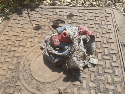

But job done

Yes, we think we know, going by pipe sizes and the size of the mop and a process of elimination... I'm of the belief the guilty party had a blocked loo and used the mop to try to clear it and the head came off and went for a swim...

I was glad, in retrospect, it was a mop head and not something more sinister or worse blocking our drains...
Going by how many I dragged out today, most people still have not got the message that baby wipes are NOT flushable

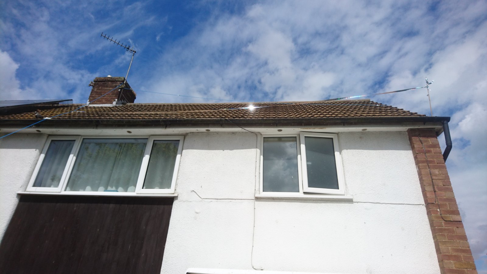

Just an update on my bird scarer, it has been over a month since I installed the Mk3 version to keep it quiet and the neighbours happy. It is still up there and glinting away as you can see in this picture and I am happy to say that we are devoid of the pigeons and all that went with them!! Happy days!!
