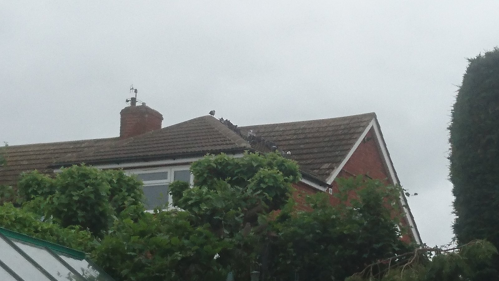

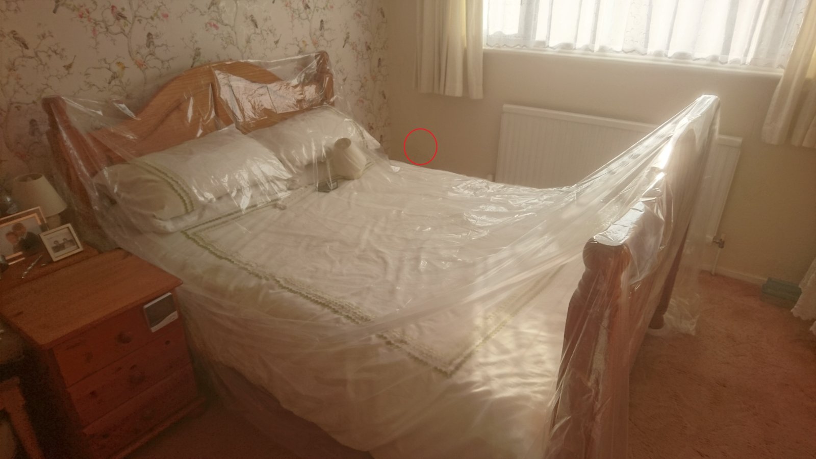

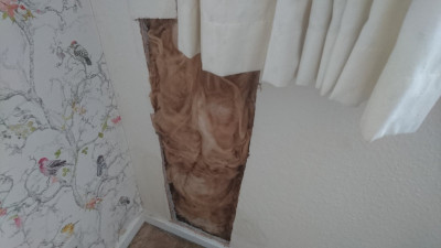

With no sign of the pigeon scaring tape today I turned my attention to the other issue which is currently irritating us, or more precisely irritating SWMBO. For the last couple of years she has been getting a damp patch appear on her bedroom wall on cold wet days. So far she has paid out a lot of money having the dormer flat roof above her bedroom completely stripped and relayed - no change, then she paid out to have the outside pointing redone - no change and finally we had the front plastic cladding joints resealed - no change!! This is the area in question in the red circle:
MTM Original
MTM Original

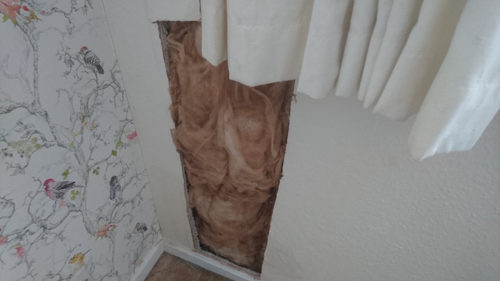

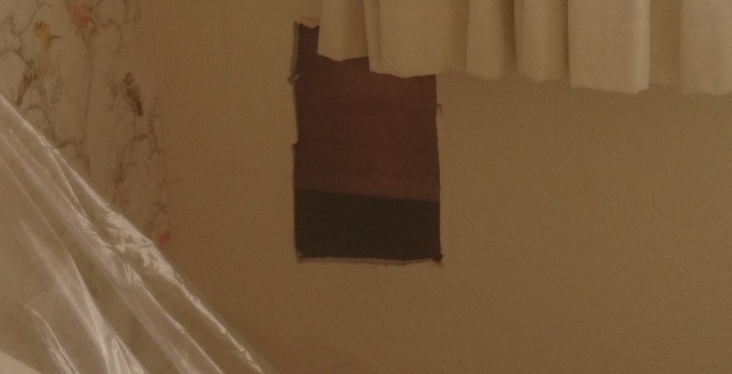

I decided it was time to cut a hole in the wall and examine it from the inside to see if I could find a damp trail, so I cut an inspection hole into the plasterboard:
MTM Original
MTM Original
Once cut through the apparently damp board I was surprised to find no damp at all through the board or on the back! Hmmm :?
Looking into the void the insulation is all dry and I could not see or smell any signs of damp! :)
MTM Original
MTM Original

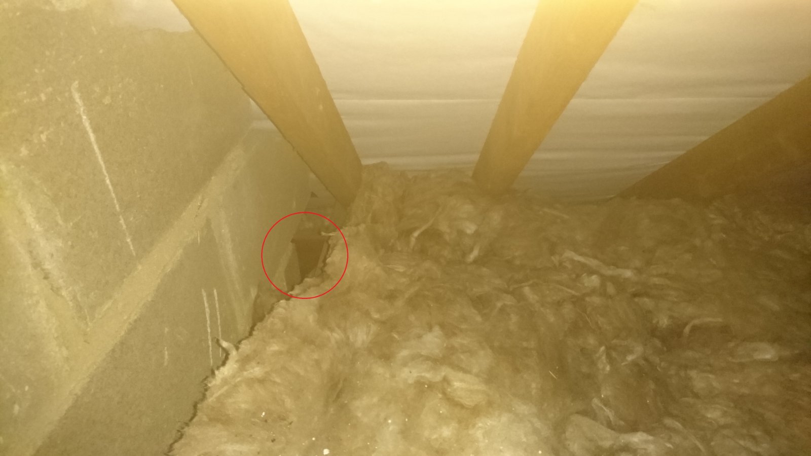

However there was a constant cool breeze coming out of the void, convincing me that air was definitely coming into the void from outside. You can see the gap circled in the picture above which is a clear opening into next door's void. I could feel air coming into my face as I put it close to the hole, but I felt it coming from the right as well. I went out into the garden and examined all the joints between the dormer, the wall, the soffit and the window frame and there are cracks here and there. So I have formulated a plan for tomorrow:
I have three rolls of spare loft insulation left over from the re-insulation of the loft (we now have 18" throughout!) and about 5 cartridges of external sealant and two cartridges of No More Nails in stock as well as various timbers. I honestly believe that the drywall being exactly that, then the damp issue may well have been condensation all the time. My theory is that the draught in cold weather was making that particular piece of uninsulated plasterboard a cold spot within the wall and hence causing overnight breathing to condense there being much colder than the rest of the wall which runs behind the radiator.
My plan is to do my best to eliminate the draught by sealing the outside cracks around the soffits, blocking the gap to next door with a waterproof membrane covered timber and then once satisfied that the draught is gone I will stuff as much of the void as I can reach with the loft insulation before installing a new piece of plasterboard, patching the woodchip and painting. Fortunately the entire repair will end up behind the bedside cabinet when completed so a perfect matched finish isn't essential!! :-D

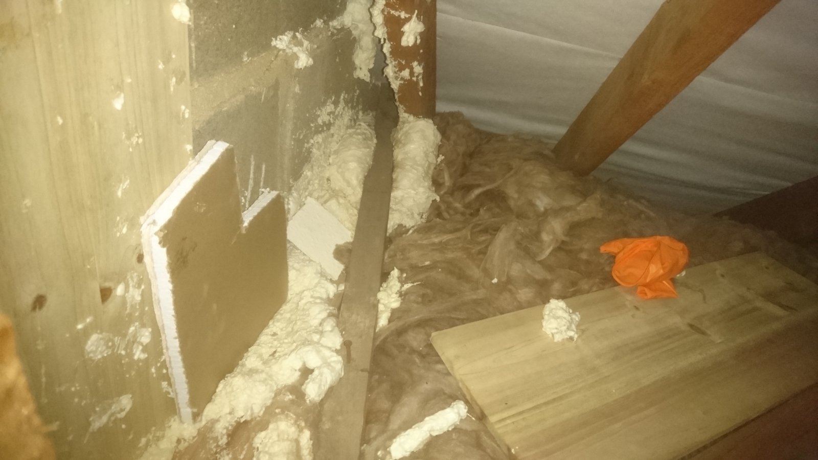

Picking up from where I left off yesterday I got stuck in to repairing the holes today. Firstly I boarded up the gap through to the neighbour's void and then filled all the small crevices around with expanding foam:
MTM Original
MTM Original

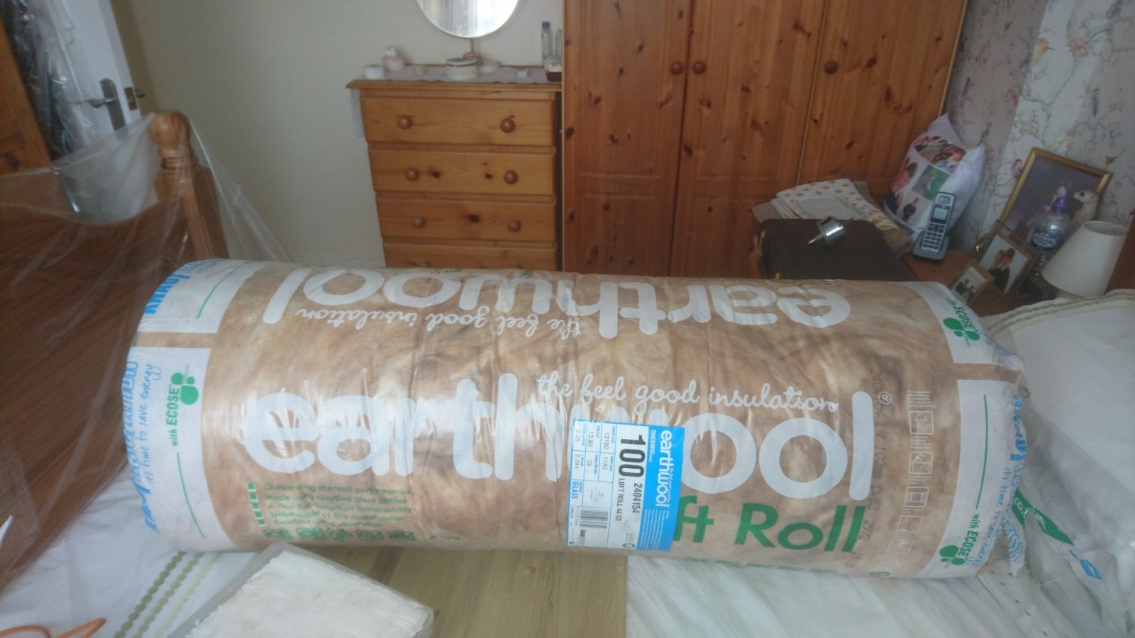

While that was setting I went up in the loft to get the insulation rolls we had left over, 3 like this:
MTM Original
MTM Original
I only brought one down to begin with as the void is not that big and it sure expands when you unroll it!!

Having put them on I got to work unrolling, and installing the insulation to completely fill the void:
MTM Original
MTM Original

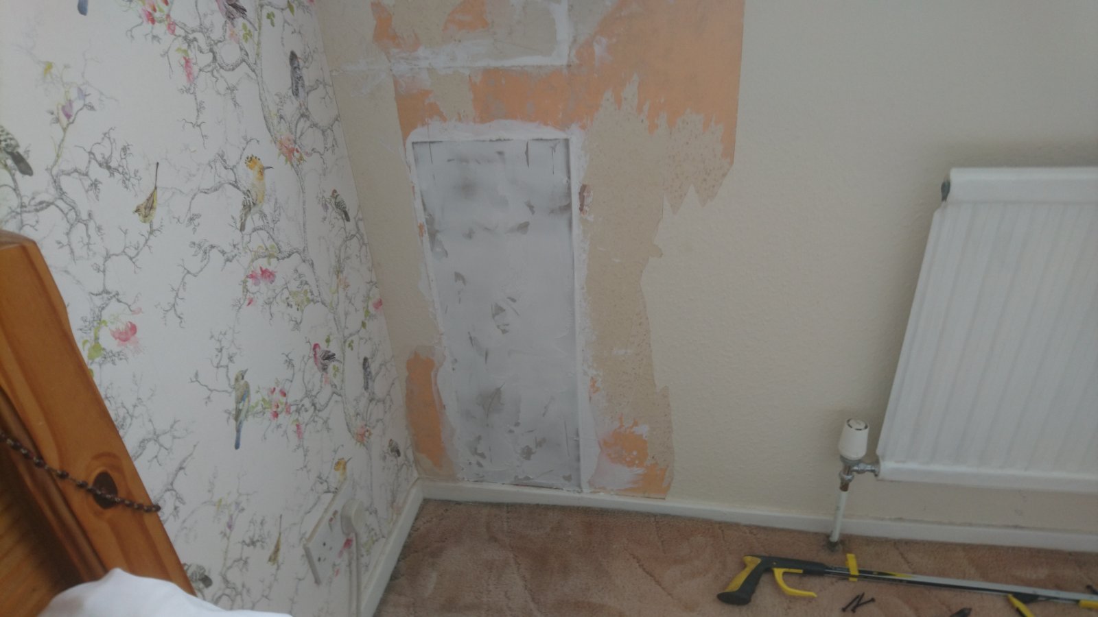

Having filled around the plasterboard I had to leave that to set before I can paper and paint it to finish the job.

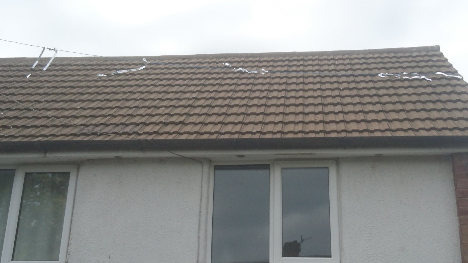

Time to turn my attention to the bird scarer. My initial plan had been to hang lengths of the tape from the line down to the gutter but my first trial showed that to be ineffective so I have now put double tapes every metre or so along the line and hoisted it into place:
MTM Original
MTM Original
Initial results are promising, I aimed a spare motion detector, which does detect pigeon sized birds, at the roof and it has not sounded yet! Fingers crossed and see how it goes before I get the ladder up to make it all a more permanent installation!! :-D

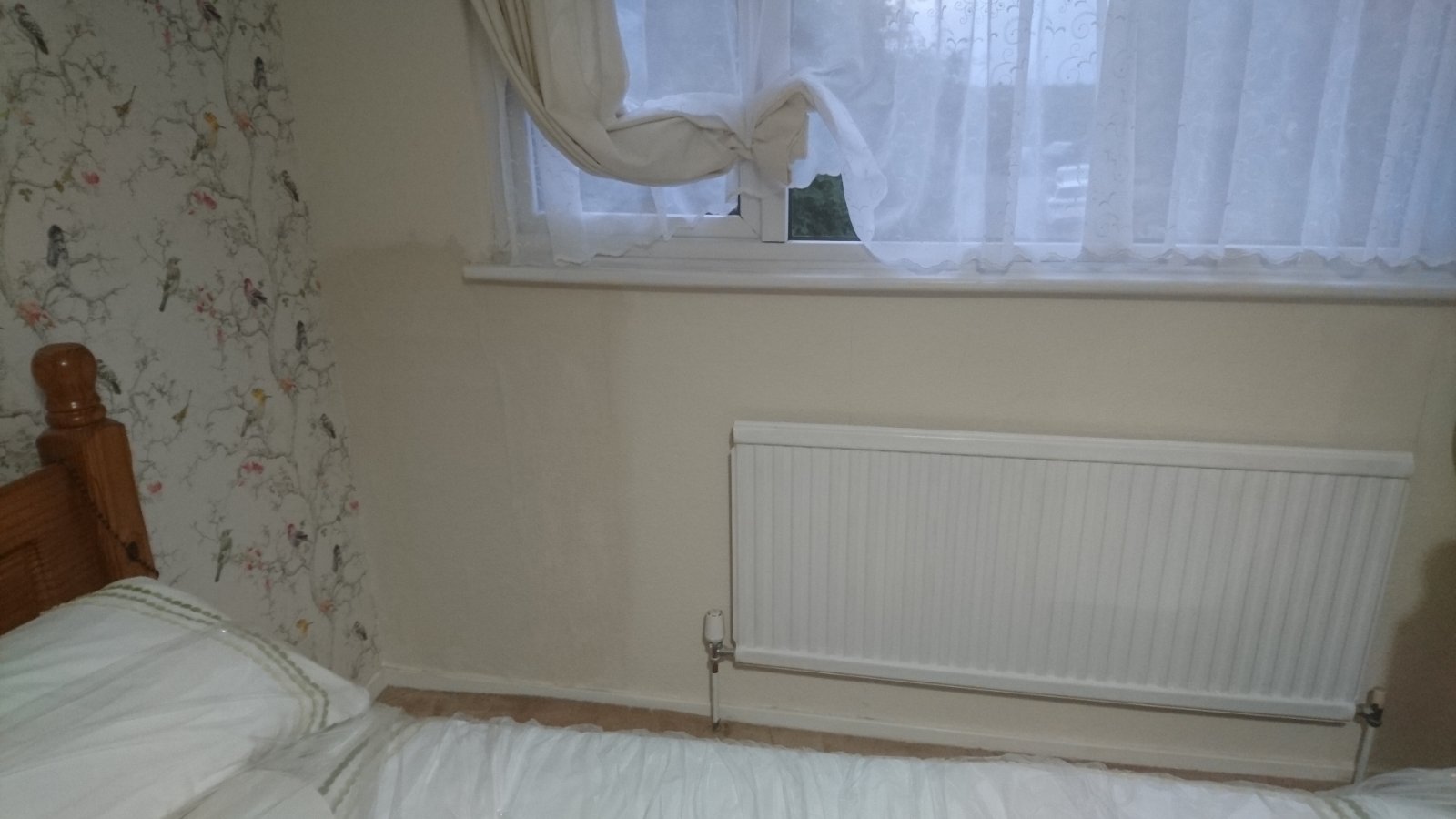

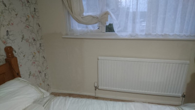

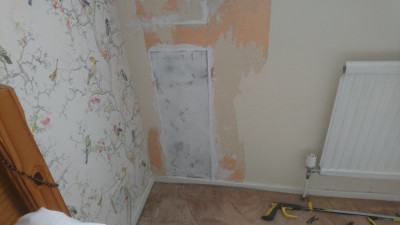

Well the repair dried in time for me to get it papered and painted so the job is done!! The paint is still wet in the picture but my test blob earlier in the day just above the right end of the radiator has dried and blended a treat so I'm sure by tomorrow you'll never know I've been there :-D
MTM Original
MTM Original

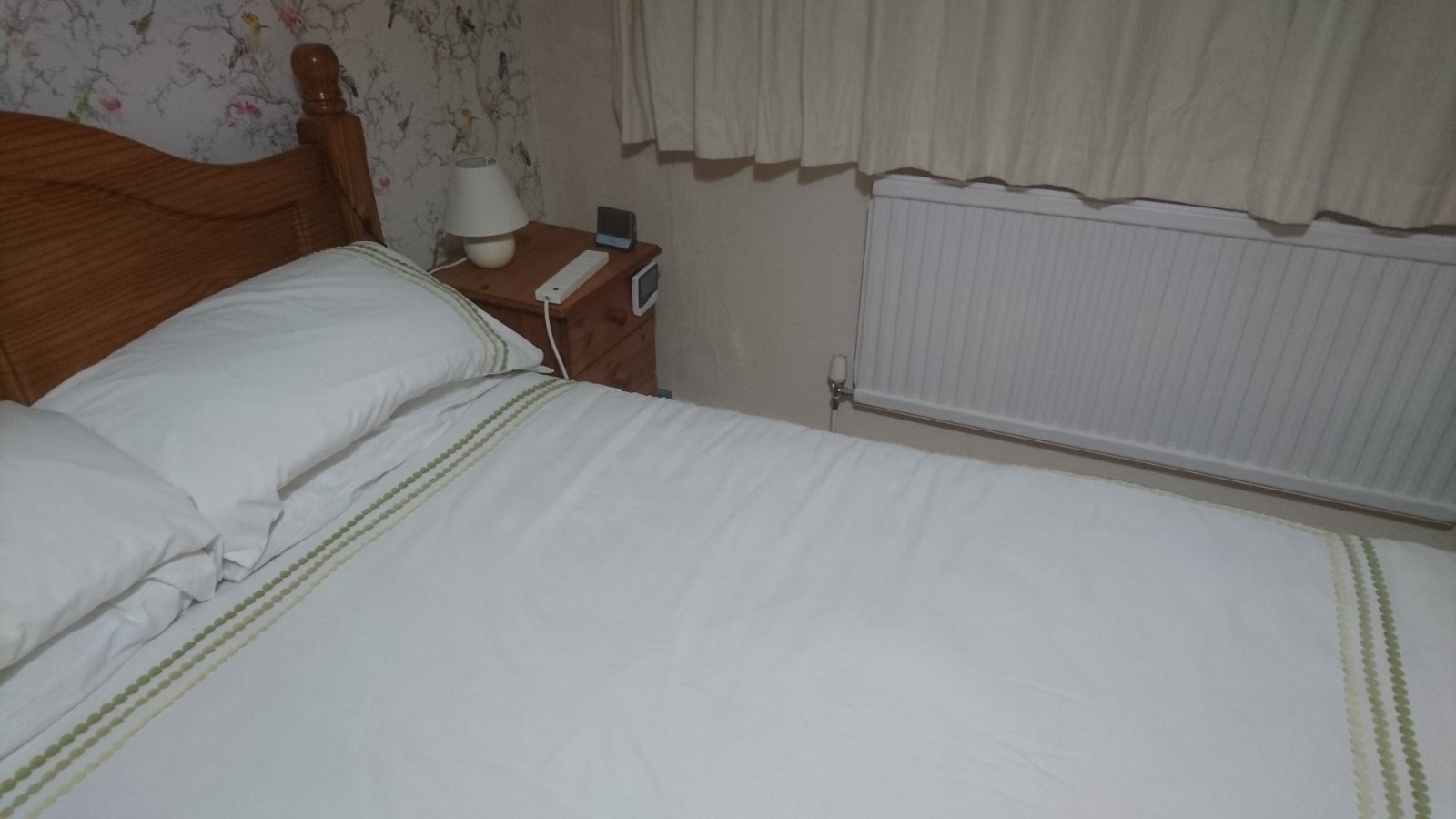

and with everything returned to normal before she gets home, job's a goodun!! :-D

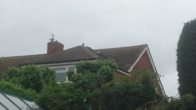

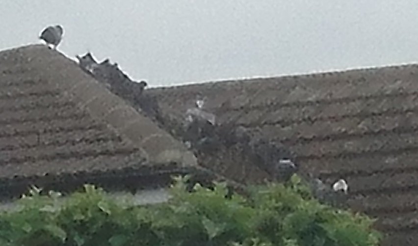

Well I am pleased to report that there were no pigeons at all on the roof at bird feeding time this morning!! :-D There used to be a fair flock of 30+ so I am very pleased with that project and the hassle was well worth while!! :bd: :bd: :bd:
However I am not sure our neighbour at the back of our garden will be impressed! They have moved in there!!:
