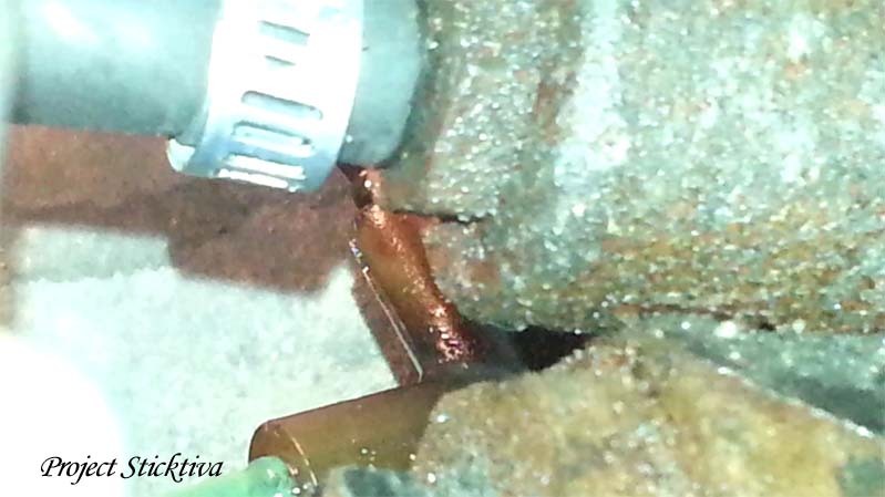

Well I got some lighting in, a couple of tools to move some wires and this is what I see....
Sitting behind the valve is this 4 way connector

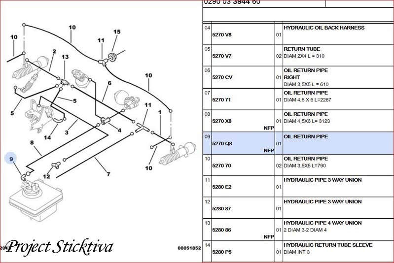

With a Split in the top arm/socket of the connector itself No 13 below, more of a crack really as it looks hard, brittle and old by its brown colour.
Part No 13.....NFP !....so WTFH do I do now (? a link to a seller maybe)....any reason I cannot use a PAIR of Y connectors then feed these to a single Y connector ?

Re: shortly to become an Activa owner...Project Stictiva
They do seem to be failing quite often now Sticky and finding a replacement is getting a bit tricky as it's pretty much unique...
One must start to think of an alternative way of coupling the four pipes in question...
I've wondered about a lump of soft (but LHM resistant) plastic suitably drilled to take the pipes roughly in the style of the original... It's a case of finding some suitable material as not everything is adequately LHM resistant. Some stuff rapidly goes hard and other stuff rots very quickly.

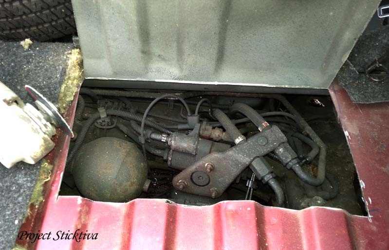

HELLO BOYS !......come out and PLAY !
Now tell me that is not the MOST RIDICULOUS placement of a Plastic Push-Fit oil pipe 4 way Union
Watch the Customs and Excise faces light up when they see that concealment compartment you've made
They'll never believe you when you tell them what's in there

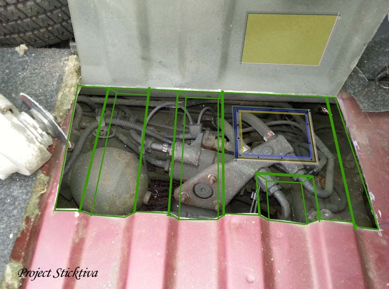

Plan No.A
Blue is the plate from the scrapper floor, yellow is the hole in the V6Activa floor....too big ?
Plan No.B
Gosh
That's made life so much easier.. If you need to get the ram pipes off it's a heck of a job normally but from there it's a doddle..
You need to make a template available to all us Activa owners now so we know exactly where to cut...
What did you use to make the cuts?
look left
Template No.B looks better to me than the larger No.A.......Input on this Guys please
Northern_Mike
I like the larger one. It's not that much bigger and might save skinned knuckles.
The right-hand 2/3rds of A for me as it gives useful access to the electrovalve too...
