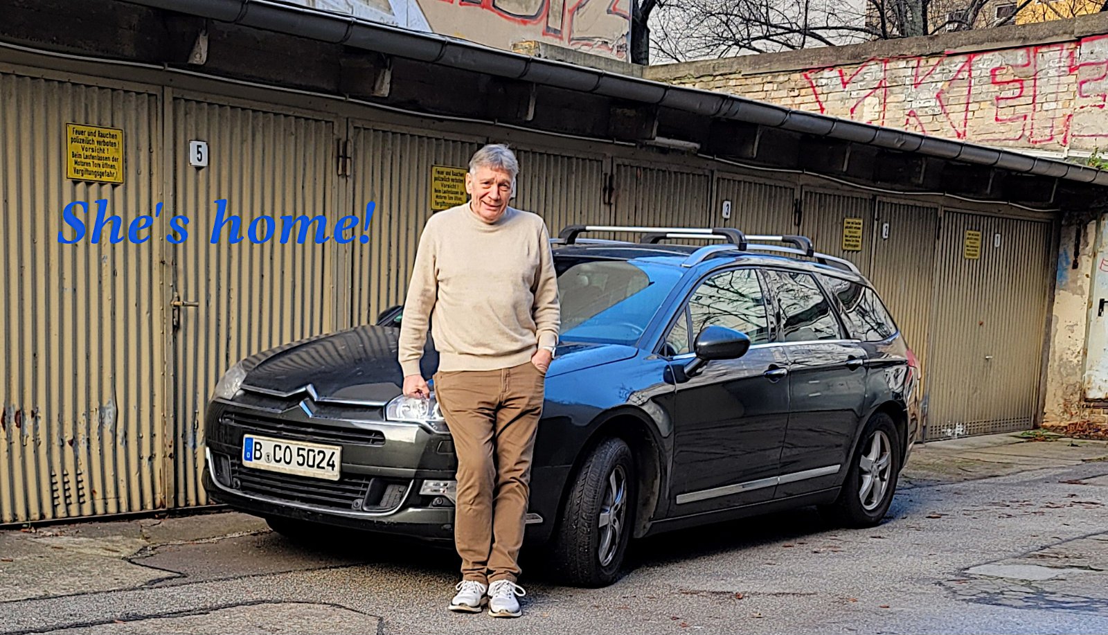

Just picked her up this morning.
The rebuilt AL4 runs smooth as honey and the suspension is how I know it: wonderful.
Thanks for the help and Merry Christmas!

Nice picture of you and the car, but a little comment, it seems to me the car stand around little to high, it should be 73 cm as i say before, but now you can adjust it with the diagbox.
