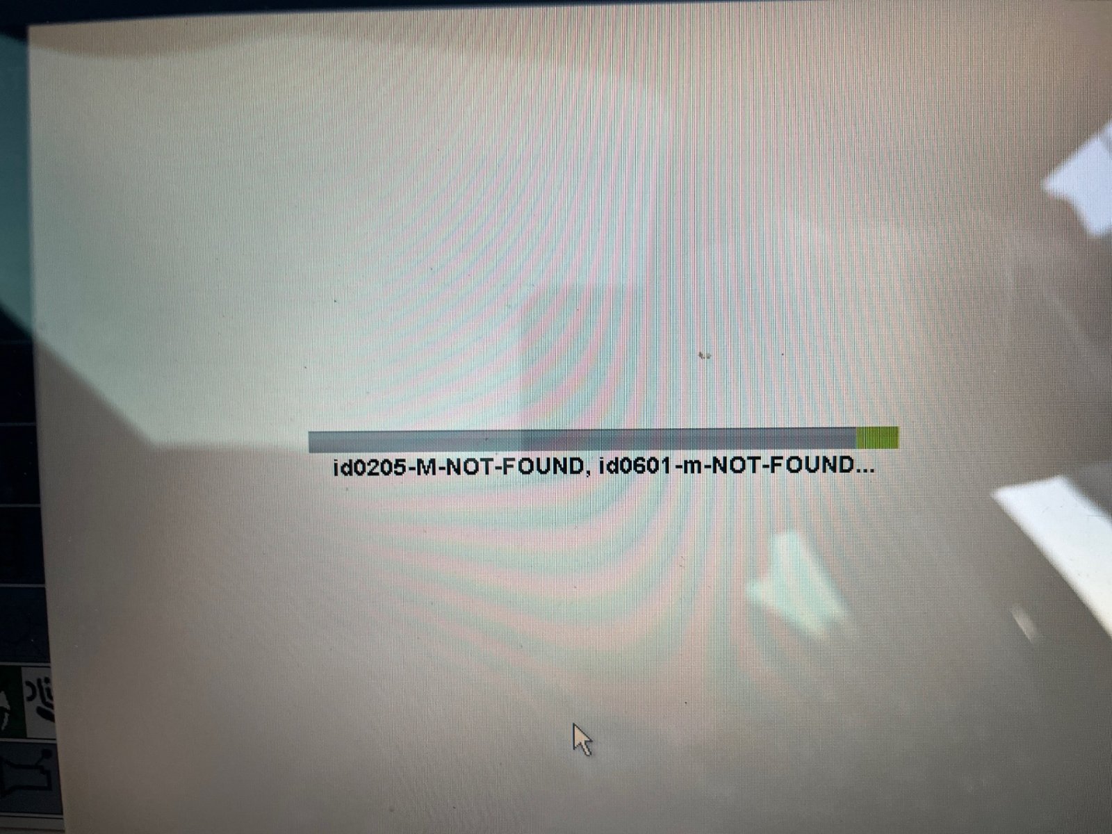

Hi Mick no its yours. I have just tried it on the other car and its doing the same thing, loads up OK then eventually when you try to find a section to analyse
it comes up with a lot of random numbers ending up with 'ID 2072 not found' or '205m not found. I am completely out of my depth here. I need an analogue one with valves.

Result still the same on Martins car. He has taken some pictures which I will send you if I can find them. Its the same on all three cars and mine has a new battery.

That certainly looks like a problem with the interface hardware as it happens across 3 cars. An outside chance that it is a plug problem in the line but I fear it will be a software issue. It might be worth sending those pictures to Jim at Easydiagnostics and ask if he has any idea what might be wrong. The kit was bought from him originally.
