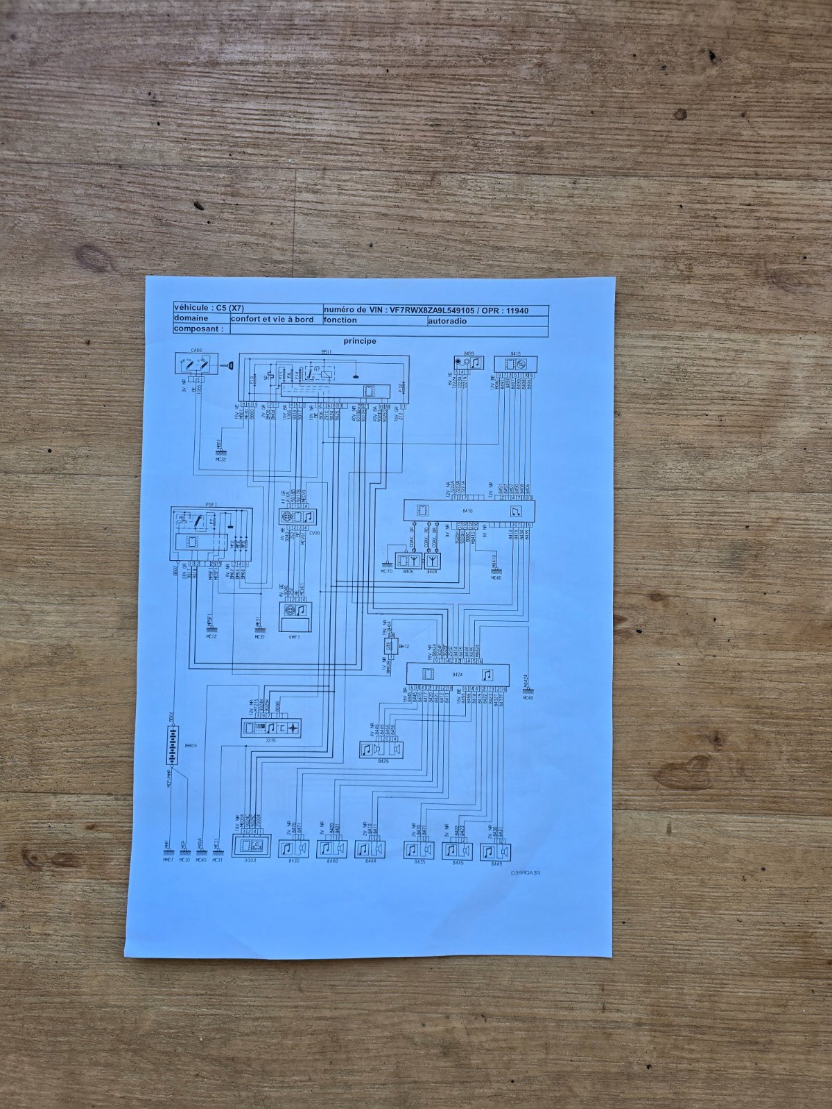

Here you are, the wire diagram for a unit with amplifier.

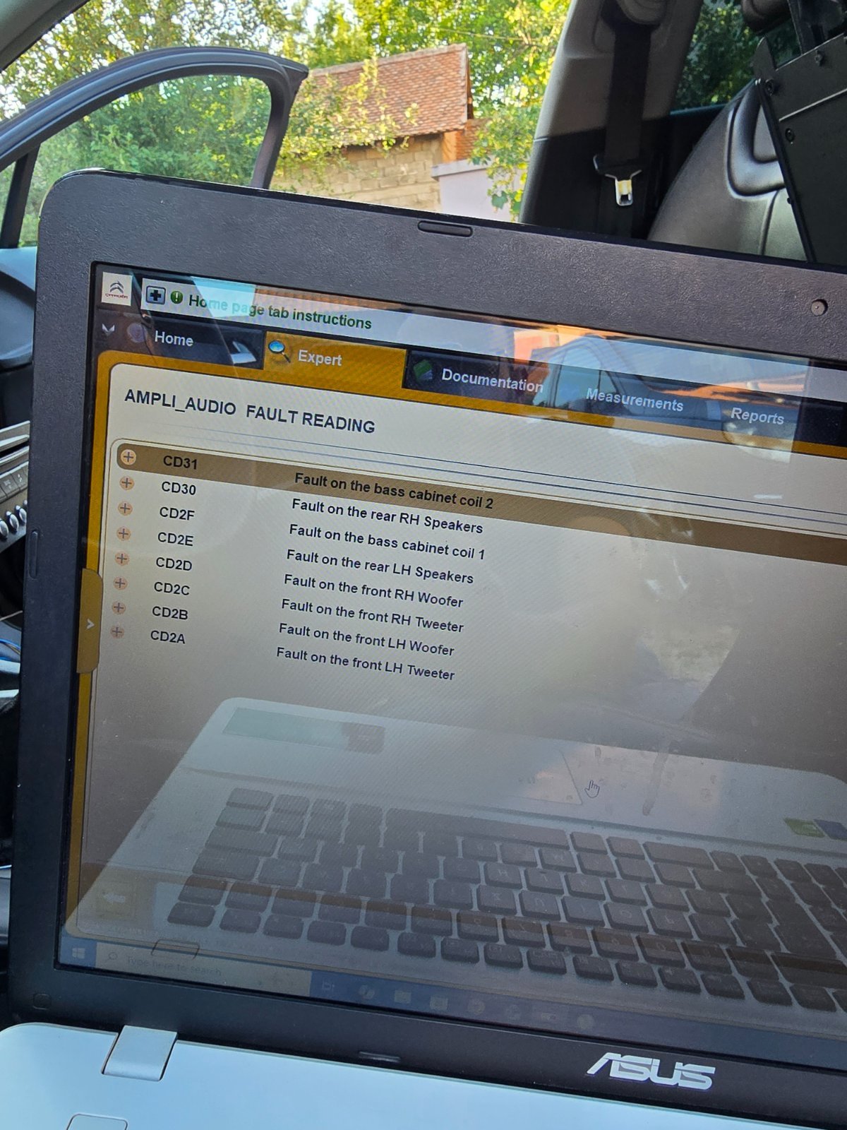

You have to adjust some parameters with the diagbox, for example put multiplex on.

Thanks, I already got the diagram ready. Tomorrow I'm going to a local scrapyard to pick up everything.Kees wrote: 10 Jul 2025, 10:50 Here you are, the wire diagram for a unit with amplifier.
Although at the moment I've got a Chinese Android 9-inch head unit, I might just switch back to the RD45 for testing purposes.
After that, I will order a 7-inch Android unit that will fit the original mask for the display; it looks much cleaner.
For real, I wouldn't like to lose all the Android features like Bluetooth music streaming and iGO navigation. I really like the NG4 unit, but I installed a cup holder under the original radio I had. So, I guess I would miss it too, plus I don't think that even the NG4 has Bluetooth music streaming.

Re: Citroen c5 X7 Xenon headlight retrofit on steel sunspension
It's correct, that the NG4 has no bleutooth streaming.
I understand, that you have a android system now, and want to use a amplifier.
There are several post over here, that with this combination not all the speakers working, this is because of the multiplex system, so maybe it's better to connect all of the speaker wires comes from the radio, and connect them with the amplifier.

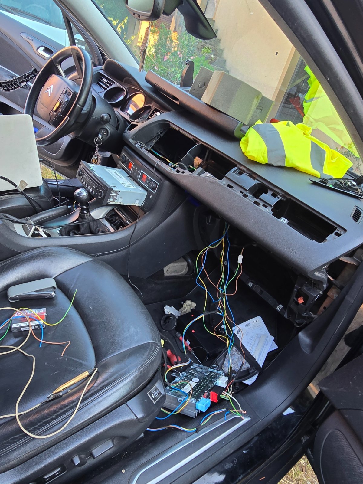

Got the amplifier and speaker's today, but didn't have much time since I had to go to work in one hour I got amplifier connected to the car (acc wire) and communication, tomorrow i will have to relocate all the speaker wires from radio to the amplifier output.
Pretty much an easy install.

Just a update on a HiFi system retrofit, i don't have much pictures atm,
All the outputs from quad connector need to be cut off, then use front left and right output and connect it to input on the amifier. After that all the outputs from the amplifier need to be connected to original outputs plus 2 wires for front left and 2 wires for right tweeter ( they are going as stand-alone with amplifier. 4 wires for rear sub. Reconfigured radio to amplifier using diagbox. Everything is worming pretty nice and sounds really god, since I had 9 inch android I downgraded to rd4 and ordered another android but 7 inch from Ali that is suppose to work with HiFi system,plus it should look much more cleaner when finished because It looks almost like oem screen. I will be posting pictures when im finished. Next is the sunroof retrofit I'm already working on it.
