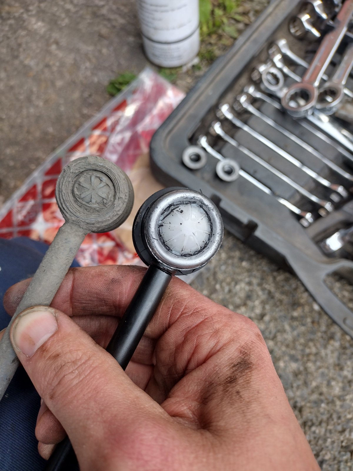

New drop links arrived yesterday, late afternoon it was raining . This morning it's still raining. However there is a size difference in not only lenght but the ball joint size aswell ! All be it not massively but enough to keep the whole thing away from head butting the lower wishbone arm.

Posts: 21060
x 8085
Re: Peugeot 207 1.6hdi (New edition to the fleet)
A comparison picture would be interesting Husky. :)

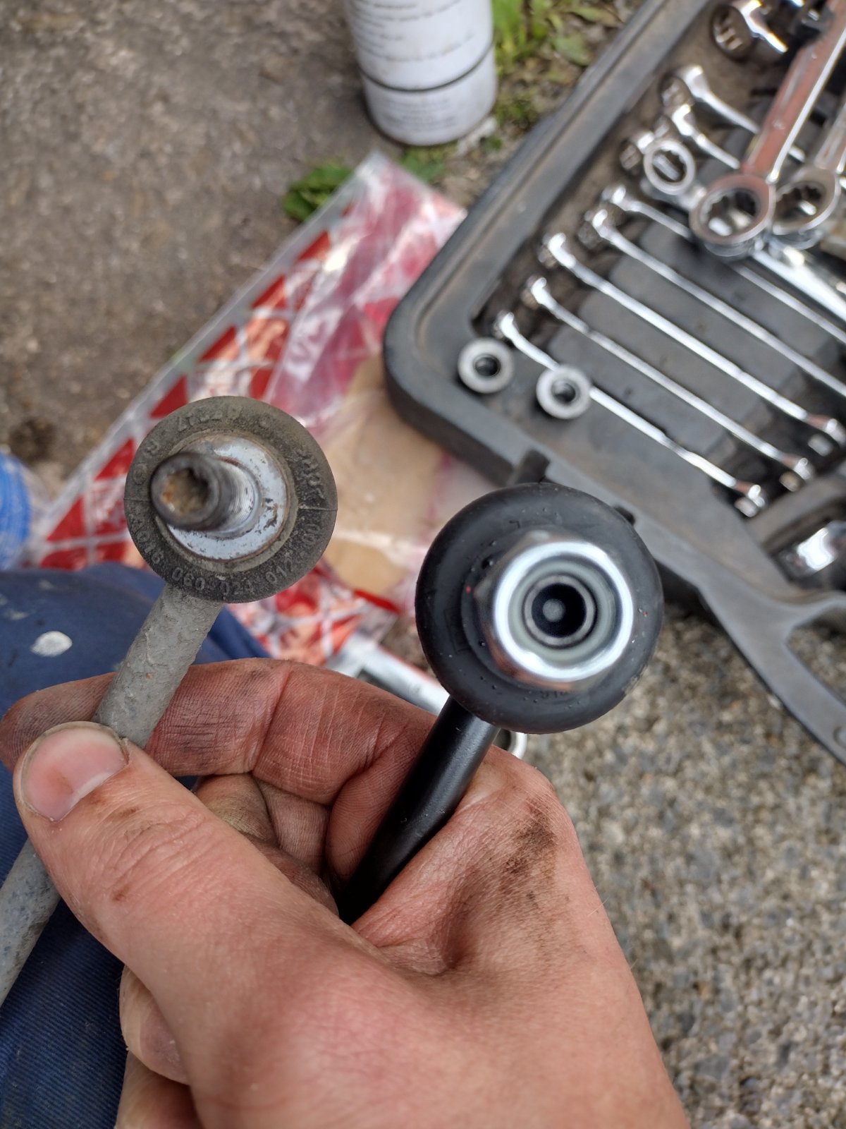

Unread post by MattBLancs »
On the topic of different sized ball joints, here's old and new as fitted to the Grey 308, a while back. Length etc all correct but a noticeable difference in ball joint size
