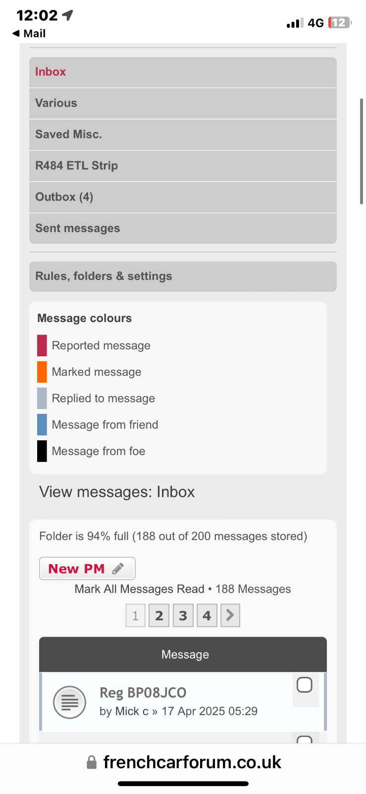

Nothing received.
Only one ever received and that was the reg hence when pumping that into mate’s system is came up with the two options split at the RPO.

Sorry but I only make fleeting visits to the forum and note that I still didn't receive an RPO number so I am going you have now scrapped the vehicle anyway.
Not sure if I explained at the time because I was fairly time poor when I was trying to assist but my mate's system specifically showed different information and diagrams at a particular RPO number which is why I needed that information to help you.
Never mind.
Never mind.
