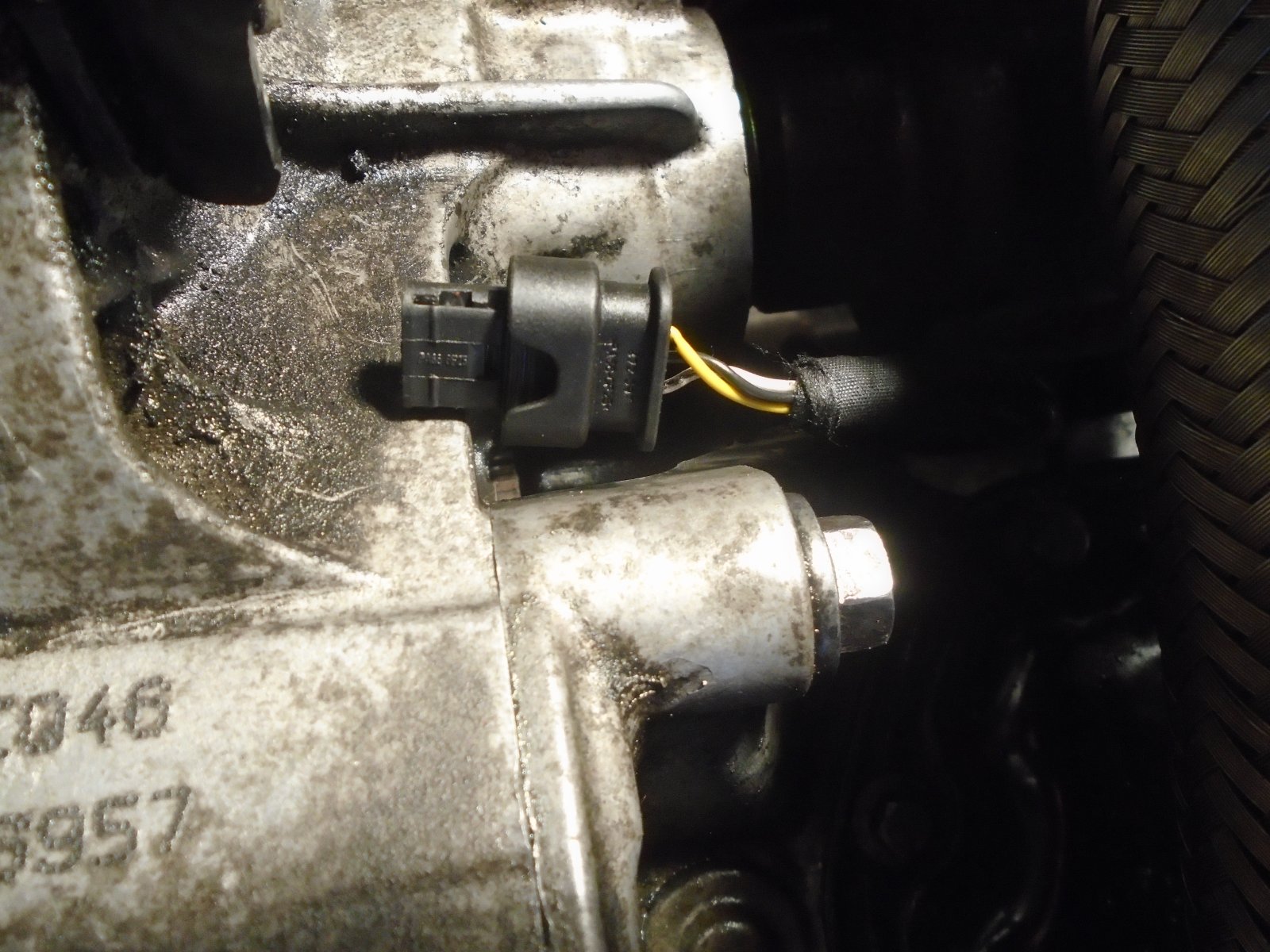

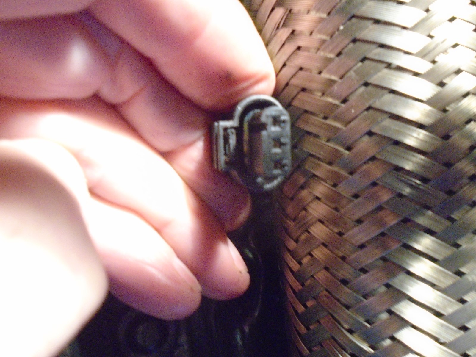

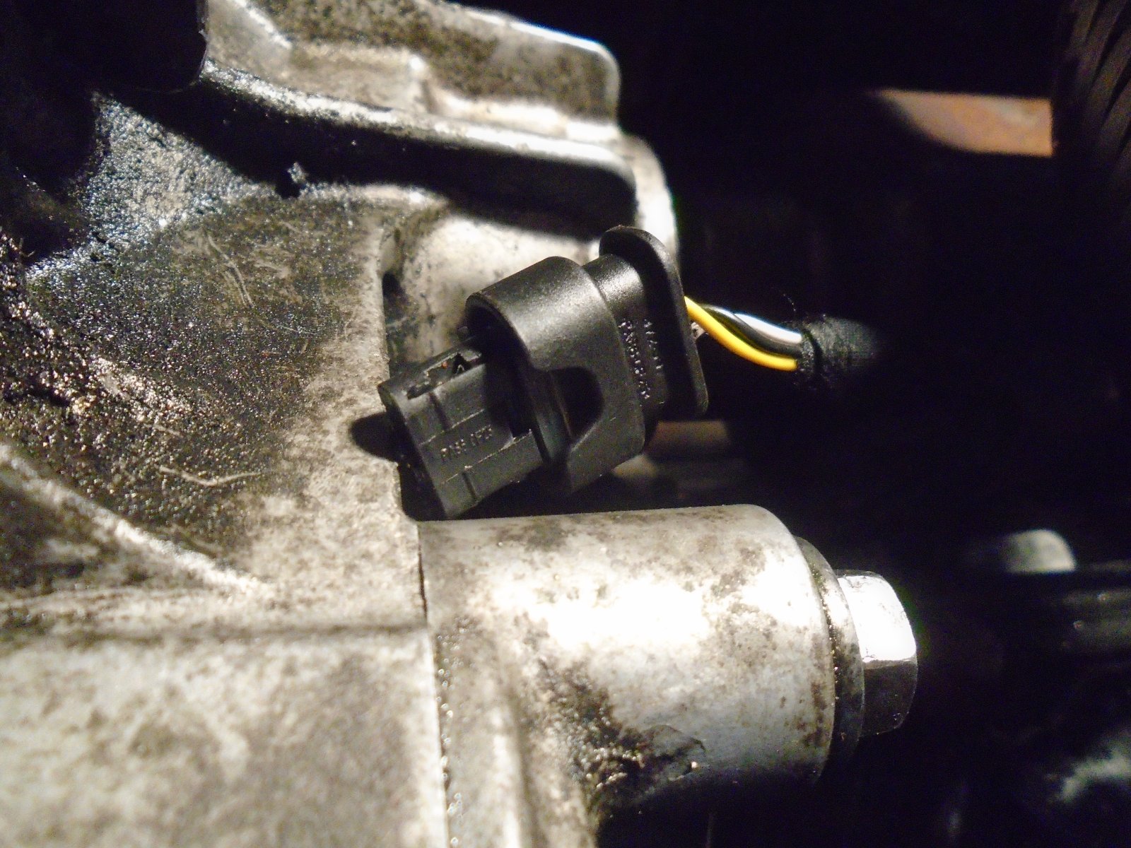

You got a picture of the connector?

The receiving end on the sensor is 15 x 10mm approx., so not very big.
https://www.ebay.co.uk/itm/224195089241?
https://www.ebay.co.uk/itm/315902940825
Found these, which look about right but can't make the part nos. line up.

Nos. on this connection are 672 597 PA68 CF26 (or similar, very small markings) and the marked BMW.
Can't find anything on Internet with these nos.
