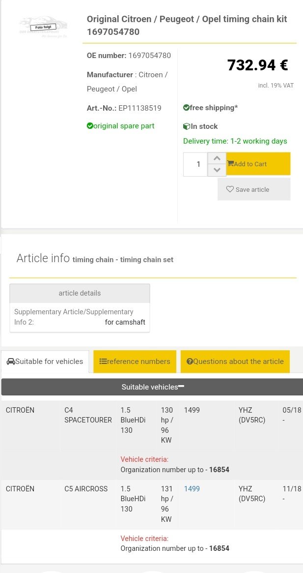

Re: C5 Aircross Timing Chain
Can you check 1638159880 I think they changed the OE number for the kit...
I'm planning on buying this timing chain kit, but I was not sure if it fits. Looking at the table below the price it looks like the engine code is correct.

Nego2403
- Posts: 122
- Joined: 10 May 2021, 11:54
- x 1
When I search for this number: 1697054780 on the internet I find that it is a timing chain cover kit, which includes the cover, cams and tensioner. Just wanted to make sure it fits before I order.
