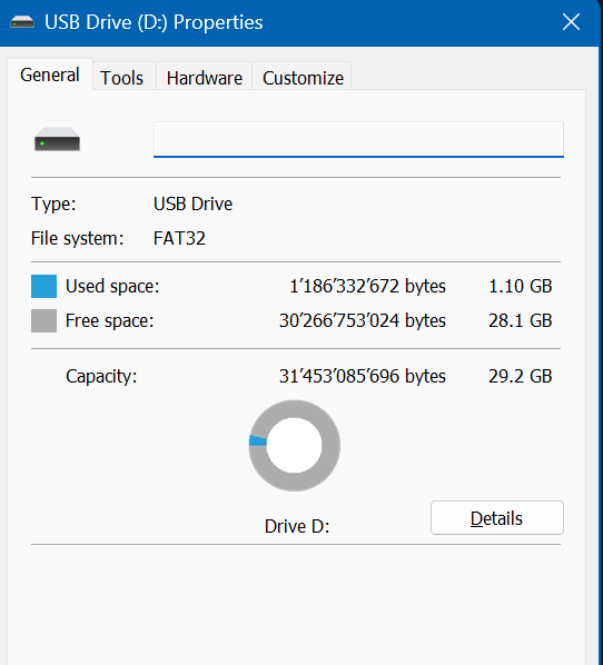

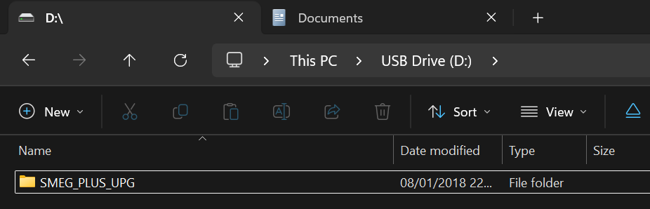

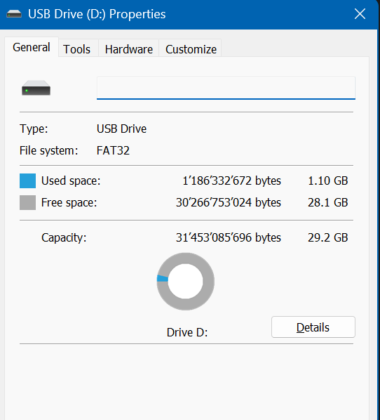

Re: C5 firmware
Sorry to be back with the issue, but I cannot trigger the firmware update. The maps update worked with the same USB drive.
Here's the USB drive contents and properties
- Posts: 9386
- x 1939
Re: C5 firmware
Instead of putting the folder SMEG_PLUS_UPG and its contents onto the root of the USB stick try putting the contents there.
Also, does your vehicle have two USB sockets? It's only the main one that will work if you have two.
