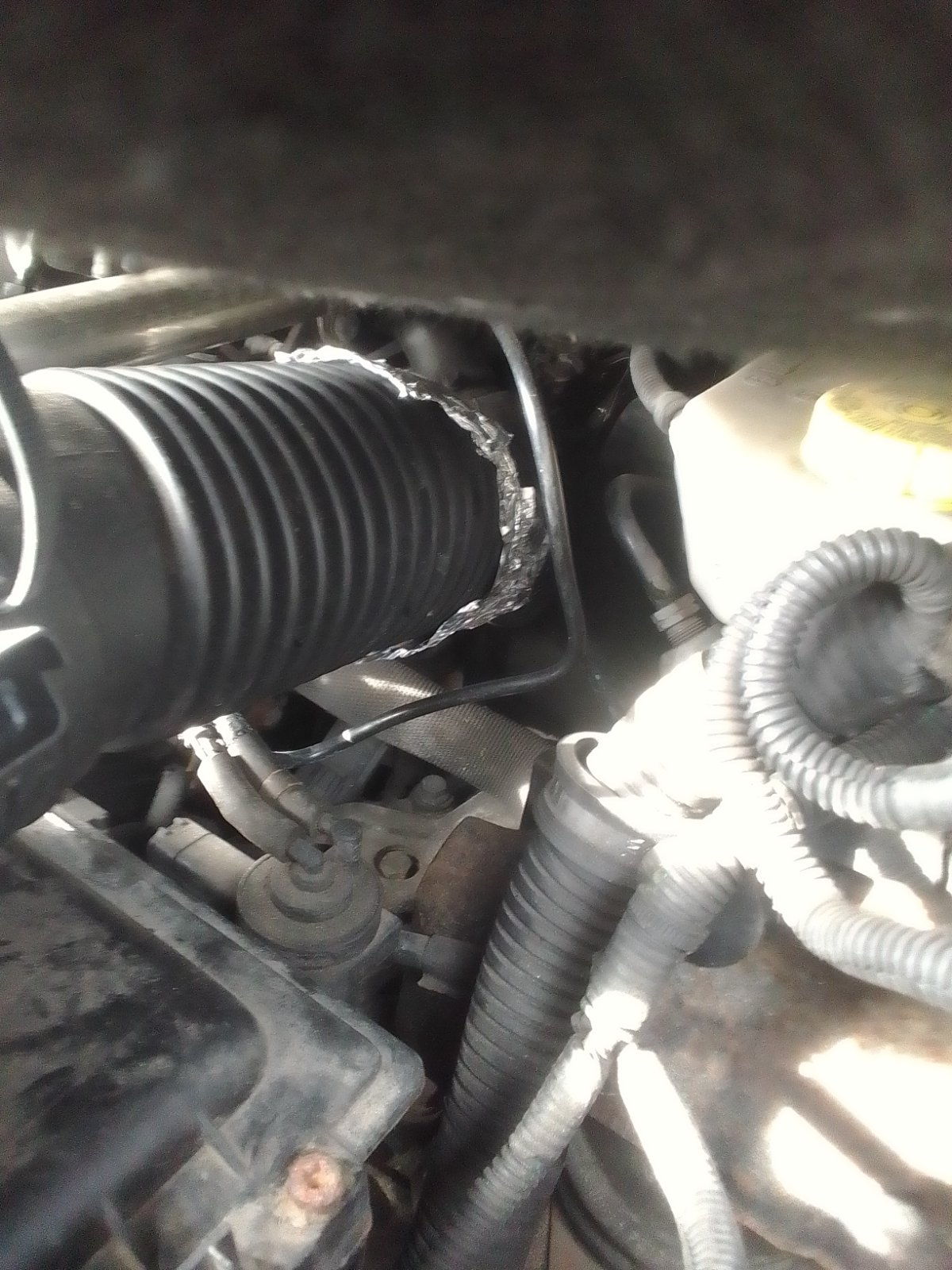

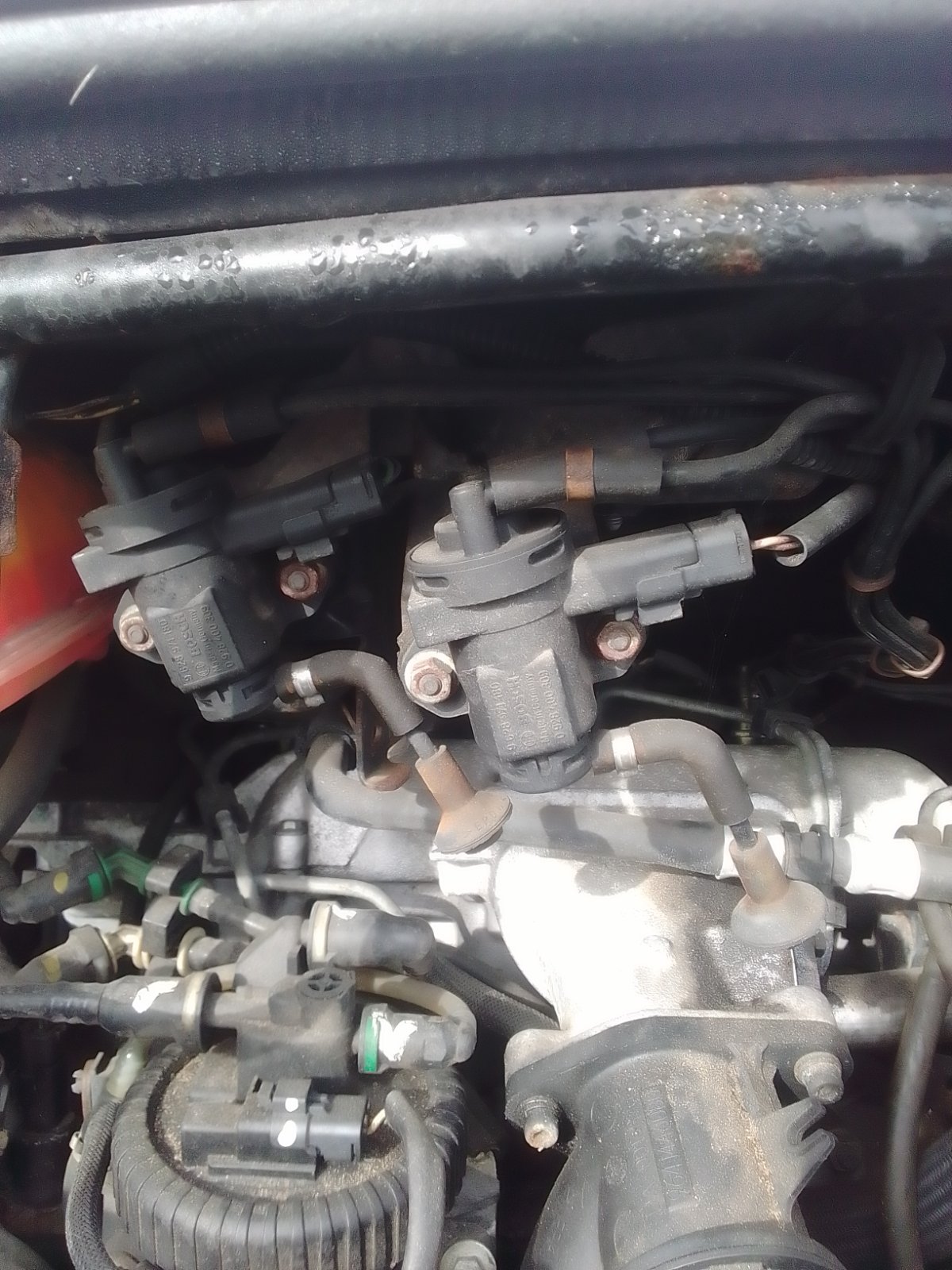

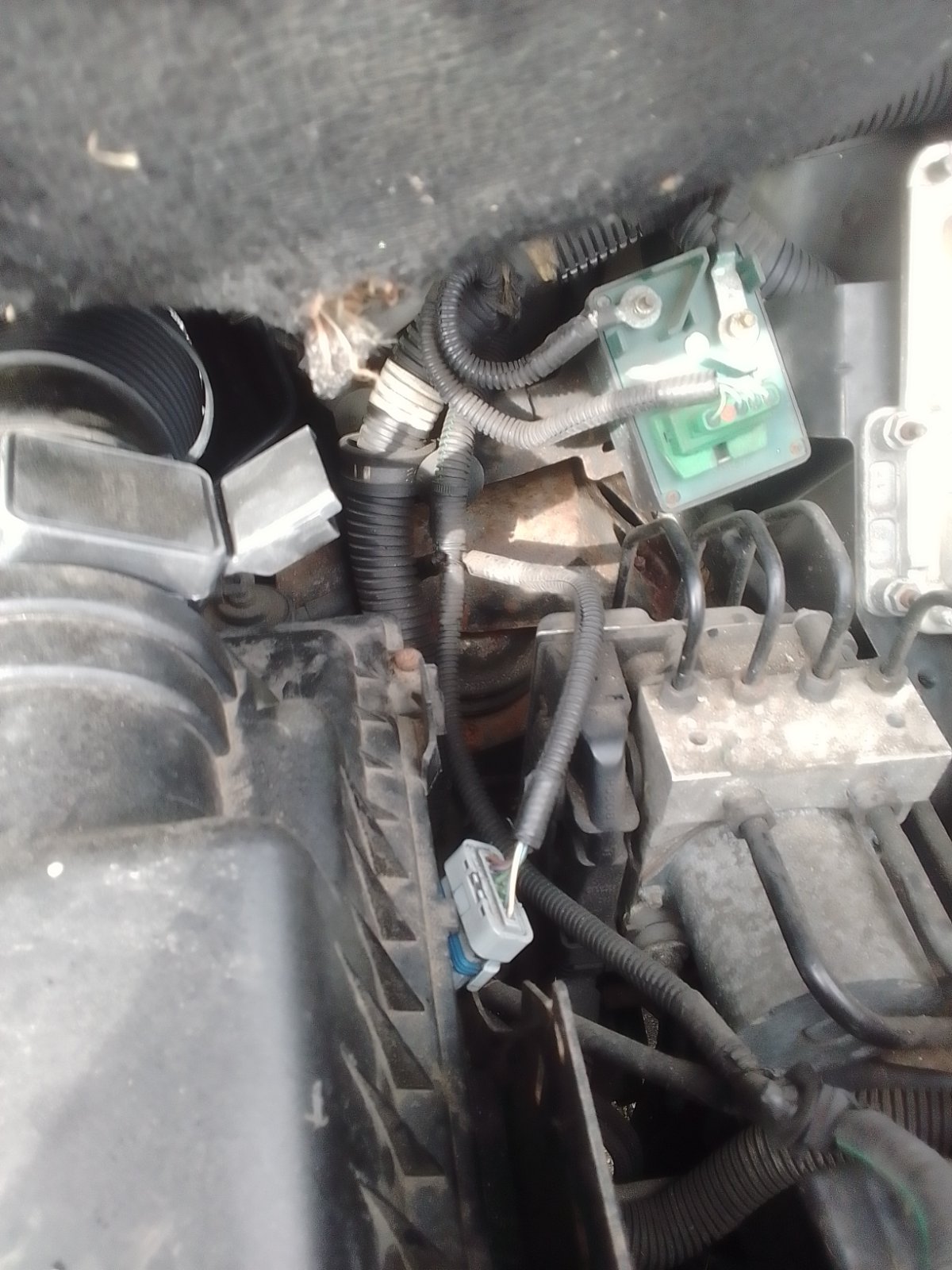

Just a few photos my unplugged MAF sensor, its staying that way! It seems to make no difference in mpg, it just puts you in limp mode when it fails, if it's not connected it can't fail. I haven't used Lexia to tell it that it's unplugged or deleted and works great. Next photo this is where my air pipes separated behind the MAF hidden at the back of the engine, silver tape to the rescue. While they were separated I did have issues of no acceleration uphill whilst stamping on the accelerator several times as if the car wasn't in gear but only happened in hot weather. Next photo I assuming these are the EVs your talking about, i find the left one will get warmer than the right but not by much. If one is alot hotter than the other then the filter might be blocked on it. Stick your finger on it and see if it sucks, if it doesn't that's an issue. If I think of anything else I'll let you know.

If the MAF is disconnected and the engine management light is on then surely it will fail the next MOT.

Nope, anything before and including '06 with an EML is a pass if everything else is up to standard. It's only after 06 that it's an instant failure. I've quizzed Marc lots on thisPaulC5 wrote: 03 Mar 2024, 15:49 If the MAF is disconnected and the engine management light is on then surely it will fail the next MOT.

Thanks for the pics.Rp0thejester wrote: 03 Mar 2024, 15:15 I assuming these are the EVs your talking about, i find the left one will get warmer than the right but not by much. If one is alot hotter than the other then the filter might be blocked on it. Stick your finger on it and see if it sucks, if it doesn't that's an issue.
The left one is EGR. It's hot as it's stuck on (even without filter). It was on the turbo (right) but was swapped as egr was getting disabled while I fault find.
The other 2 EVs are to the right of the airbox stacked vertically (the top one is visible in your second pic) and these were stuck on too so with both constantly pulling a vacuum my intercooler inlet was closed and heated inlet stuck open. They've been blanked at moment too.
