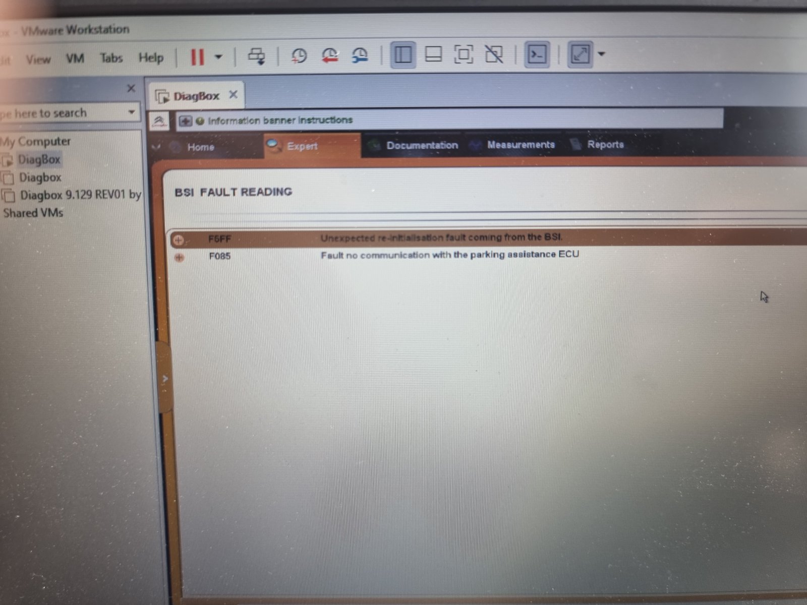

Any idears with these fault codes thanks

These faults mean that the BSI is not receiving data from the parking assistance ECU. The most likely causes:
ECU supply
CAN network
BSI
Parking assistance ECU
Electrical harness
It can also mean the parking assistance option is not correctly configured or missing from the BSI. So if anyone has been messing with settings without understanding what they mean - that can also be a cause.

I just brought a new ecu and other bits to try see if I can sort it cleared other faults in bsi today thanks
