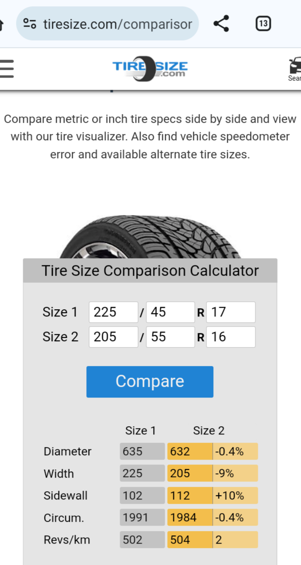

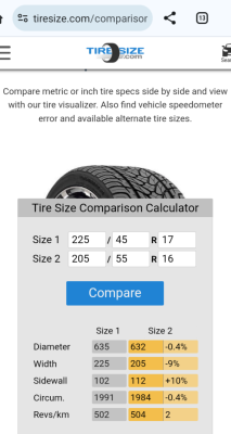

As an example
From website mentioned above
viewtopic.php?p=781482#p781482
I've swapped from 17" to 16" on the 308, and the new (narrower but taller sidewall) tyres are only 0.4% different in diameter, so no speedo issues.
Edited as miss remembered the new and old sizes! Now corrected
