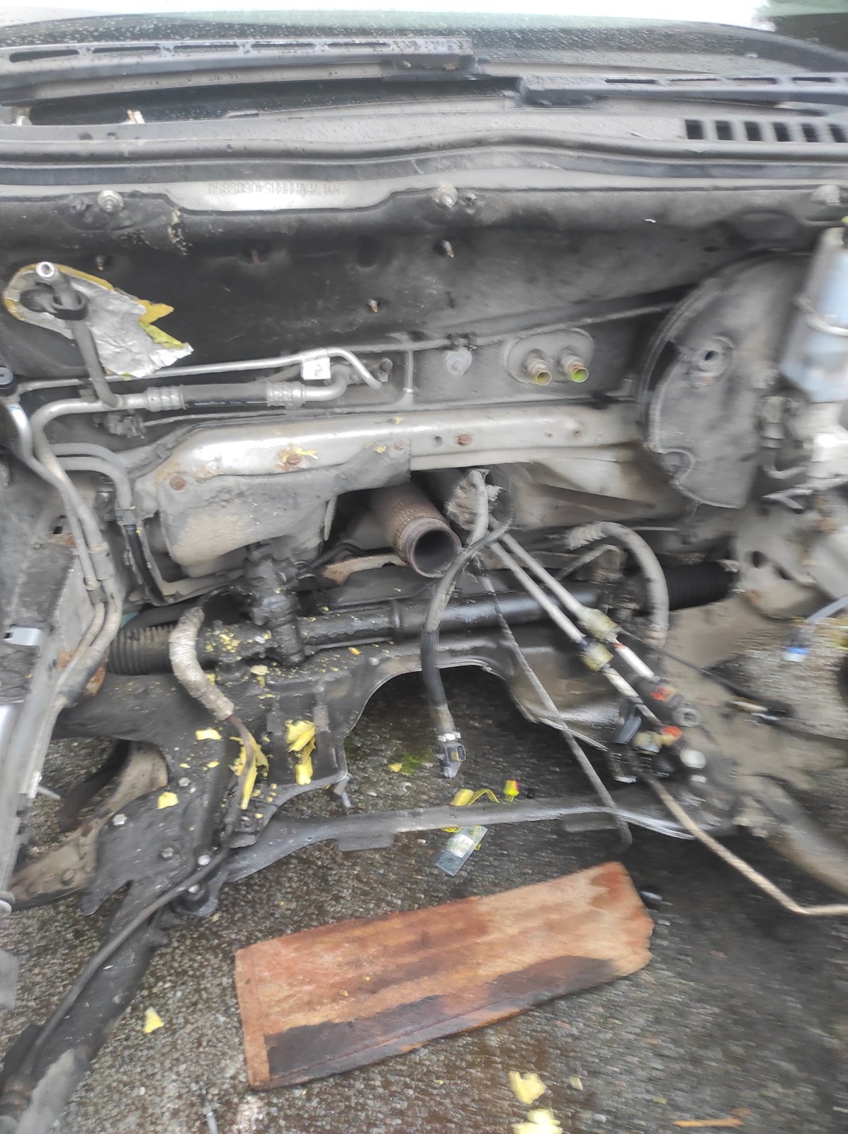

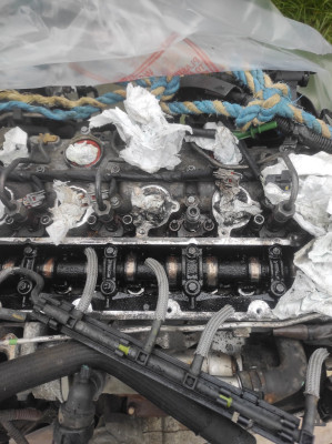

Re: Injectors misbehaving but trying to understand the numbers

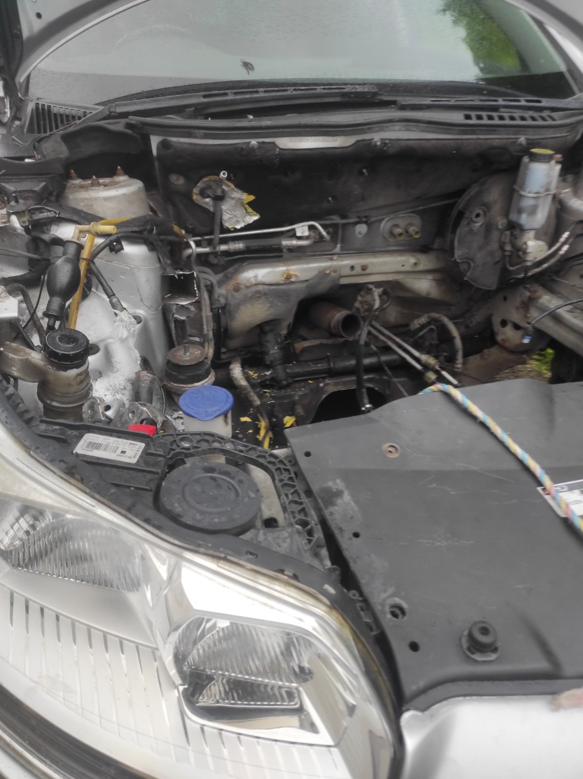

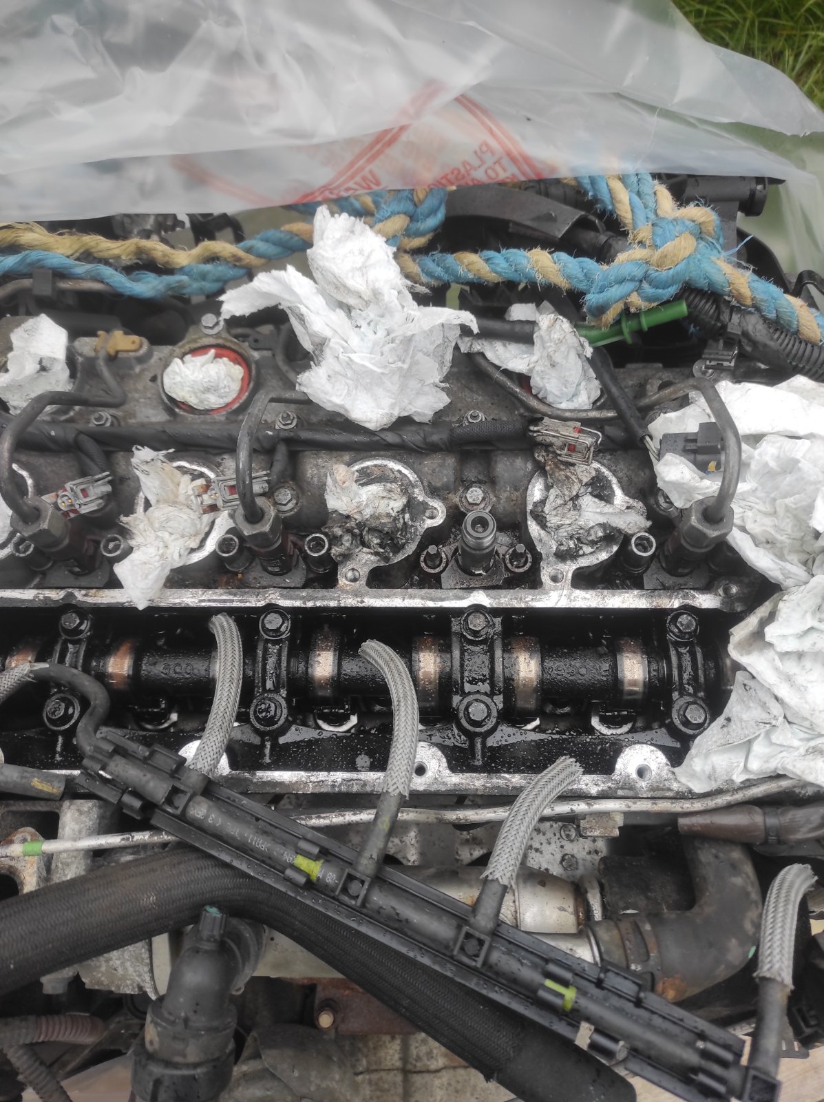

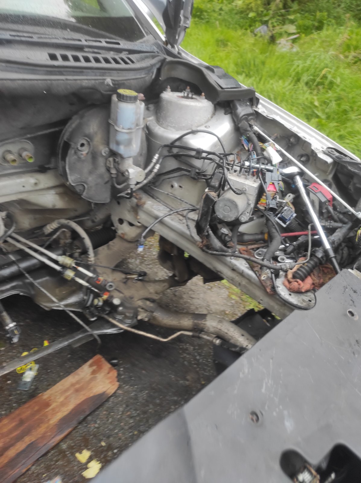

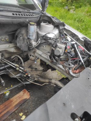

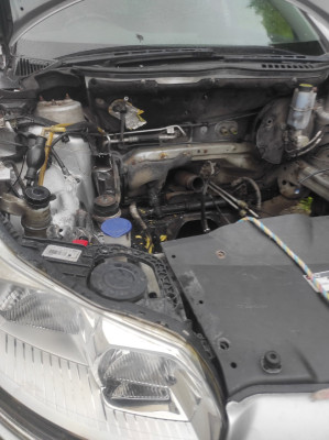

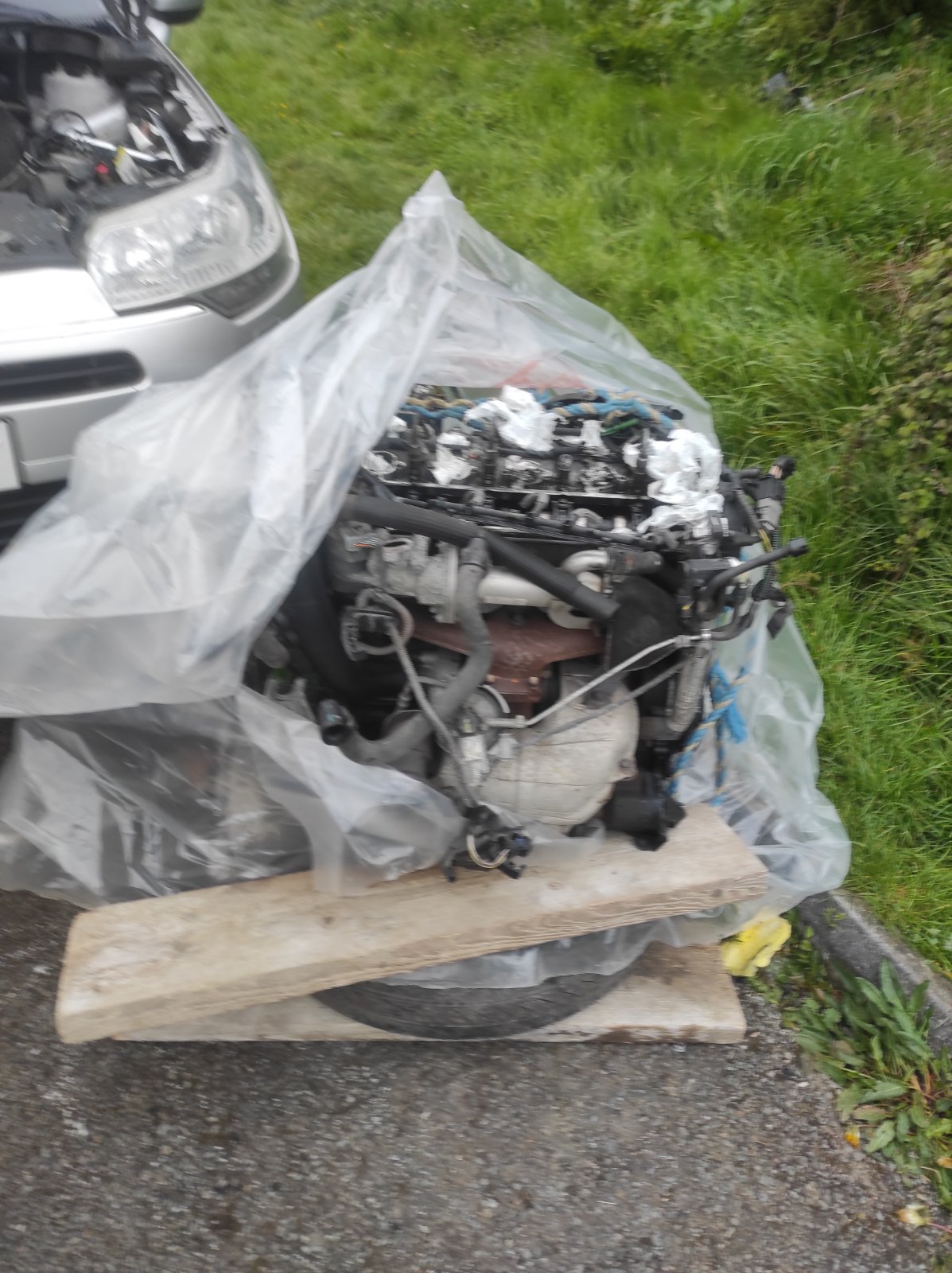

Hi lads, I pulled the engine out to get a better pull on the injector. I plan to do some other jobs such as the steering rack while I have it out. A few pics for you all. I need to make the puller stronger so I am going to get some of the fabricators in work to weld it up as strong as possible.
Darren
