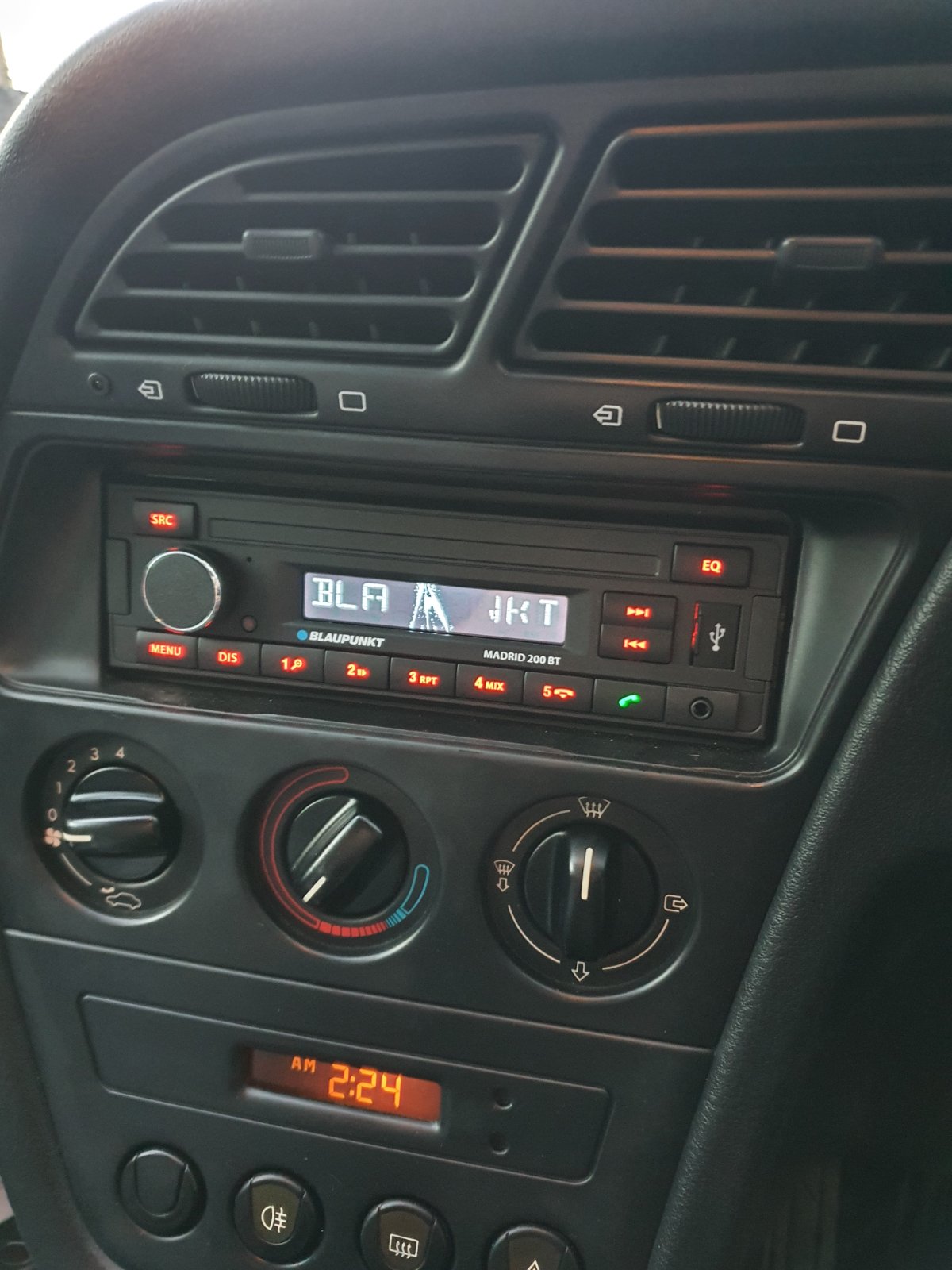

Been quite busy with work and other commitments over the last week or so, but that hasn't stopped me doing a couple of bits and ordering some odds and ends.

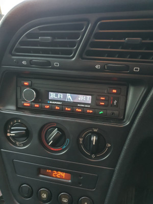

Finally got round to ordering a replacement head unit to oust the factory one which had a scrambled display, some buttons refused to work properly and it had an amplifier with the same music enhancing properties as a wet sand bag.
I was after something that looked sort of like it should be there, a retro looking stereo but with modern convenience. The main players at the cheaper end of the scale are Blaupunkt and Continental (although I'm sure the latter are probably made by someone like Bosch using the Continental brand). I opted for the Blaupunkt Madrid, which looks nice and simple, has nice big buttons and they obviously spent their time and money on making sure it looks good for a restorer of a modern classic as opposed to making the display do dancing rainbows of colour and other nonsense.
I bought my stereo and the associated fitting kit (fascia adapting panel, DIN aerial adapter and plug adapter) from Dynamic Sounds on Ebay.
Of course with it being me fitting the parts, things didn't go 100% smoothly but at least I now have music. I managed to break the LCD screen on my brand new radio before even using it! This was from a very gentle press on the surrounding parts of the radio to help mount it (I would never push the screen itself) and this has let the build quality down of the Blaupunkt unit somewhat. I know it was definitely me who broke it as I tested the unit before mounting it using the wires straight out of the dash and it was fine. Oh well!

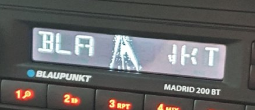

new stereo, buggered screen. So I'm not much better off compared to the screen on my original factory stereo which displayed nonsense because it was also knackered.
The fascia adapter fits okay once I worked out how to properly mount it with the cage - car audio is not my area of expertise at all!
The only thing I might try and work out is how to get the steering column stalk working with the new head unit. There is a spare wiring loom that fitted in to the old stereo which I'm guessing has something to do with it, but that's a job for another time.

That stereo blends in nicely, what a shame about the screen. I'd have been fuming, so annoyed with myself if I'd done that!
I'd be tempted to remove the column stereo stalk if you can't get it working, I had an aftermarket stereo in a previous 306 (was a jazzy colours job) but lost count of the number of times I went for the column stalk, no response, realised, tutted to myself then reached out with the other hand...

I guess it's an attempt to display blaupunkt, looks very err, unwell to me, guessing it's a new screen required?

As it's a quality unit, I'm wondering if Blaupunkt might supply spares for it?

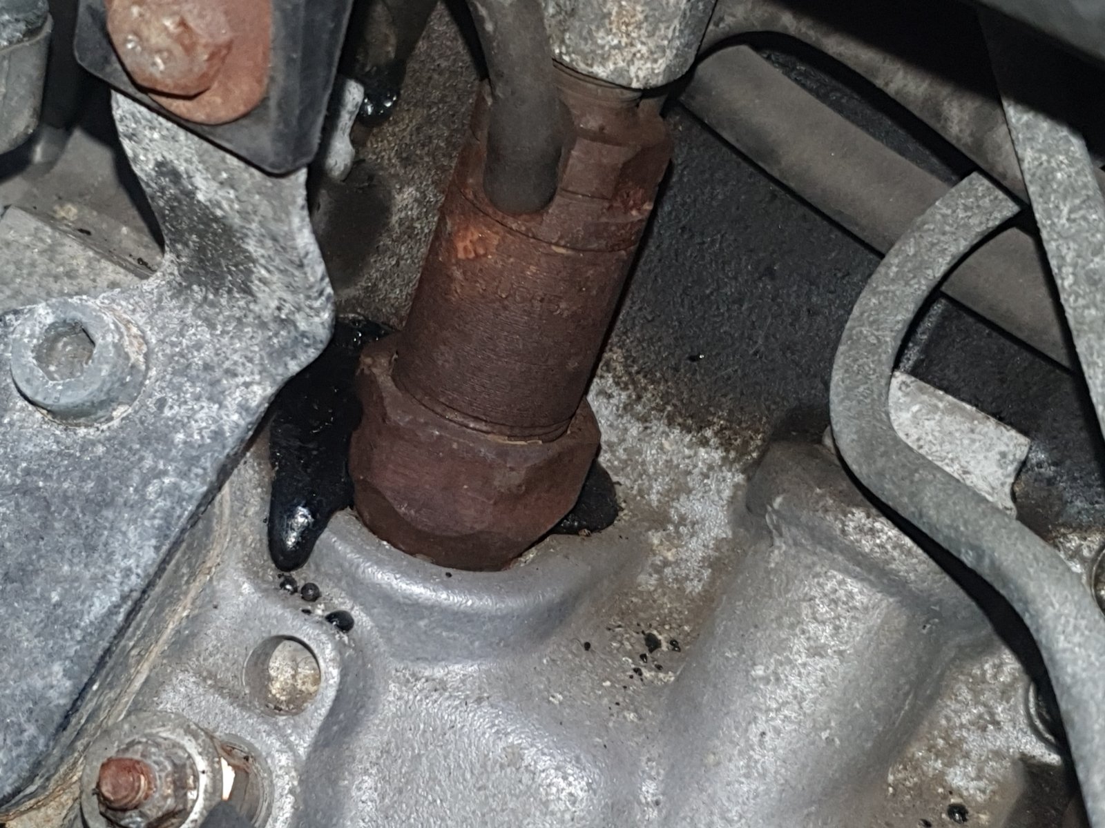

Other than this, the only other thing of note was my noticing of the black death around number 1 injector... a splodge of treacle looking substance has made it's way up past the seals and sat on top. Soft and rubbery when hot, but hard and brittle when cold. No idea how long it has been like it, but definitely time for the injectors to come out! Will seal all 4 to err on the side of caution, and I may also take the opportunity to have them all tested seeing as they will be out, and I'm wondering if this may be contributing to my strange surging problem mentioned earlier.

Black death appearing, yes good to get that sorted. Injectors out whilst engine hot (at least they are not too buried on an XUD!) As you say when the gunk is soft and will let go. Actually, maybe to a two pronged attack, chip the accessible bits off when cold and brittle then get engine warm for pulling out the injectors
I read on here that cellulose thinners will shift it too, not tried it myself as yet.

It'll be good to get that black death sorted... And whilst you are there, replace all the leakoff pipes and especially the little blanking plug on the last injector as I'll bet they're all hard and cracked now...
It may well be the cause of your surging problem ;)

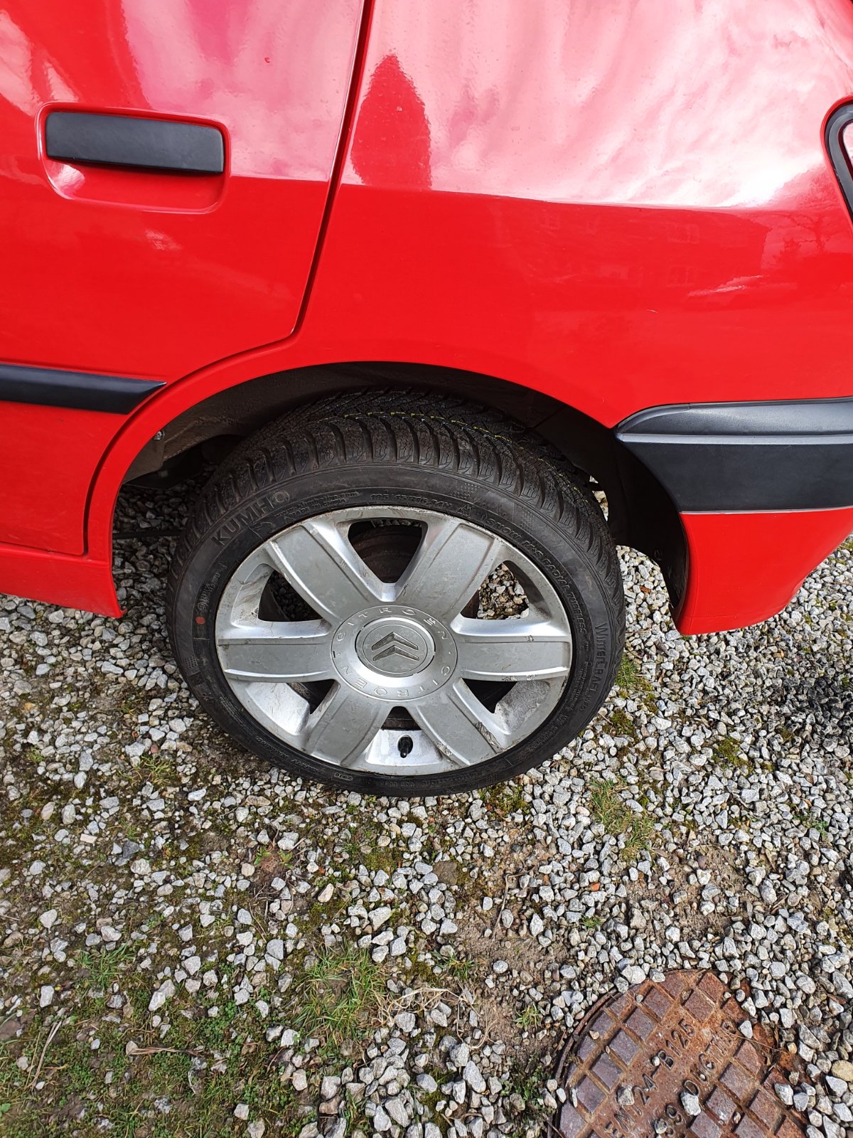

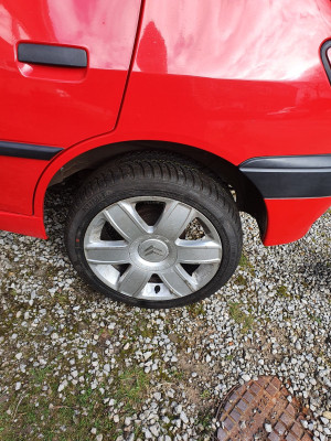

I had some spare 16 inch alloys in the garage that were off a C4 coupé that unfortunately I had to scrap not long ago. They are the same 4 x 108 PCD as the 306 and the same centre bore of course, so I suddenly had a mad idea to replace my 13 inch sofa casters with these. The only reason I had kept them back from the C4 was because they were in fairly good condition and the tyres were all Michelin / Good Year and still had at least 5mm on them all round. I quickly realised though that they would be far too big for the 306 unless I fancied shaving them down to cords on the wheel arches.
They had 205/55s on, and unsurprisingly the jump from 175/70R13 to this would have resulted in some comical (and dangerous) results. I calculated a suitable alternative for them would be 195/45R16, to narrow them a little bit more towards factory spec, and more importantly to shrink the sidewall considerably.
Now, I'm a bit anal when it comes to tyres. I swear by certain models such as Good Year Eagle F1s (even better than Michelin Pilot Sports in my opinion), and if I'm working to a budget I've always found Yokohama and Falken to be very respectable for the cost. However, I made a decision that I would make an exception for the 306, as it is so slow and is not the sort of car I throw in to corners in the wet and so on. I found on Farcebook a brand new set of Kumhos locally in Ilkeston that someone was giving away for £150 fitted, and I decided that was a steal. Okay, they are winter tyres, which are pretty redundant in the UK anyway, but they fit the bill nicely. I happily went down this morning and had them mounted on the C4 alloys. Nipped in to Euro Car Sharts in Derby to relieve them of 16 wheel bolts (I needed flat ones, the steelies had conical) and went home, desperate to fit my cool (in my head) new wheels and tyres.
Fronts went on and looked marvelous. Moved on to the rears and they fit, so it seemed, but made a school boy error and didn't actually check they turned freely with the handbrake off. Oops! :oops:
in my opinion, these are a subtle and tasteful modification. The 13 inch steels accompanied by cracked and cable tied trims that looked like they were from Skegness Market were bothering me.
Turns out they rub the inner edge along the wheel arch. Plenty of room up top, but not enough clearance for either the arch or the handbrake cable where is hangs!
After much grunting, back wheels were removed, steels refitted and rolled the car back in to its space on the drive, realising I now need either a pair of spacers or a plan B.
