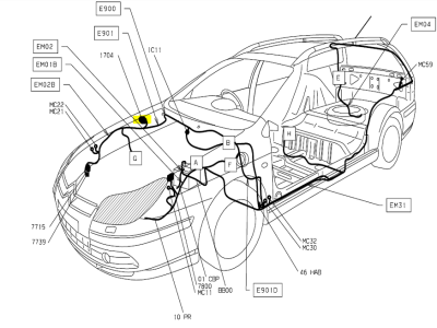

The supply first goes from the Maxi Fuse 8 to the relay (1704) as located below where I have highlighted in yellow.
The supply is on Pin 3 of the 5 pin connector.
The Earth is on Pin 2
The connection to the BSI (Fuse F13) is on Pin 1
The supply to the rear Height Corrector is on Pin 5.

Thanks again, Marc. Do you know how to access the relay?
x 6956
Re: C5 height sensors
If it's not visible where shown in the inner right wing, then it may be hidden or covered under the wheel arch lining. I never had an issue with it on my MK 2, so can't advise where it actually is, but it is in the vicinity as on the diagram.

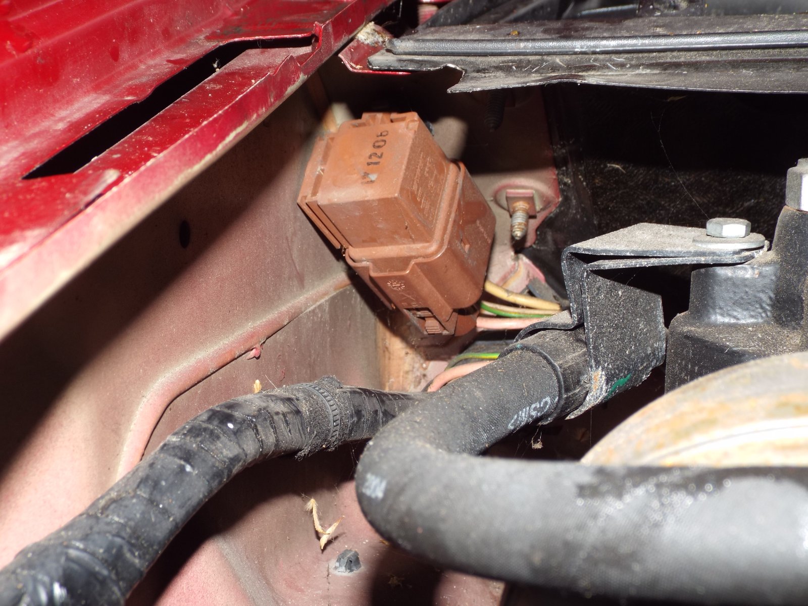

I may have progress. The relay has NOT failed, as there is 14V at the pump connector when the engine is running. I don't know it it is correct, but there is 0.75V on the exciter line. If that is correct it would suggest the power transistor in both motors has failed.
For anybody who needs to know, the relay appears to be inside the engine back close to the suspension mount (which might make it tricky to remove). It is a large brown unit.
