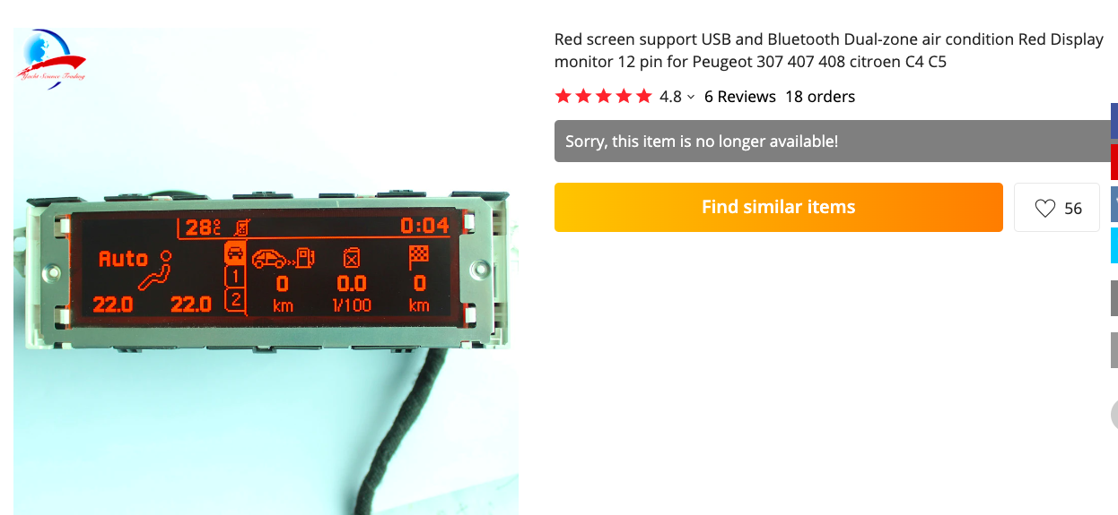

just finished the last fault which was that clock, trip computer, and radio screen slapped on the dash. It goes all haywire in the heat, I got one off aliexpress, which I'm pretty sure was used, and has a few differences I think out of a later model pug. it has a metal frame on the front, different part numbers, wiring plug at the other side and 90 degrees to the original, I was a bit sceptical but it bolted in the hole and it plugged straight in. Turn on the key and it works almost perfectly. I say almost because it has menus for blue tooth, parking assistance, and some other crap that the car doesn't have. Apart from that all good
