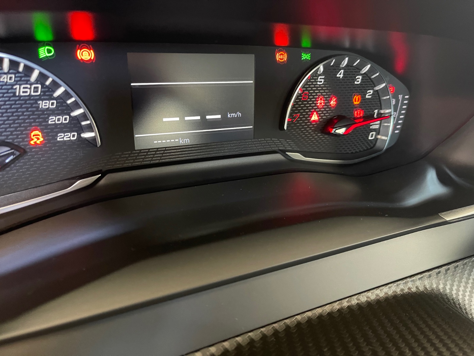

Hello Marc,
Well after almost one month the system is fine and going worked well
The Peugeot 2008 i have installed the rear cam and changed the trunk cable as well and success
It gives me a 7 hours of work on total, and i have to buy a token on diagbox to activate the camera and to justify the value of 39€ i have updated all the calculators as well.
It have an update on BSI, Injection, AirBag and ABS. When i was on update the ABS calculator the dashboard lose the count of the kms, so on this car the kilometrage is saved on the calculator and not on dashboard with is good because if i have to change the dash the kilometrage is updated on the dash
Great success on both cars after all
Regards.

Great thanks for the update. Be wary the mileage is saved in the BSI and the dashboard ECU - so updating the ECU software may just have restarted the ECU, but the mileage should be corrected shortly afterwards to the highest.

No on the BSI update the mileage shows up even before the telecoding.GiveMeABreak wrote: 13 Aug 2022, 20:55 Great thanks for the update. Be wary the mileage is saved in the BSI and the dashboard ECU - so updating the ECU software may just have restarted the ECU, but the mileage should be corrected shortly afterwards to the highest.
On the ABS calculator update the mileage disappeared on the dashboard and on final of telecoding shows up again.
The mileage are not stored on the dashboard with is good, because one time i have to change one dashboard on a Clio 2, not because of a a malfunction but because of adding Board Computer and i have to wait until the car reaches the mileage to change it
Regards.
- x 6957
Re: DS3 Hi-Fi Sistem - Help Needed
All I'm saying is I've seen this happen before many times where the instrument panel has assumed a higher mileage when replaced. So I'm just warning you in case.

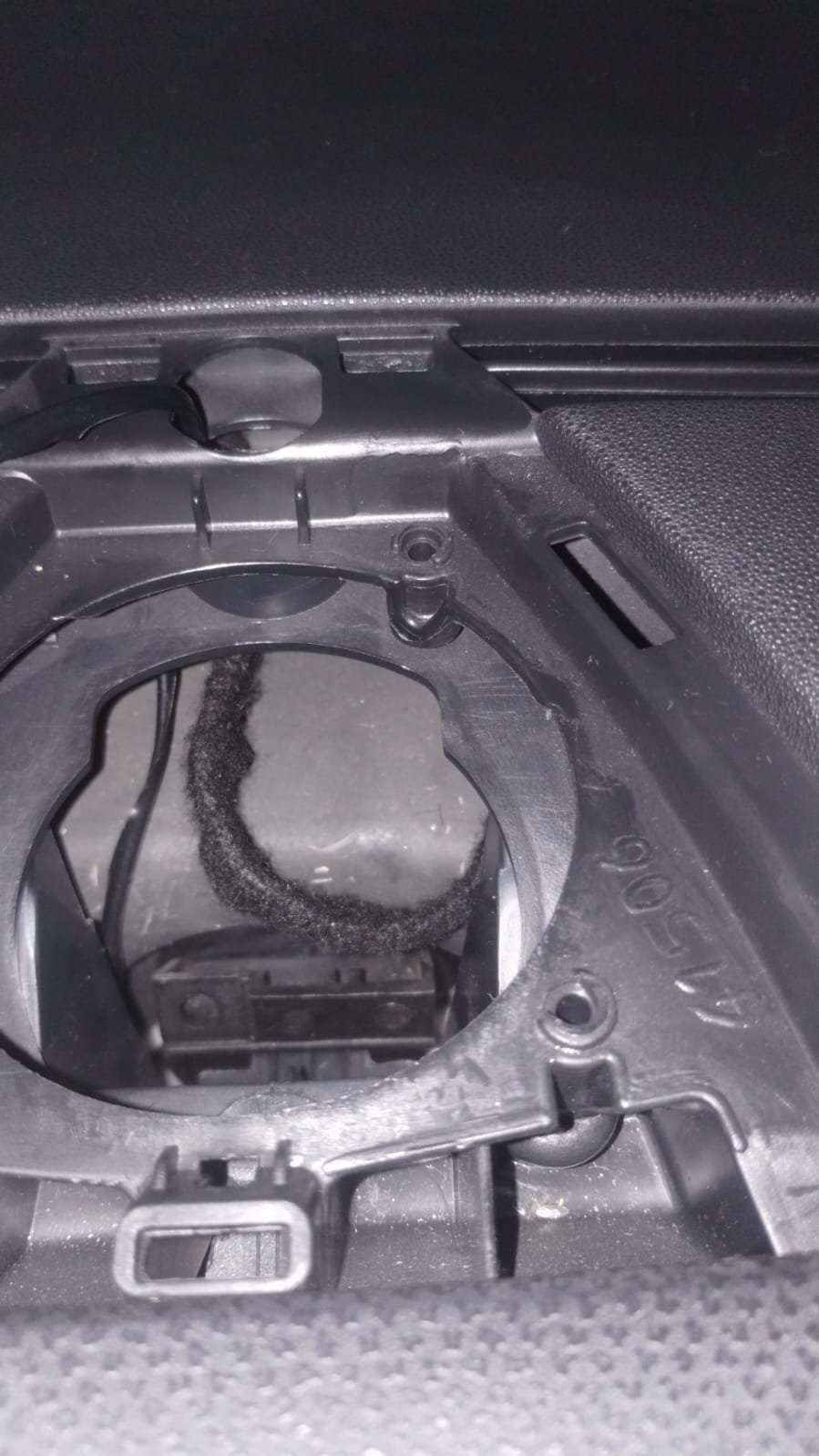

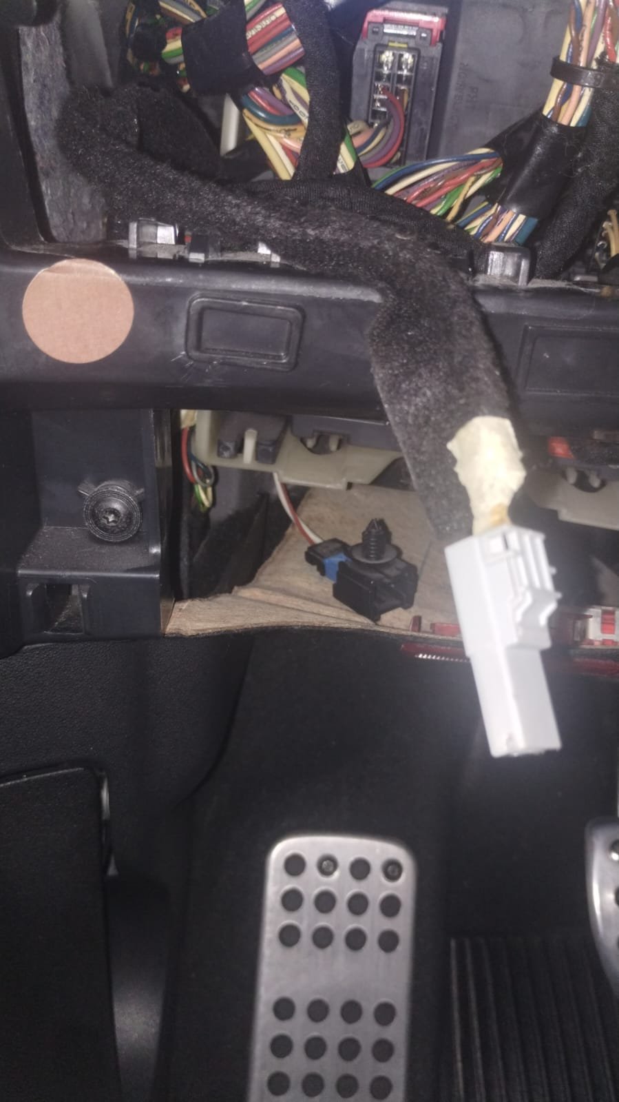

I have a DS3 2013.
Bought the central speaker, but I need help to install it. Since i don`t have the BFH1 box, do I have to buy it? Because my car does not have the heated seats. I do not intend for now to buy the Rear sub.
I have to make or buy(if there is a code for that, would help) a harness for the central speaker and also, where do I attach on the radio (the pins?)
You can see on the photos that I found 2 plugs on the botton box and on the central speaker vault, the cable that pass throught there is for the tweeters, no other harness in there.
So...I was able to find the connector for the central speaker, but no sound or energy seems to come through (tested with the multimeter). The thing is..do I need Activate via Diagbox only? Or need anything else? Like running a cable through to "energize" the connector. As you can see, I don't have the BFH1 in my car
**Update -> Was able to activate via diagbox to the HIFI analog (because the hifi digital the system does not allow me)
Checking the cables, the central speaker harness is connected to the radio, but still no sound coming from it
Now if you guys can help me out, let me see if I understand
The diagram 8427 is the radio itself? I was unable to find the BFH1 in my car. So I was thinking, Can I wire the radio (wich pin?) direct to the PSF1 Maxi Fuse MF7 using a universal fuse box between? Maybe is the solution? Thanks
Many thanks
