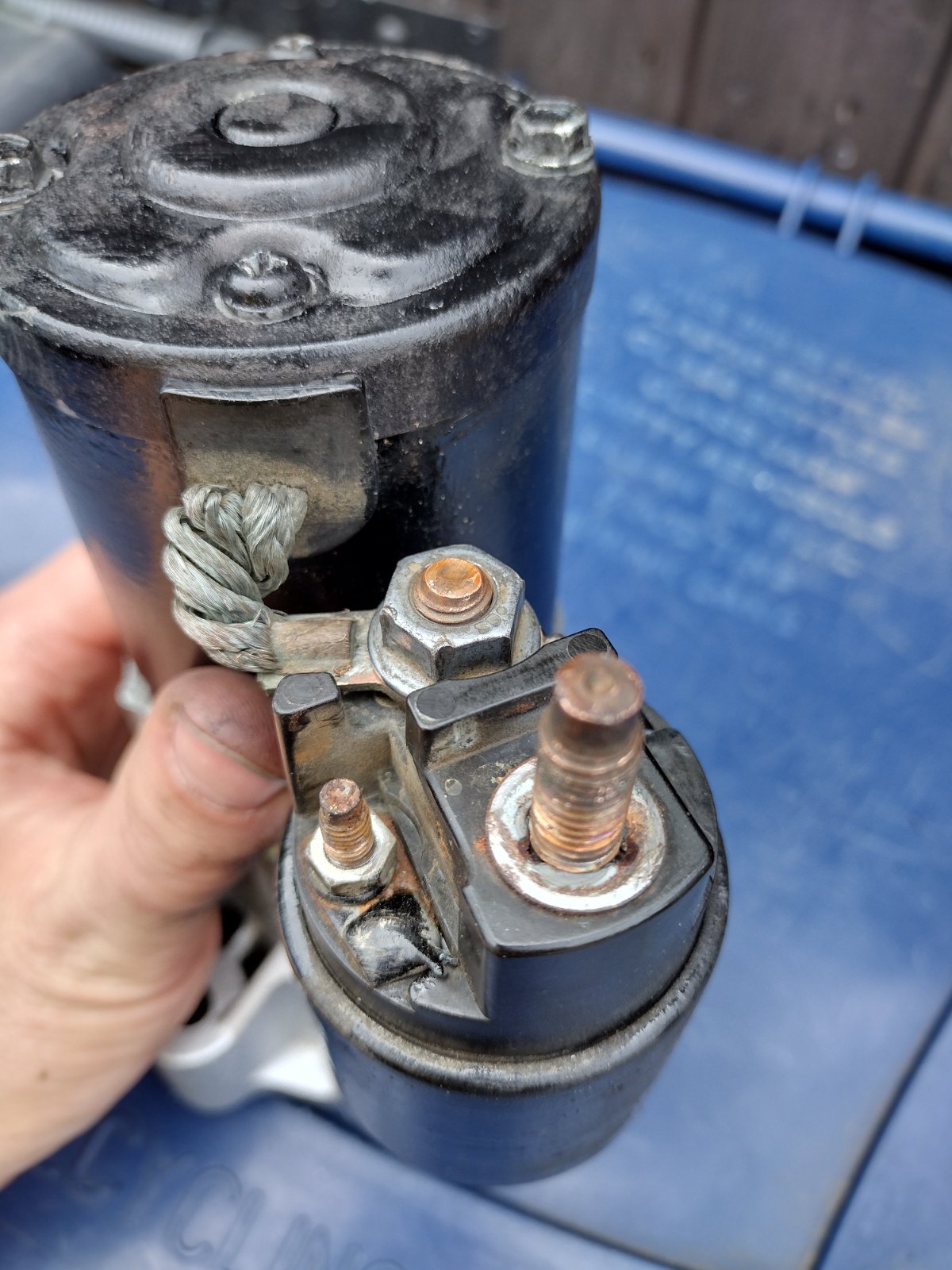

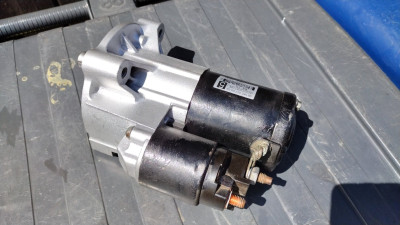

Quick re-prime, then start attempted - start-stop cough remains.
Starter motor off next
Matt
Matt

I'm not hugely convinced either, but others reported a slow starter was enough to give them starting issues. On the 2.2 it's front of the block and relatively easy to get at. So I'll get it off clean out and regrease it.
The hypothesis that starter speed isn't enough (but jolted into life with lots of revs by use of easy-start is enough) does align with my symptoms so I can't prove its not the case for me.

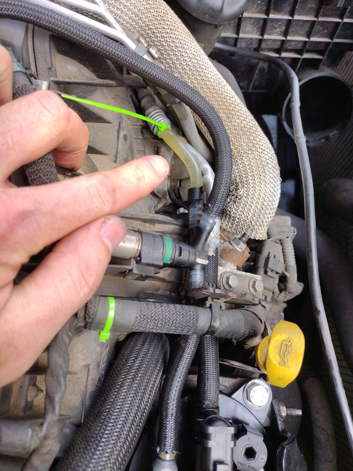

Have checked all engine bay fuel pipe connections and all seems ok. No obvious stream of bubbles on the clear pipe section post priming bulb. So doesn't seem like it is taking on air on route from the tank.
Matt

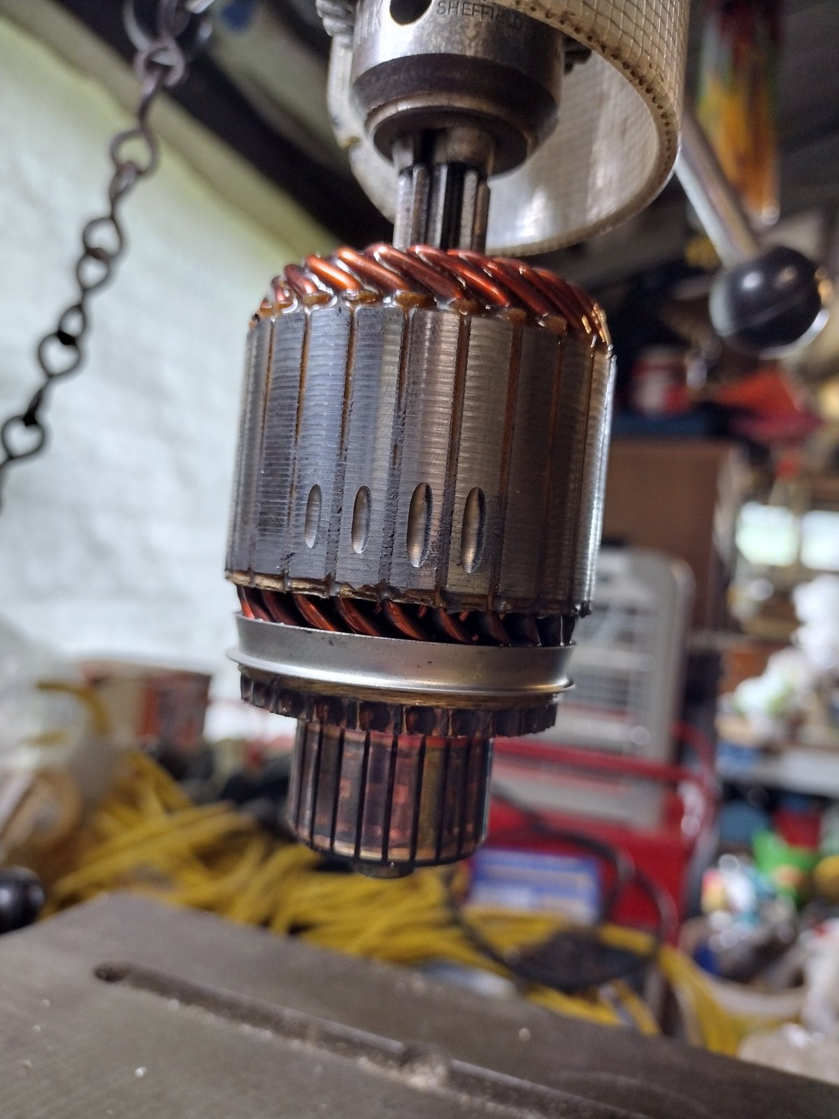

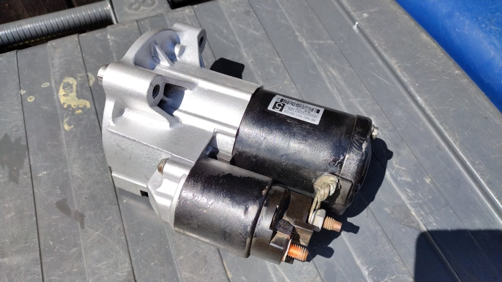

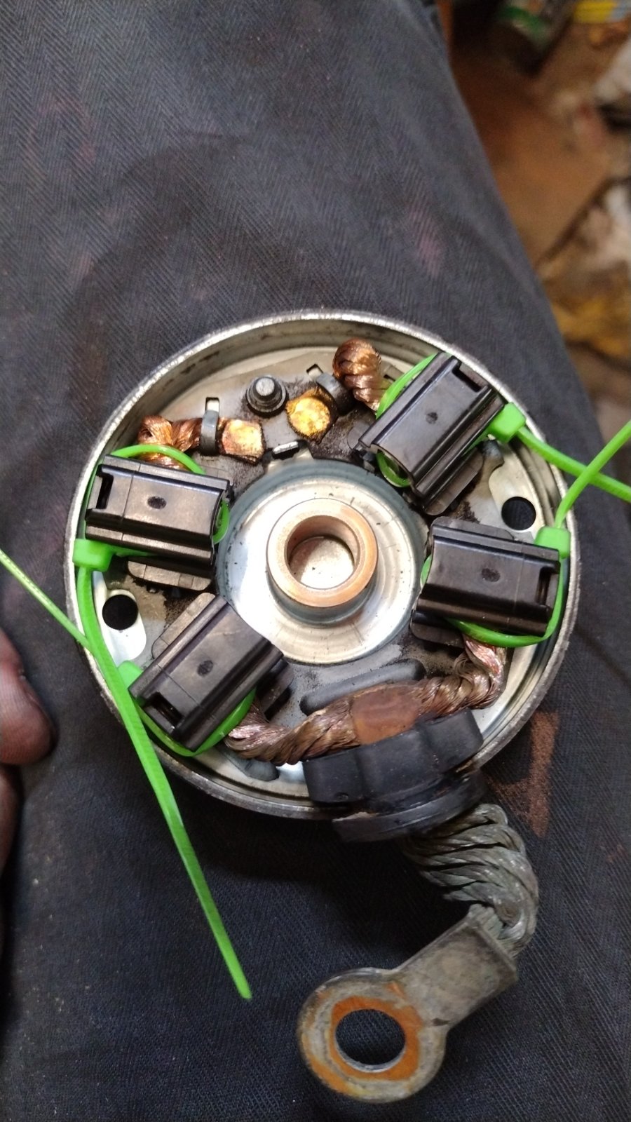

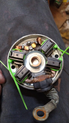

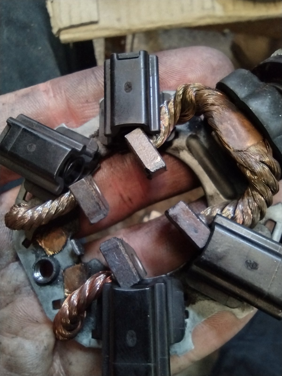

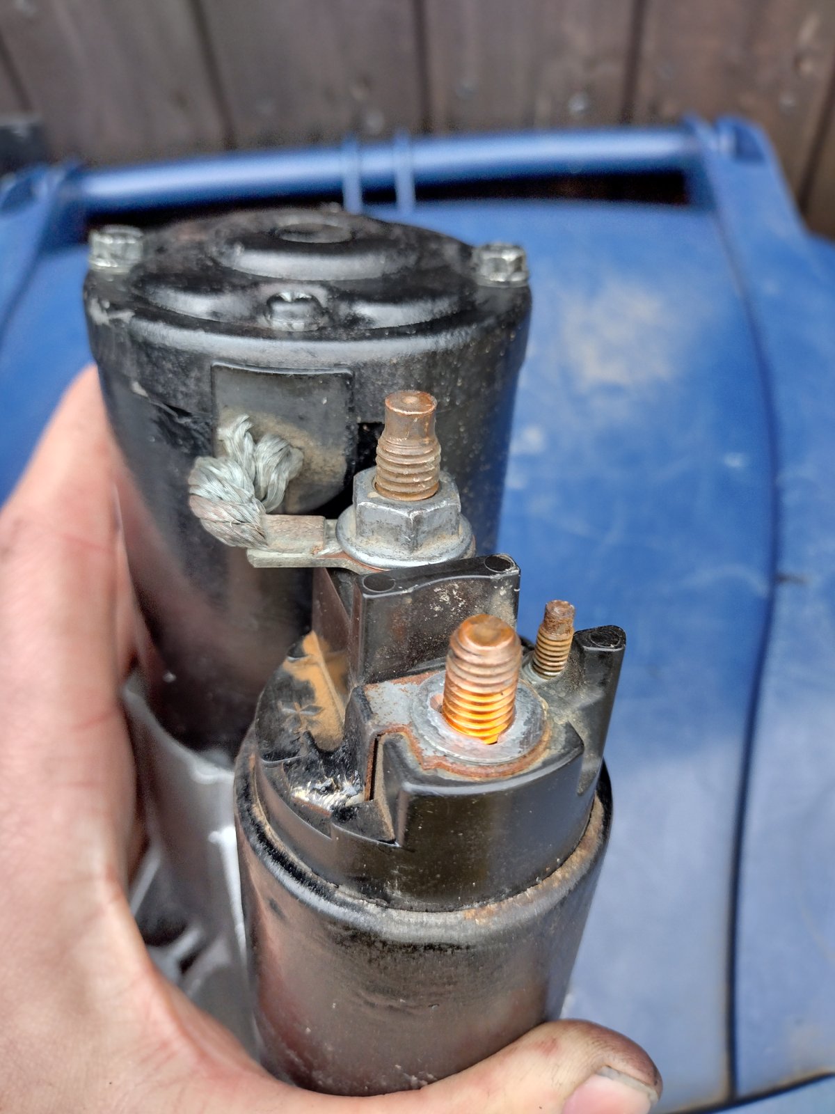

Starter motor off tonight (rainy tomorrow so make hay whilst the sun shines) will give that a bit of a refurb / clean the commutator, regrease etc tomorrow.

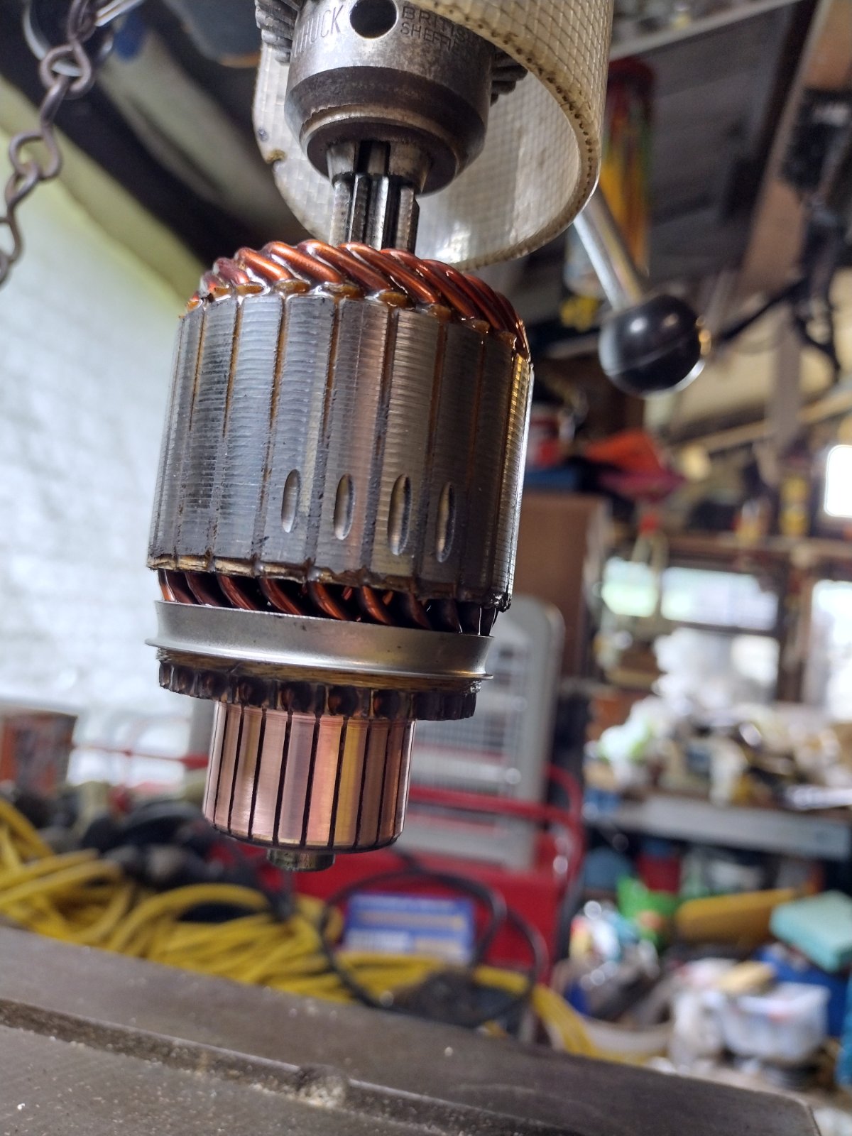

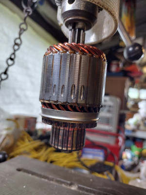

Time to put it back on the car.
Matt

I'm glad you posted those pics, I've still got my old starter I replaced a few weeks ago. might take apart and see what the issue was. And yeah the 2.2s have them in an easy DIY spot to replace.

Not a problem. If want any more info on how it comes apart, how get back together, just give me a shout.
