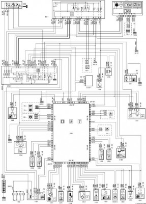

Out of curiosity Have you checked the maxi fuses underneath the under bonnet fuse box?
Looks like relay 1508 links to the under bonnet fuse box so if anything has popped i would suspect that rather than the ECU.
Here is the injection diagram. Fuel pump is 1211.

OK, I've been studying these diagrams for a number of hours now and I can't see any reason why shorting pins 1&3 on 1508 would upset the fuel pump circuit. Except.... just possibly a shared relay in the BSM! But that doesn't explain how the pump runs for the initial priming!
This is going to be a nightmare to diagnose remotely but I'm up for the challenge if you are? It'll be a long step by step process while I work through the wiring testing and checking points. I can't give you a list of checks to do as its a case of if this happen go here, if not go elsewhere as one result either way will dictate where to go next.
You need to concentrate on the fuel pump circuit first and when that's fixed, we can go back to the Fan circuit. By all means check MF1 as wheeler suggests just to be sure it's okay but I think that only provides power to the fan.
First thing I need to work out is where the pump supply comes from during Priming and what changes after the engine starts! To do this we need to eliminate the possibility of a second supply to the pump in the prime phase. To do that, we remove the primary source of power and see what happens! Therefore, Could you pull the pump fuse (I think it's F2 in the engine fuse box but check your handbook as the diagram isn't clear enough to read) and confirm if the pump still primes?
