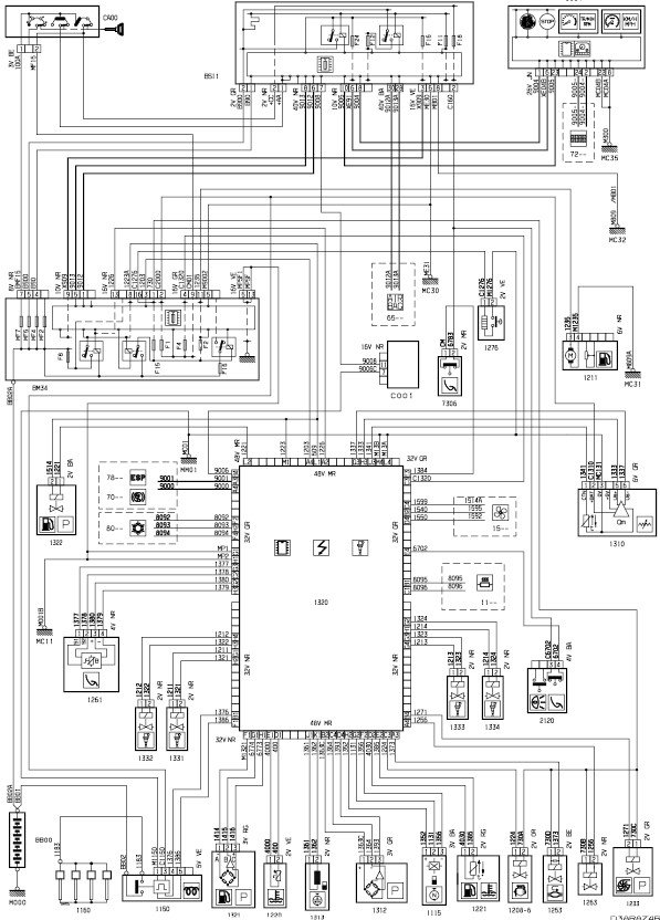

Out of curiosity Have you checked the maxi fuses underneath the under bonnet fuse box?
Looks like relay 1508 links to the under bonnet fuse box so if anything has popped i would suspect that rather than the ECU.
Here is the injection diagram. Fuel pump is 1211.
MGmike
- Posts: 182
- Joined: 29 Aug 2020, 18:29
- x 63
Re: 2004 c5 hdi 110 cooling fan woes and now not running....
OK, I've been studying these diagrams for a number of hours now and I can't see any reason why shorting pins 1&3 on 1508 would upset the fuel pump circuit. Except.... just possibly a shared relay in the BSM! But that doesn't explain how the pump runs for the initial priming!
This is going to be a nightmare to diagnose remotely but I'm up for the challenge if you are? It'll be a long step by step process while I work through the wiring testing and checking points. I can't give you a list of checks to do as its a case of if this happen go here, if not go elsewhere as one result either way will dictate where to go next.
You need to concentrate on the fuel pump circuit first and when that's fixed, we can go back to the Fan circuit. By all means check MF1 as wheeler suggests just to be sure it's okay but I think that only provides power to the fan.
First thing I need to work out is where the pump supply comes from during Priming and what changes after the engine starts! To do this we need to eliminate the possibility of a second supply to the pump in the prime phase. To do that, we remove the primary source of power and see what happens! Therefore, Could you pull the pump fuse (I think it's F2 in the engine fuse box but check your handbook as the diagram isn't clear enough to read) and confirm if the pump still primes?

OK F2 removed.. No fuel pump prime.

This sounds similar to a problem we had on our 2001 Xsara some eight to ten years ago. The engine would run for a second or two on starting up and then stop. I think it is a safety mechanism to only supply power to the lift pump for a few seconds to get the engine going and then something (the engine ECU?) issues a command to keep the pump supplied with power. This obviously wasn't happening. I checked the wiring from the fusebox to the pump by supplying a temporary 12v directly from the battery (take the fuse out first - you don't want 12v being injected backwards into the BSM or BSI) and the engine ran just fine.
I failed to find the ultimate cause of the problem so bypassed it by setting up a fused relay to supply power into the fusebox connection to the pump where the fuse used to be. I switched this relay on by taking a signal from one of the other fuses that were switched on and off by the ignition. On the Xsara there was an inertia switch and, as a safety precaution, left that in the circuit. Your car may not have one.
This was still working when we sold the car four years ago.
MGmike
- Posts: 182
- x 63
Ok, good. That confirms at least two of the relays in the BSM are working.
Question now is how does the ECU tell The BSM the engine is running...?
It could be via the CAN but I think its more likely to be a direct connection so as not to be effected by spurious CAN messages. The only wires that looks like an ECU control connection are on the BSM Black plug pins 3 &15.
Could you measure the voltage on these pins before and after the engine stalls?
