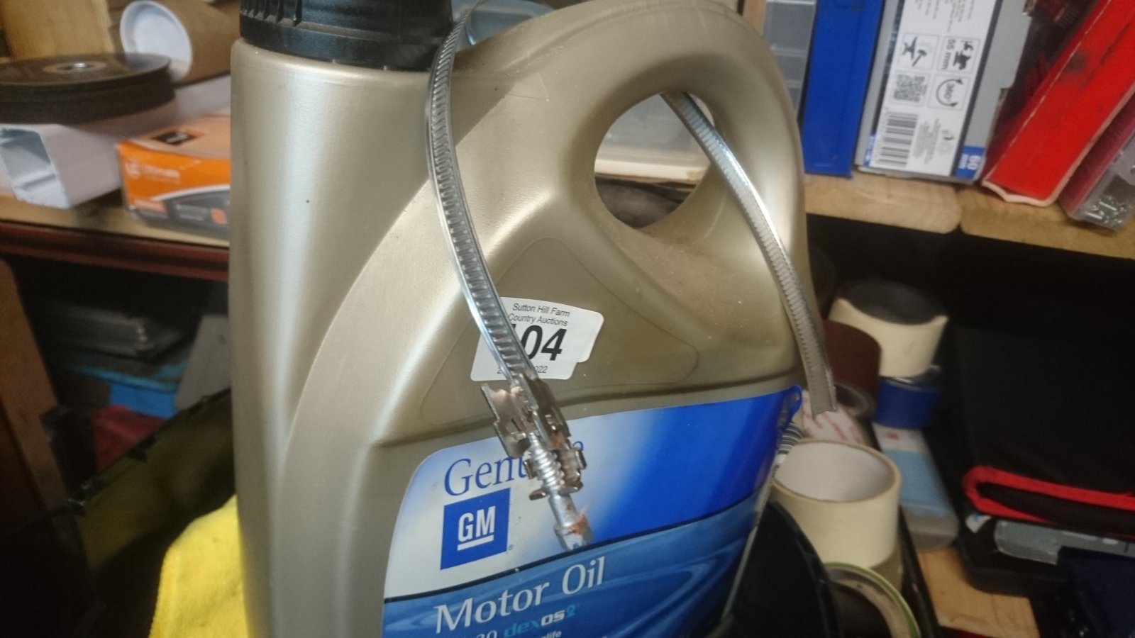

Yes I've used worm drive jubilee type clips in the past. If you look around the ventilation world you will find very large ones that are designed for ventilation trunking on cooker hoods for example, they are 4-6" diameter and do the job very well, here is the chap around the 5 litre oil can for scale:
You can fit a winding of stiff wire opposite the worm gear to balance it if you get any vibration but I've only ever done that once in 20+ installs
