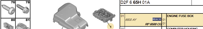

Okay, I'm resurrecting this thread with an update. What a nightmare!
After the garage being unable to source a fuse box, I was put on to a mate of his who could apparently fix / replace the offending relay, but that ended up being a dead end.
So I decided to order the part myself from a Peugeot dealer. It was on their system for weeks, showing as 'on back order', only to find out today that Peugeot has discontinued the part
I contacted eurocarcare about the aftermarket one here:
https://www.eurocarcare.net/bulbs-fuses ... e-box.html
And was told in no uncertain terms that it's not a replacement for the 6500CG, and that the car might not even start with this fuse box installed, and that (before I ask) - no, they won't accept it back if it doesn't work
So, I guess that unless I can find another company that does brand new replacements for the 6500CG, I have to run the risk of sourcing a secondhand one

Well that is incorrect, however, to be fair, they may not be aware that the original part has been replaced by PSA themselves and the one I linked to is the the correct one:
See for yourself. They don't provide your original one any longer, but do now supply one I linked to and that is what you will get if you go to Citroen / Peugeot.
There is no programming involved with these on this model, and they would not therefore be supplying these if they were not compatible.

Thanks, Marc.GiveMeABreak wrote: 22 Oct 2021, 12:53 Well that is incorrect, however, to be fair, they may not be aware that the original part has been replaced by PSA themselves and the one I linked to is the the correct one:
So if I want to order the part from Peugeot, the part number is 6500AY now, rather than 6500CG? Alternatively, I could still go to eurocarcare and get the ECC9807028580?
- x 6960
Re: [2006] Peugeot 407 SW 6-Speed Auto Slipping Out of Gear?
No the other way round
: the original part was 6500AY, and now superseded with part 6500CG. Note the "RP" in front - which means Replacement Part. These are getting hard to find now - both original and replacement parts though. I'm sure that link at Eurocarcare.net has changed since I originally linked to it - as mysteriously the part number is no longer in the compatible list.... so ignore all those part numbers as they are NOT compatible. Don't know what happened there - maybe they re-checked it after you contacted them changed it ....

Ah, I see. In that case, I guess I need a good Peugeot breakers yard - any recommendations? I'm still not 100% on whether it is the fuse box, but I feel a bit stuck really as the local specialist couldn't suggest anything else. It could be coincidence, but it does seem like we get more problems in the rain.GiveMeABreak wrote: 24 Oct 2021, 20:07 No the other way round: the original part was 6500AY, and now superseded with part 6500CG. Note the "RP" in front - which means Replacement Part. These are getting hard to find now - both original and replacement parts though. I'm sure that link at Eurocarcare.net has changed since I originally linked to it - as mysteriously the part number is no longer in the compatible list.... so ignore all those part numbers as they are NOT compatible. Don't know what happened there - maybe they re-checked it after you contacted them changed it ....
Yes, quite possible eurocarcare changed the listing. I note that the 407 is still listed as a car it will suit, but must be different models/revisions.
- x 6960
Yes, most definitely down to a different engine and vehicle options as to the differences, and therefore essential to get the either 6500AY or 6500CG where you can.
