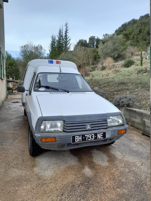

The van is now fully registered as historic and the next MOT is due in 2031. It's now sporting a brand new pair of silver on black number plates.

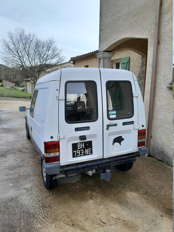

The "sanglier" (wild boar) on the back door has been there since before I bought it in 2012. The previous owner was a hunter.
I also have a factory roof rack for the van, but I take it off when I don't need it - it's very noisy over about 40mph, and not surprisingly it makes a right dent in the fuel economy. Without it, the van averages between 45 and 50mpg.

Van is now properly re-registered as "Véhicule de Collection" with a new registration document and some shiny new silver on black number plates. This isn't the original registration. It appears that the van was bought new by a painter & decorator in Marseille (so it would have had a number that would have been ****AB 13) and then at some time it came across the Rhone into the Gard and had a number plate ending in 30, and then when an old guy gave it to his grandson in 2012 it was issued with the new style number (as seen) - the new ones do away with the departmental code and remain with the vehicle for the rest of its life. There's no way the older numbers are recoverable, not in France anyway. Whatever.
All good now for the next 5 years. Rock on!
