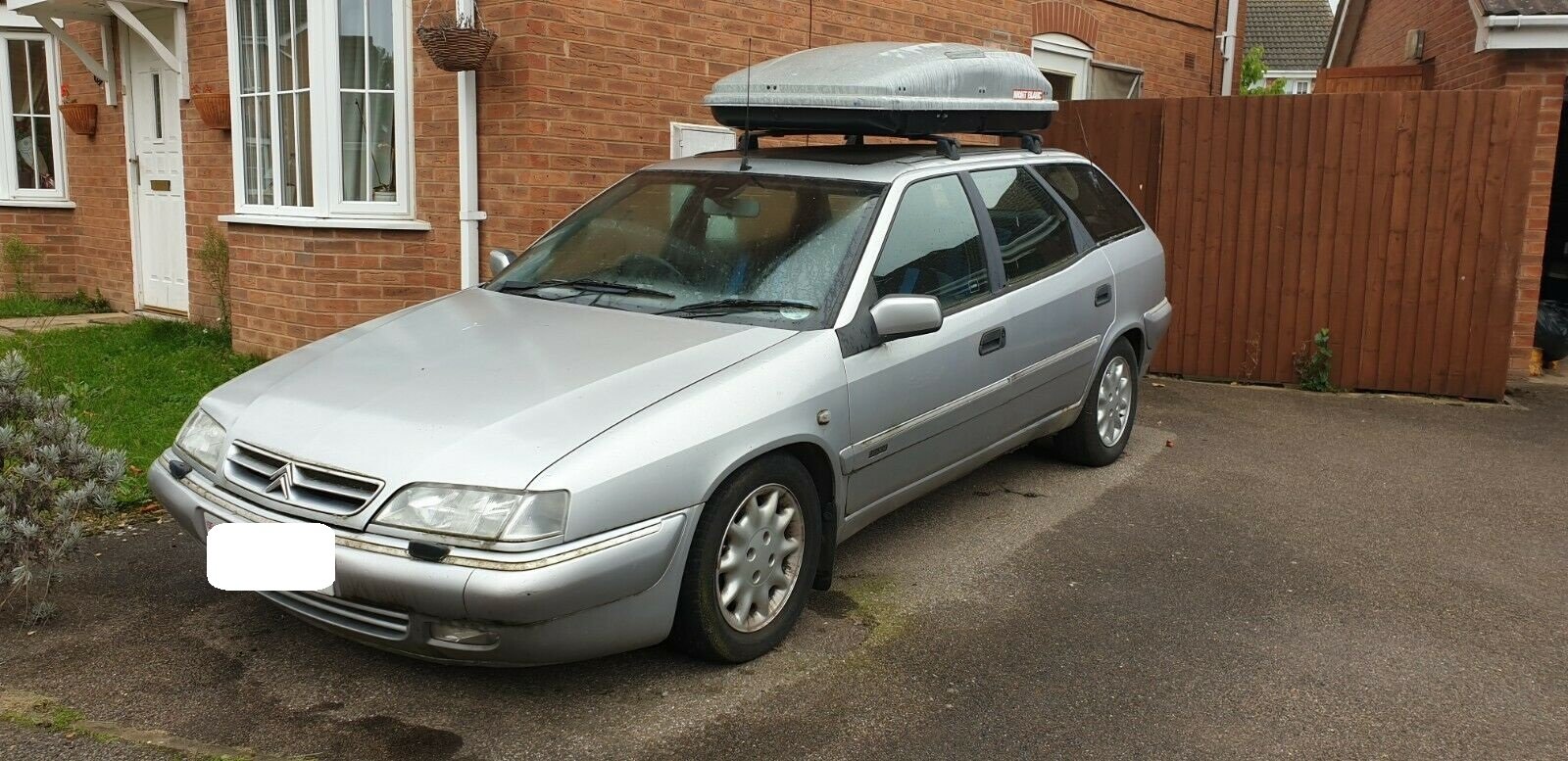

citroC5
Posts: 103
Joined: 27 Mar 2019, 22:20
x 20
Re: Oh no 🤦🏼??? I've just bought another Xantia !
Unread post by citroC5 »
zs&tas wrote: 13 Nov 2020, 19:08 what a lovely car ! quiet , comfortable , Powerful ! im impressed, it needs a dam good clean though ! with moss all around, it needs tyres as they are sun baked cracking, and i have to fix the abs light ?? any ideas where to start on that one ?
thanks
It looks sodding well amazing. I hope you get some great miles out of it!
