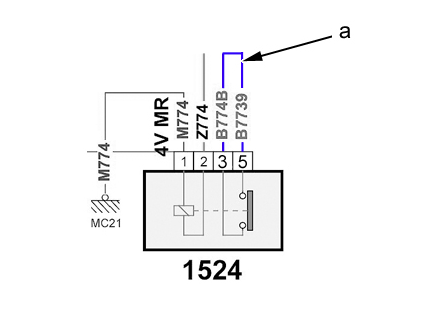

- x 6947
Re: Burst suspension pipe at rear
Your U1118 codes are non-communication with the BSI Kenny and the U2118 is a Triggering (height adjustment receipt anomaly): Not characterised.
So I would double check all the connections to the BHI and pump area as these could of been disturbed. Here's some info on checking the relay:
1) Double check earth connections
2) Check power between track 1 & 2 of the 2-way black connector on the BHI (use a 55W test lamp). If it shines brightly, move onto point 3) below, but if it shines weakly, or doesn't illuminate, check the power supply between the BHI and the relay.
3) Refer to Diagram below:
Shunt the integrated hydro-electronic unit relay (1524) between terminals 3 and 5 (at "a"):
If the integrated hydro-electronic unit operates, then the relay needs replacing.
If the integrated hydro-electronic unit does not operate, check the control line terminal 2 of the electrical relay.

- x 6947
Here you go. I can't see a separate part for the relay, but it is located below in the first diagram in Box 'H' (component 1524).
BFDB is the fuse box at the battery outlet (F01) and that is the supply to the Relay above, travelling along B7740 to Pin 3 in the relay.
