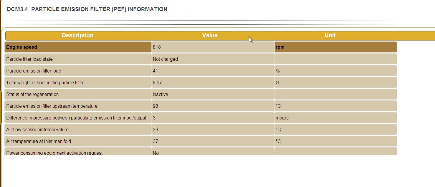

Isn't this the reading from the differential pressure sensor? Seems to be very low (3 mbar).

Re: DPF health check
Yes that's the current reading. You want the reading to be low....
1000 millibar = 1 bar and the sensor operates from 0 bar to 0.9 bar (0 to 900 millibar). So a reading of 3 millibars shown in your screenshot is near to zero on a scale of 0 to 900 means the filter is perfectly normal and not clogged as you would expect after a regeneration has taken place. This reading will fluctuate and be different each time you run the diagnostics - because of the different state of clogging of the filter at the time you take the reading and whether a regeneration has taken place or not.
Not sure why a sensor would report pressures outside the operational range but if accurate it looks like the DPF is in pretty good condition even after all these miles!
