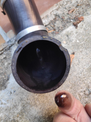

Extra info: Just took of this piece of hose from between the turbo and the intercooler. I can't remember it to be this wet some years ago. Is this more than just from the fumes? Can this be only because of the turbo or can there be another cause for this? ( and the oil usage of 1ltr on 400km).
- x 1746
Re: Trying to find oil leakage XUD9
Not unusual for the pipework from turbo to intercooler to be oily, and inside the intercooler too.
With the car parked up and engine properly warmed up, if you boot the accelerator hard, is there any sign of blue smoke from the exhaust? Black smoke would just be down to the extra fuel being injected; white smoke could be glycol coolant getting into one of the cylinders, and burning (unlikely - you would have mentioned that).
As you say, 1 litre in 400km is either a physical leak, or it's getting combusted.
How's the compression? Just wondering about piston ring condition?
Another possible route for heavy oil consumption is worn valve-guide O-rings, which let oil from the valve/cam area get sucked into the cylinders.

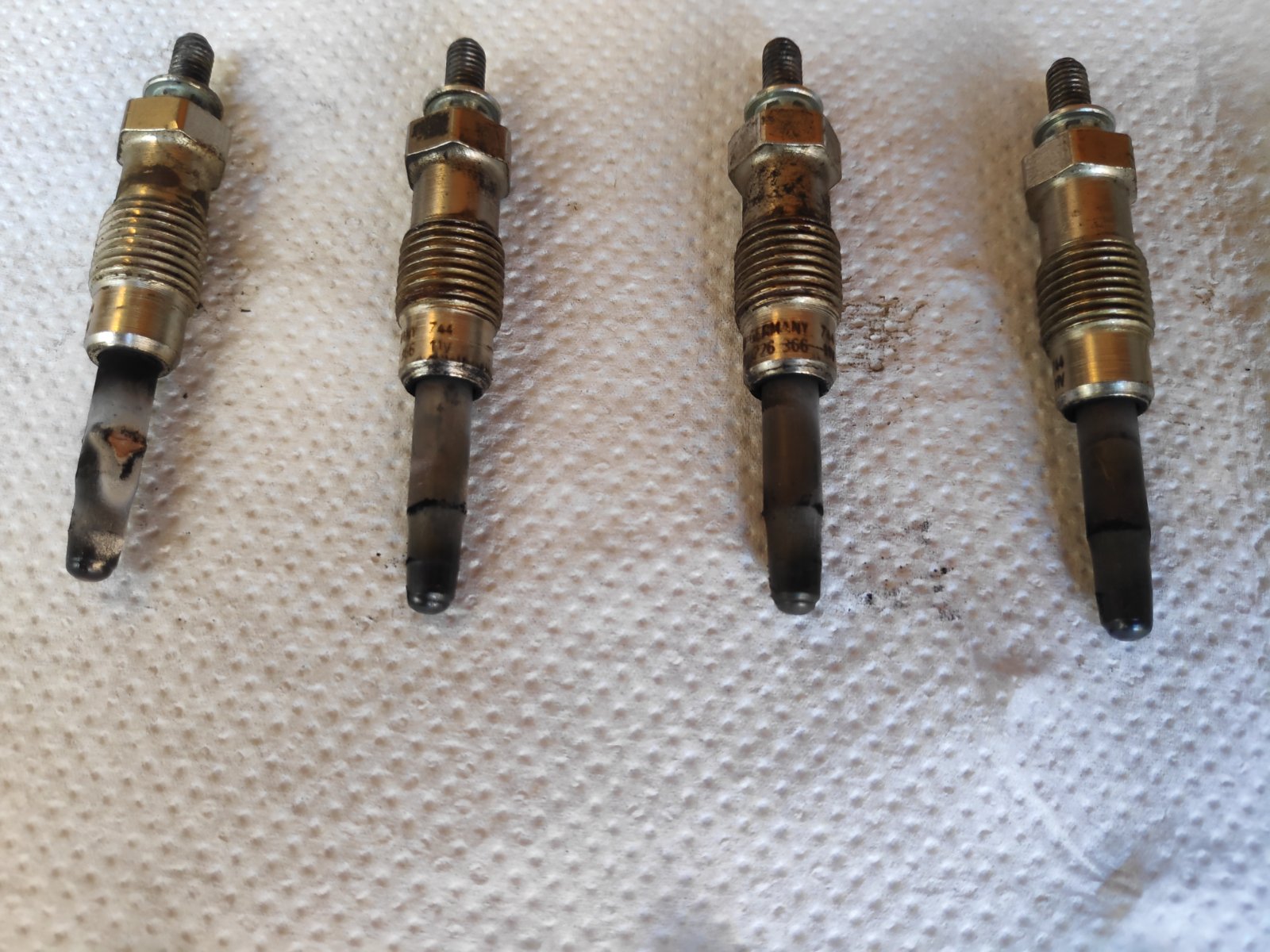

Took the glow plugs out this morning. They are 3-4 years old. It always starts without a problem. They are not really wet or something. But the left one does not look right. It's from the most right cylinder. Is this sooth or something else?
Or would you define this as all 4 are soothy because they are not white grey at the tip?
Onlinemyglaren
- Posts: 28726
- x 5672
Might be a good thing to test them while they are out.
If they are faulty then Beru replacements are recommended.

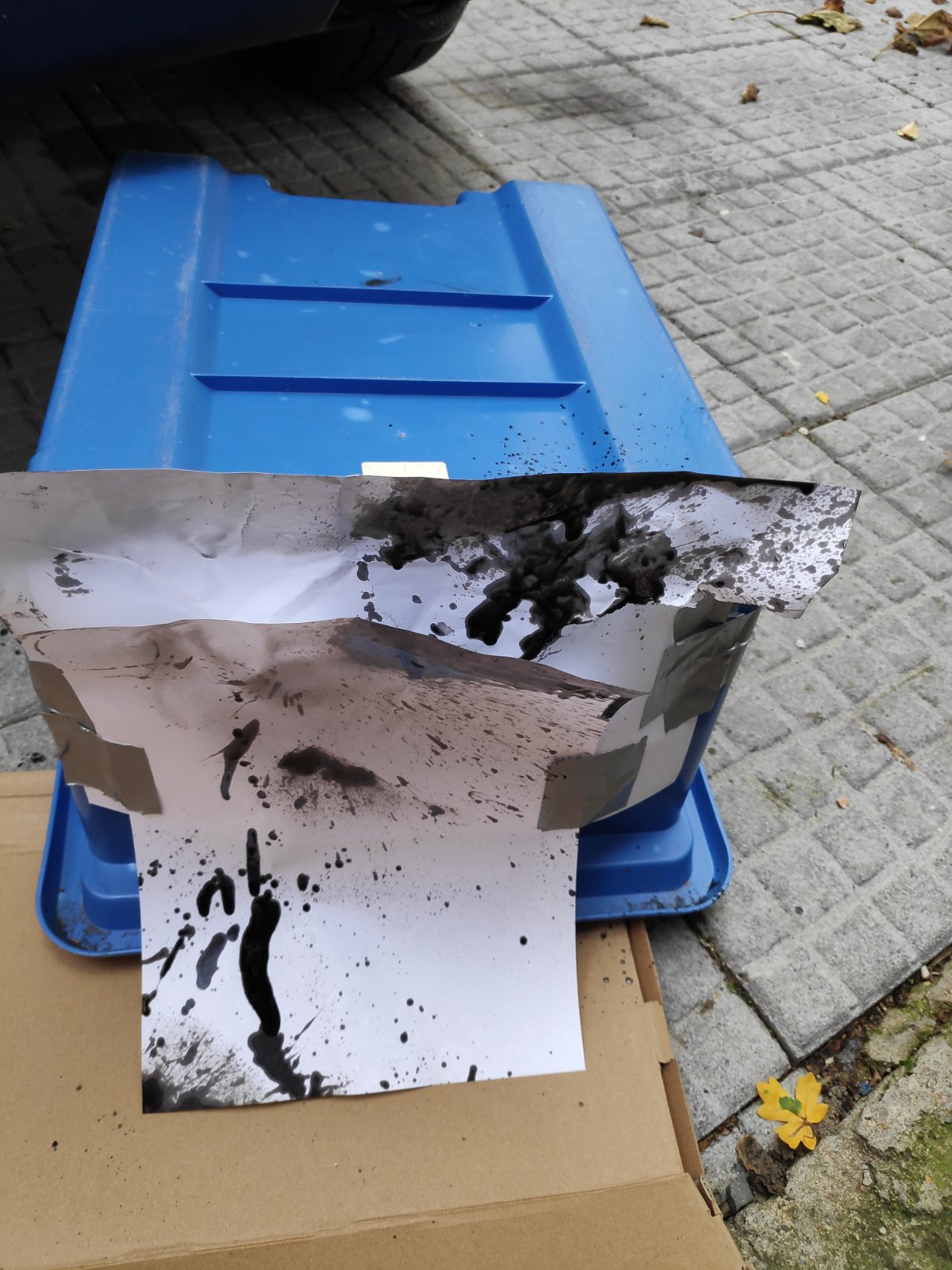

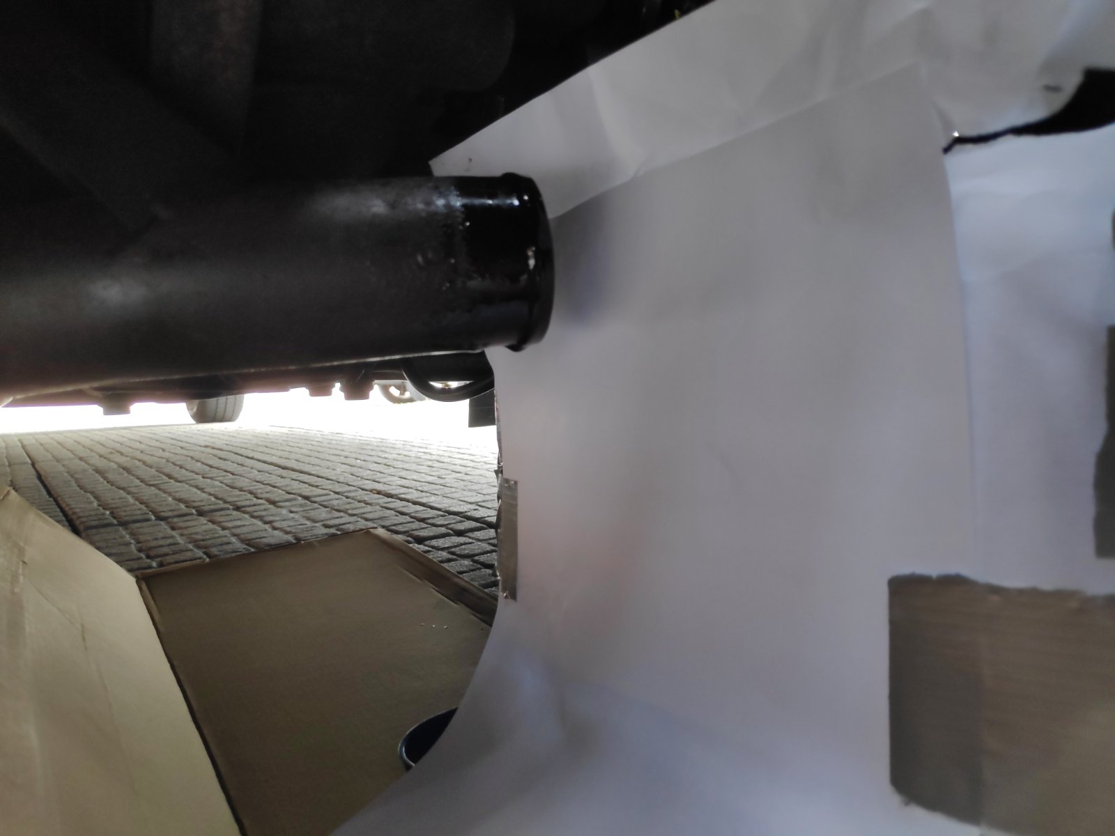

To check if the turbo compressor is leaking oil someone advised me to run the engine warm, remove a piece of hose from in-between the turbo and the intercooler and then place a piece of paper in front of the pipe and run the engine for 30 seconds on 3000 to 3500rpm.
I did so and here is the result... I assume that this oil can only be from leaking bearings in the compressor or might there be another cause for this.
Please give me your thoughts on this.
- x 1746
That does point to the turbo blowing out oil.
Might just be worth fitting a new/reconditioned one.
