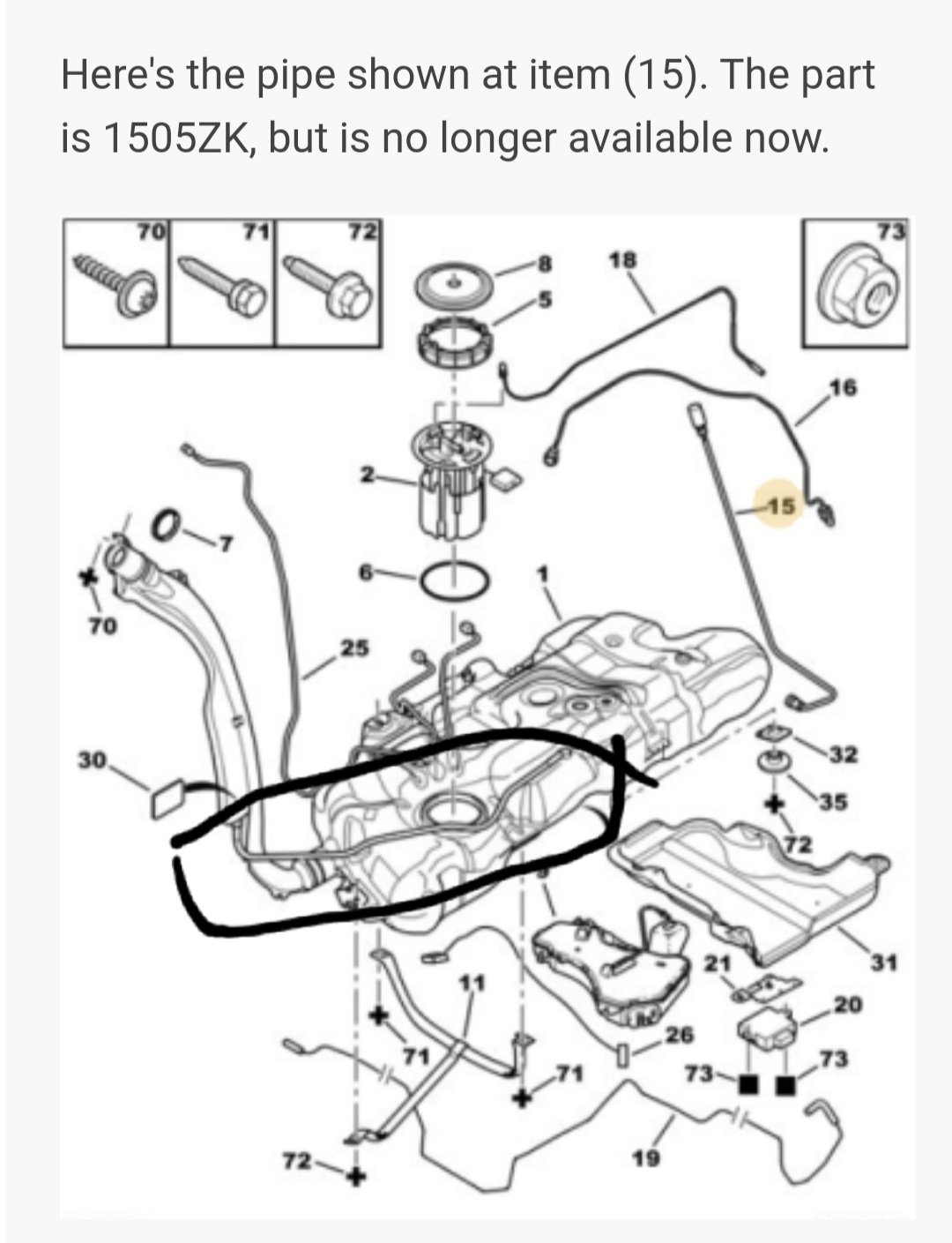

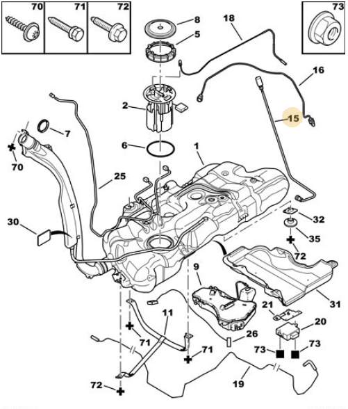

Re: Fuel tank leak.
Thanks for renewing your Forum donation.
Here's the pipe shown at item (15). The part is 1505ZK, but is no longer available now.

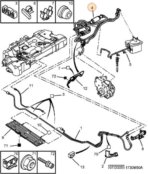

Gazzaman22 wrote: 21 Nov 2022, 22:16 Thank you marc - would you have a part number for the priming bulb and all pipes coming from/to it and any recommendations of where to buy it? VIN VF7**************[VIN obfuscated, can be read by forum staff] Many Thanks
If it's item (4) (Injection Pipe Harness), it's part: 1574W2, £157.19 from Citroen.

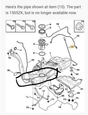

GiveMeABreak wrote: 21 Nov 2022, 21:07 Thanks for renewing your Forum donation.
Okay so, it's not available anymore. Except I can rob one from my spares car.
Why would the breather pipe become blocked and would there be anything I can do to remove blockage before I take my spare off?
Is taking the tank off my spares car hard? And am I right in assuming that fig 15 is the one that I have circled in the picture?
x 6950
Re: Fuel tank leak.
Yes, (15) is the vent pipe.
