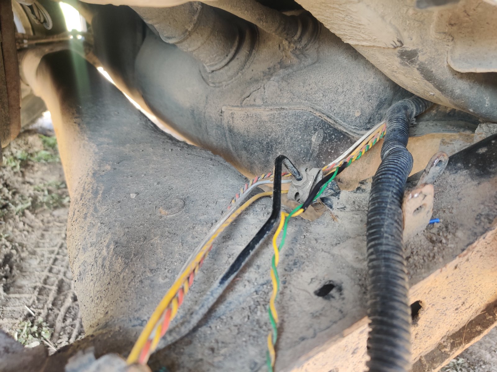

Djmorgan21547739 wrote: 24 Oct 2020, 18:43 Okk so a little update, I found two corroded wires on the drivers side rear. I have soldered and heat shrieked the wires. Reset the fault codes using the code reader and re assembled.
Marc your an absolute hero for sending me in that direction! Thank you thank you thank you!
Where is that picture from exactly? I can't quite work it out.

CitROeNALD wrote: 02 Mar 2024, 02:54
Yeah me too, where abouts is this wire please?

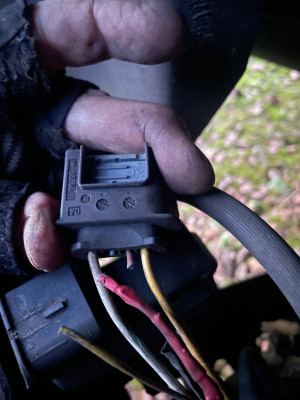

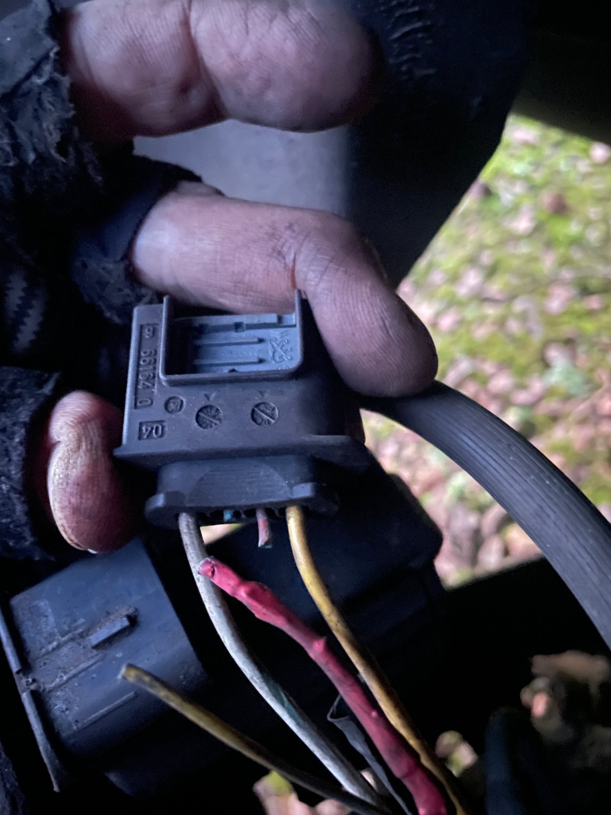

2) My C4 Grand Picasso also had a break in 2 of the wires, directly at the point where they terminate into the 4-pin electrical plug that connects to the rear brake calliper (driver side).
- However, although being much easier to find (literally plugged into the calliper, which you immediately see when the rear wheel is off), fixing it has been more problematic as the wires are broken tight at the plug and therefore impossible to solder/crimp/connector strip at this point as the wire is too short to work with : (
So, my options are either: -
1) Find a car salvage yard/auction site with a 2nd hand C4 plug with 5-10cm of 4 wires retained, so I can join my car wires conveniently into the spare lengths using crimps/connectors & tape.
2) Find a new plug and crimp my wires into it (extending any wires shortened by the break),
3) Open the existing plug and crimp my existing wires back into it (extending any wires shortened by the break)
i did a temp fix with one wire using a connector strip & tape, and the other by jamming the 2 wires together using a larger cutting of copper wire. It fixed the problem for now, but i know the next deep pothole will have it undone before long.
So, I'd prefer to go with option 3), but I've no experience opening this type of plug and crimping wire into it. (see pics)

Forum Treasurer
Posts: 12508
Joined: 07 Aug 2002, 17:12
x 1456
Re: Citroen C4 Grand Picasso 2015 MK2 Brake Fault
Unread post by RichardW »
Welcome along!
Not sure you can de-pin that connector; getting one off a scrap car and splicing it in seems best - sometimes you can get new connectors from Citroen, but no guarantee this one is available.
jonnny1975
Posts: 9
Joined: 20 Feb 2025, 18:59
Unread post by jonnny1975 »
Thank you Richard. I appreciate the kind welcome and very useful advice. I'll get in contact with the scrap yards now.

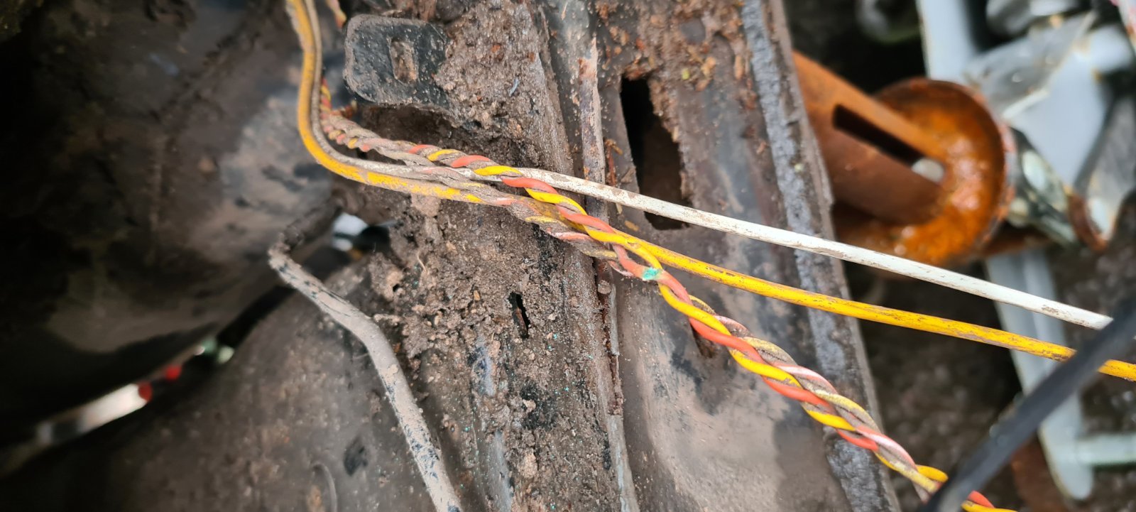

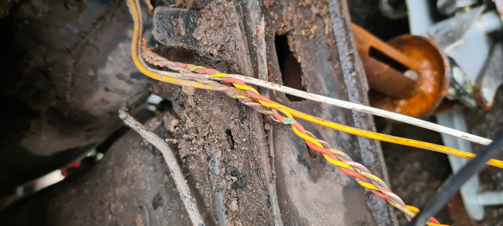

I confirm corroded wire on rear right ABS sensor just before being attached to the fuel tank.
I had all accompanying errors: TPM, parking brake, etc.
Unread post by merlin667 »
Nimik, it looks like your green wire is also allready damaged. in my case it was a bit worse. in addition the copper was allready corroded far into the insulation i needed to replace about 15cm of the ABS sensor loom. luckily i had some twisted pair wiring at home from my 3D Printer (CAN Bus wiring to toolhead)

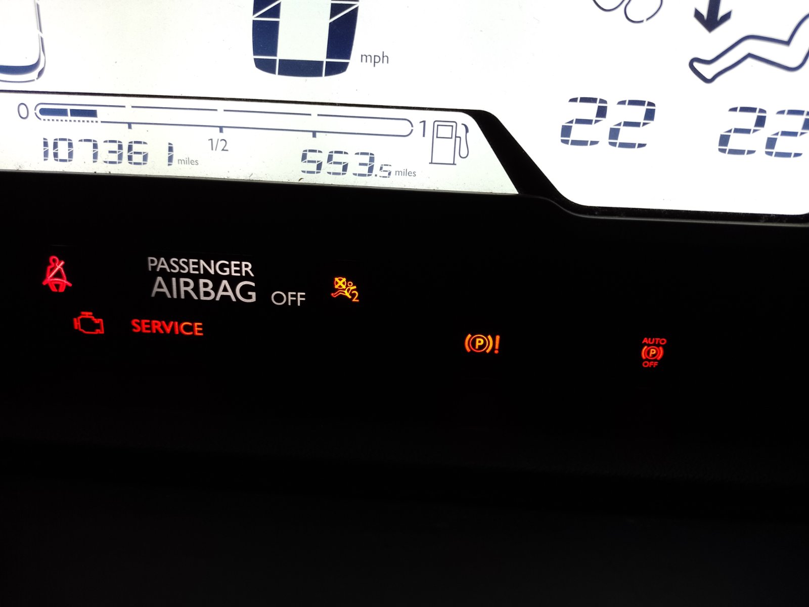

Hello, new member here looking for help with my 2017 C4 Grand Picasso, Blue 1.6HDI.
Currently having bother with the ABS/ESP/tyre pressure/handbrake flashing lights upon start up. Put the icarsoft on it and it's bringing up off side rear abs sensor C003A 11. I've checked the wiring as far as I can see, so would like to change the sensor, but I'm not sure which is the exact sensor. There seem to be so many variables. When I use any site that you enter car reg, it's bringing up a host of different ones. Any suggestions on being able to locate the exact part number? I contacted Parts Direct who came back with a part number of 9800038580, but when I look at other places, it's suggesting 9800098480. Is it imperative to locate the correct part, or would either of these two do? Thanks for any help.
