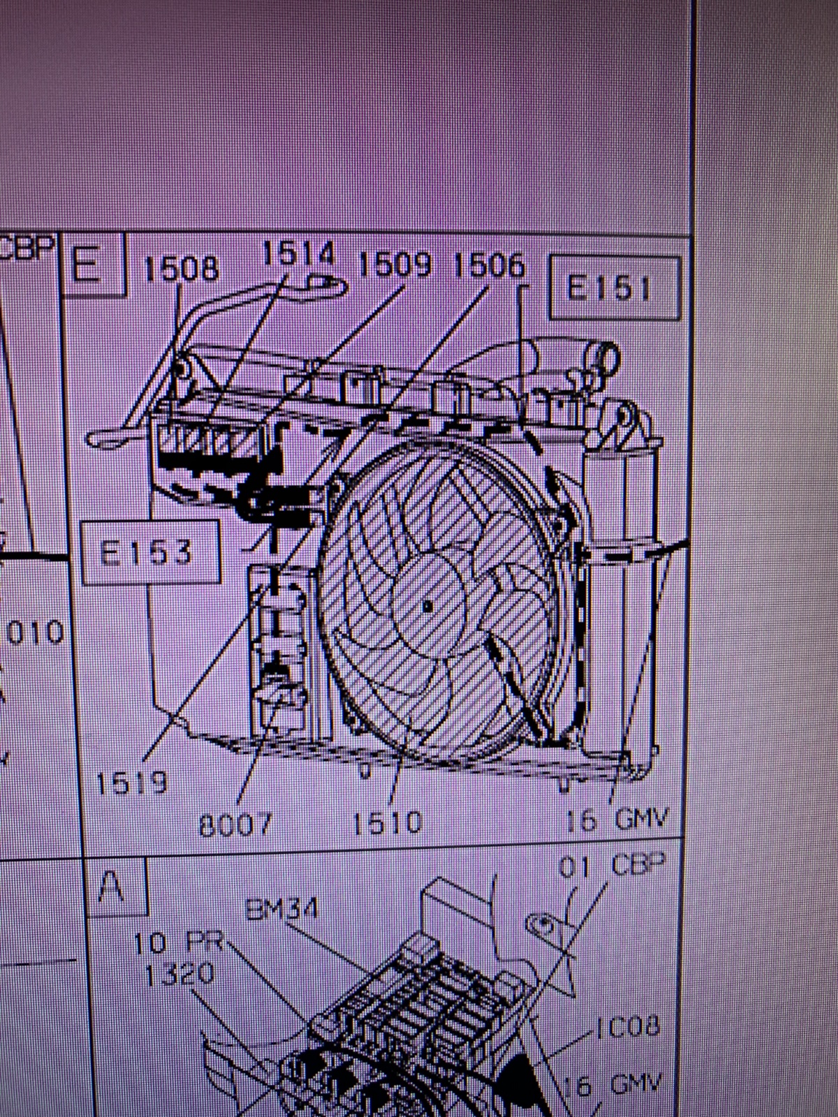

WTCU = water temperature control unit - the name used on earlier models.
It's #1320 in the diagram above, and called 'Engine Test ECU' on the components list.
For safety, do any testing with a 30amp fuse in the line, if coming straight off battery.

Re: Radiator Fan NOT Working Xsara Picasso 1.8sx 2003
1320 is the main injection ECU, this is what switches the low & high speeds on this system. The mid speed is switched by the A/C system.
I know what you mean now, the 15 pin black box under the N/S headlamp on old Xantia's? I just always referred to it as the 'Bitron Box' after the manufacturer.
And yes protect the jumper wire with a fuse or a power probe with built in circuit breaker.

Thanks for posting that clearer screen-shot circuit diagram.
Have printed it out, and studied how it works.
System is described as "two speed" in the components listing, and this is so, but there's also a 3rd speed of fan operation, which kicks in when the AC operates.
Low fan speed
Coolant temp sensor (#1220) triggers ECU to make line 1550 go to Gnd.
RLA #1508 switches on.
Brings +12 power from fuse F2 to Dropper Resistor #1506, and to Motor #1510, then to Gnd.
Fan runs at Low speed.
High fan speed
Sensor triggers ECU to make line 1540 go to Gnd.
RLA #1509 switches on.
Brings +12 power from fuse F3 direct to Motor, then to Gnd.
Fan runs on full 12v, at High speed.
This 12v supply is also fed to line 1512 on the ECU. Not sure of the purpose of this, but could be an instruction to the ECU to increase fuelling at idle, to maintain/increase engine revs, in part to provide additional alternator output. Unsure about this.
AC switched on
When pressostat #8007 outputs a +12 signal, RLA #1514 switches on.
This allows both of the dropper resistances (#1506 & 1519) to operate I think in parallel, providing a dropped voltage (but probably greater than Low speed) to the Motor.
>> Now, ???, this power has to come from somewhere, and it looks to me that it can only come from RLA 1508 (and fuse F2) being switched on, so line 1550 must be Gnd'd too (just like slow speed). I presume the ECU again looks at line 1512, and switches on RLA 1508.
That's how I read the circuit operation.
The system contains 3 relays, but its operation is entirely different to the classic triple-relay arrangement for twin-fan vehicles.
Hope helpful.

Yes that’s about it, the main difference between the triple relay twin fan set up is the 2 fan motors get connected in series To create the slower speed.

The point here is if you power up pin 3 of one of the resistor plugs (with both disconnected) the fan motor should operate even if all the relays are unplugged, unless im reading the diagram wrong ??
This suggests to me that the problem is downstream of the resistors. We know the fan motor works so this suggests to me the motor is either missing its earth or there is an open circuit/ high resistance on the wire that supplies it from the reistor.
The weakest link here is one of the splices (E151)
