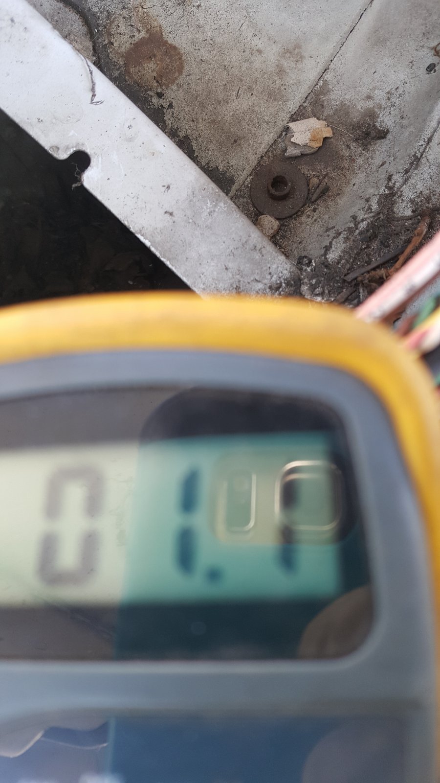

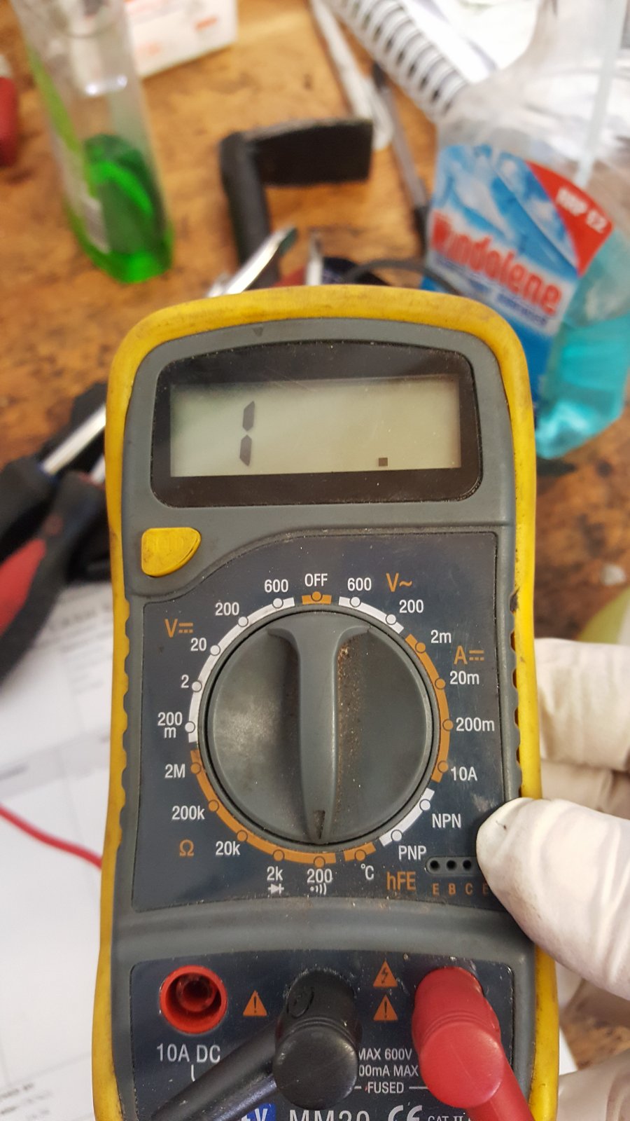

I have now carried out the electrical tests and the results are as follows.
I set the multimeter upon the instructed setting and this was the reading before i started the continuity test

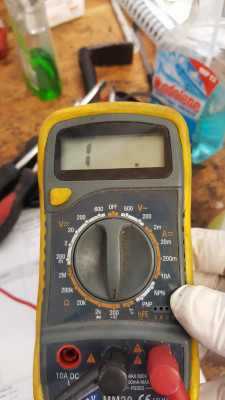

This is the reading with pins connected between the BSI and engine fusebox

The short to earth and short to + did not alter the original reading

Re: berlingo van in eco mode
Unread post by wheeler »
:-k Wiring looks OK then. I'll need to have a think about this one.
