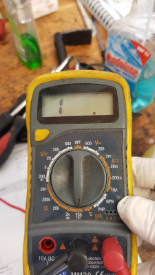

I have now carried out the electrical tests and the results are as follows.
I set the multimeter upon the instructed setting and this was the reading before i started the continuity test

This is the reading with pins connected between the BSI and engine fusebox

The short to earth and short to + did not alter the original reading
wheeler

:-k Wiring looks OK then. I'll need to have a think about this one.
