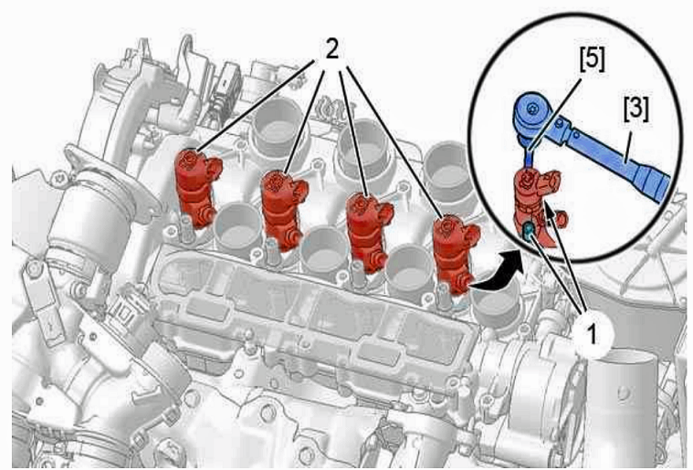

It says for the Diesel injectors fixing pillar screws - Camshaft bearings covers:
Systematically replace the nuts (1).
When tightening by hand, check that the flange (7) stays horizontal and clipped on its circlip.
Stop the manual tightening when the retaining ring comes into contact with the main bearing cap casting.
Pre-tighten to the specified torque: The nuts (1) using the tools [3], [5].
Pre-tighten: 0.5 daNm
Tightening: 1 daNm

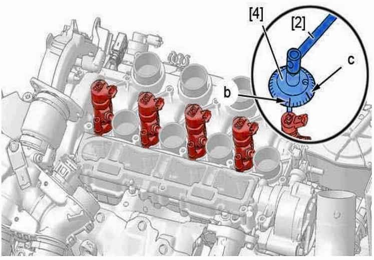

Method for tightening the nuts (1) (Angular tightening) using the tools [4], [2]:
Position the zero (marking "b") facing the operator
Place the moving index "c" to the required tightening angle
Tighten progressively and in one single action, bringing the mobile index "c" opposite the zero (marking "b") of the tool [4]
