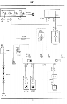

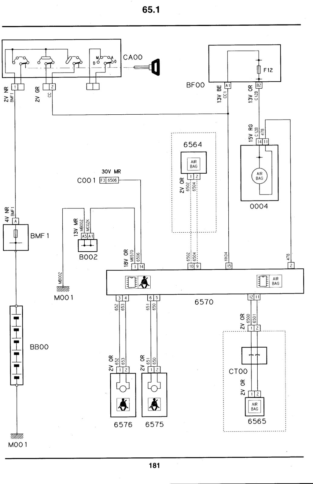

Re: Airbag light: Part no for Xantia for steering column slip ring
The passenger airbag connects to pins 9 and 10 on the controller.
This is the diagram for early S2, but I think that it is the same system as late S1 (1996-on).
Great, thank you! This confirms what I thought.
Hopefully a simple job to trace and measure.
Now to unsolder the bypassed connectors to do the continuity tests...
