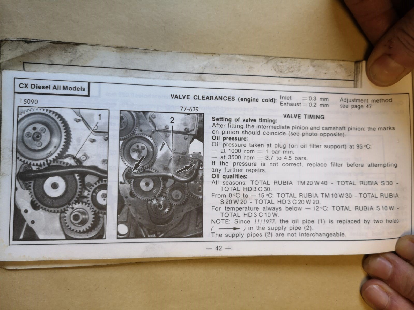

On the timing front, Tom at SGG Dunsfold has come back by email this morning.
He's contacted a local CX expert, who should (should) have the timing data next week.
Hoping to send the pages to me.
Fingers crossed...

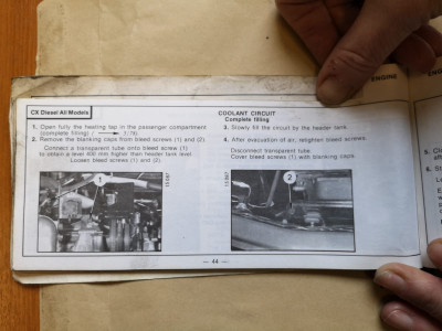

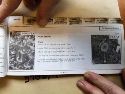

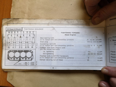

- x 1751
Re: "Barn Find" 1982 or 83 CX D25
Hi Taras,
Tom in the UK has come back with these Citroen pages this afternoon...
? Click to englarge Let me know if that's the info you need, or any other pages. He's going to hang on to the booklet for a while longer before he hands it back to its owner.
Marc - I will tactfully ask later whether we could have shots of all pages for the forum library
- x 1751
My contact in the UK only has this booklet in his possession for a brief while, then it must go back to its owner.
Have posted the pages here, sent Taras a PM, and an email, to ask whether this is all the info which is needed. NO REPLIES received!
