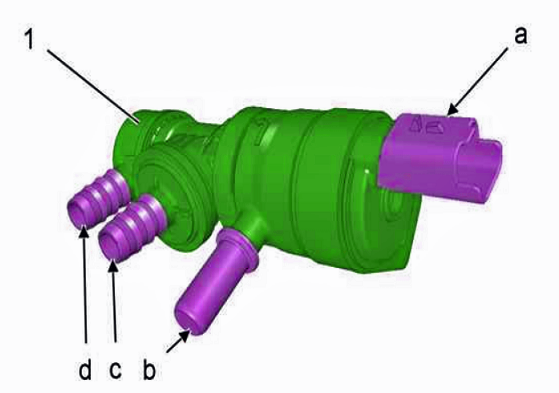

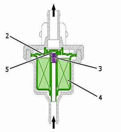

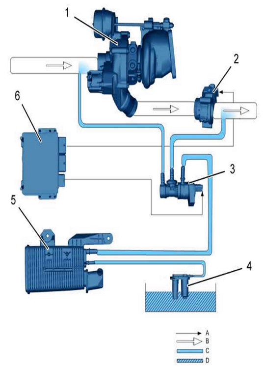

So going back to the purge canister:
When the canister discharge electrovalve is supplied, the magnetic coil (4) attracts the magnetic core (2) which pushes on the valve (5).
The fuel contained in the canister can then be drawn into the inlet manifold.
When the canister discharge electrovalve is no longer supplied, the return spring (3) pushes back the valve (5), which stops the discharging of the canister.
Operation
When the engine is switched off, the canister discharge electrovalve is closed: The canister absorbs the petrol vapours coming from the tank.
When the engine is running, the engine management ECU estimates the load in the canister by progressively opening the canister discharge electrovalve in order to measure the change in the richness of the air/fuel mixture admitted into the engine.
As the engine management ECU knows the output of the canister discharge electrovalve, it uses this to deduce the load in the canister.
The engine management ECU reduces the injector flow and controls the canister discharge electrovalve to obtain the overall quantity of fuel to be injected into the engine.
The control of the canister discharge electrovalve corresponds to a percentage discharging of the canister which varies in accordance with the engine speed and the engine load.
The engine control ECU controls the motorised throttle unit to obtain a vacuum in the inlet manifold.
When the canister discharge electrovalve is open, the vacuum in the inlet manifold permits the drawing in of the vapours stored in the canister.
The use of a second take-off upstream of the turbocharger permits bleeding during the turbocharging phase. The upstream take-off is ineffective when the overpressure is created.
The control of the canister discharge electrovalve is of the OCR (opening cyclic ratio) type.

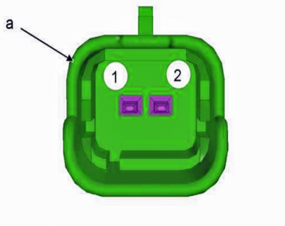

| (1) canister discharge electrovalve. "a" Green 2-way connector. "b" Inlet for petrol vapours. "c" Outlet of the petrol vapours towards the inlet manifold. "d" Outlet of the petrol vapours towards the turbocharger air inlet. Supplier: FREUDENBERG. | (2) Magnetic core. (3) Return spring. (4) Magnetic winding. (5) Valve. |
Operation
"A" Electrical links "B" Air inlet "C" Fuel vapours "D" Fuel |

I had a play with the purge valve that I removed (now presumed to be OK), and it has an interesting characteristic, with the valve not energised, it blocks all airflow (in either direction) at port 'b' (the canister port), but allows some airflow between ports 'c' and 'd'. If you blow or suck hard on ports 'c' or 'd' the valve either closes or oscillates like a squeaky toy. Even with the explanation highlighted in red above, it is not easy to understand the intended operation.GiveMeABreak wrote: 30 May 2020, 23:56 So going back to the purge canister:
Operation
