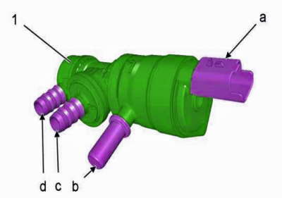

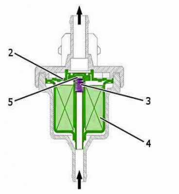

So going back to the purge canister:
(1) canister discharge electrovalve.
"a" Green 2-way connector.
"b" Inlet for petrol vapours.
"c" Outlet of the petrol vapours towards the inlet manifold.
"d" Outlet of the petrol vapours towards the turbocharger air inlet.
Supplier: FREUDENBERG.
(2) Magnetic core.
(3) Return spring.
(4) Magnetic winding.
(5) Valve.
When the canister discharge electrovalve is supplied, the magnetic coil (4) attracts the magnetic core (2) which pushes on the valve (5).
The fuel contained in the canister can then be drawn into the inlet manifold.
When the canister discharge electrovalve is no longer supplied, the return spring (3) pushes back the valve (5), which stops the discharging of the canister.

GiveMeABreak wrote: 30 May 2020, 23:56 So going back to the purge canister:
(2) Magnetic core.
(3) Return spring.
(5) Valve.
