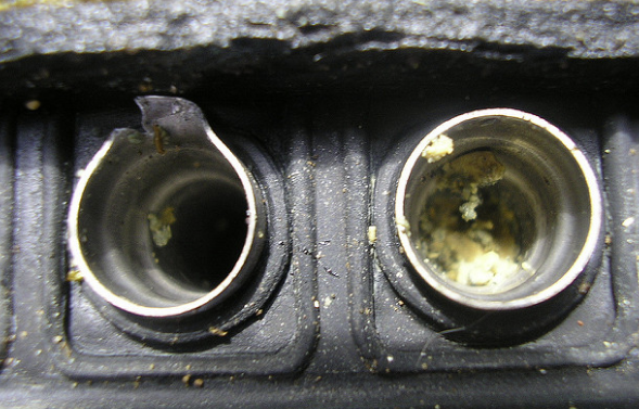

As a follow up, I finally got round to pulling my matrix (20 min job, far easier than the Xantia!)Chris570 wrote: 22 Jan 2020, 21:03 Just to add to this, I have the same year of car and I STRONGLY suspect a blocked heater matrix (as it was for the original poster). Citroen actually changed the matrix for this car in later years so it may be a known fault.
I'll be pulling my matrix soon to confirm if it's blocked or not (my flaps are moving as they should as well as it goes from ICE cold to cold)
I agree though that earlier cars are well known for broken flaps so never say never!
I poured boiling water in one end and only about 15% of the matrix got hot! Its only the passengers side that gets hot which explains it.
There was a LOT of sediment in there, I've tried flushing and back washing and lots has come out BUT still the whole thing isn't heating up as it should, I think the galleries are very small and prone to blocking.
What's come out looks like red brick dust so I'm not sure what's caused it.
Anyway I think it's worth noting that on this car the matrix is quite likely to be the problem when you've got cold air on the RHS

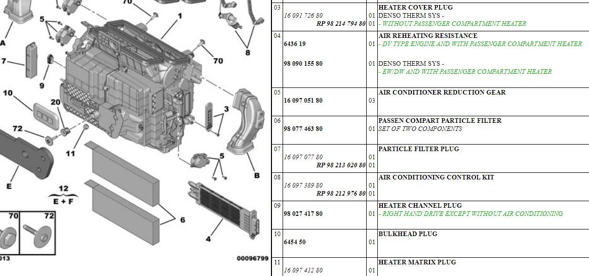

Re: C4 Picasso 2015 (B78 plate) Heating problems
hi marc, this is a link to an image of the heater box and the hole i was talking about emitting cold air. i'd just like to understand what this is before dismantling further . vin number is VF7**************[VIN obfuscated, can be read by forum staff]
there is nothing to go on it and the floor heater duct is above. there is no matching hole on the n/s.

I'm afraid I can't identify that from the picture and the available info I have which is of the other side, but it looks like a fixing for one of the ducts. Bear in mind that the heater units are the same for left and right hand drive vehicles with one heater duct different depending on LHD / RHD.

Just pulled the matrix and of course its blocked. its nice to find a positive fault. The cold air blowing out of the small hole has just been throwing me. I'll try and get a look at another airbox. If the new matrix sorts it I'll just have to leave the hole stuffed with a piece of rag. i just don't like a mystery. Thanks for the help and I'll post the results of the new matrix next week. Will.

It's possibly supposed to be plugged - item 9 below
It is £17.50 though.... I'd be tempted to stick some duct tape over it!
Bad news on the matrix.... at least it's not too hard to get out!!
