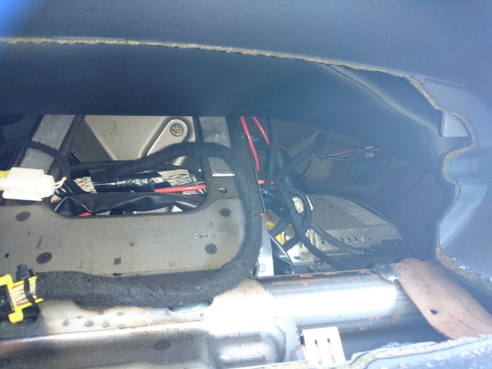

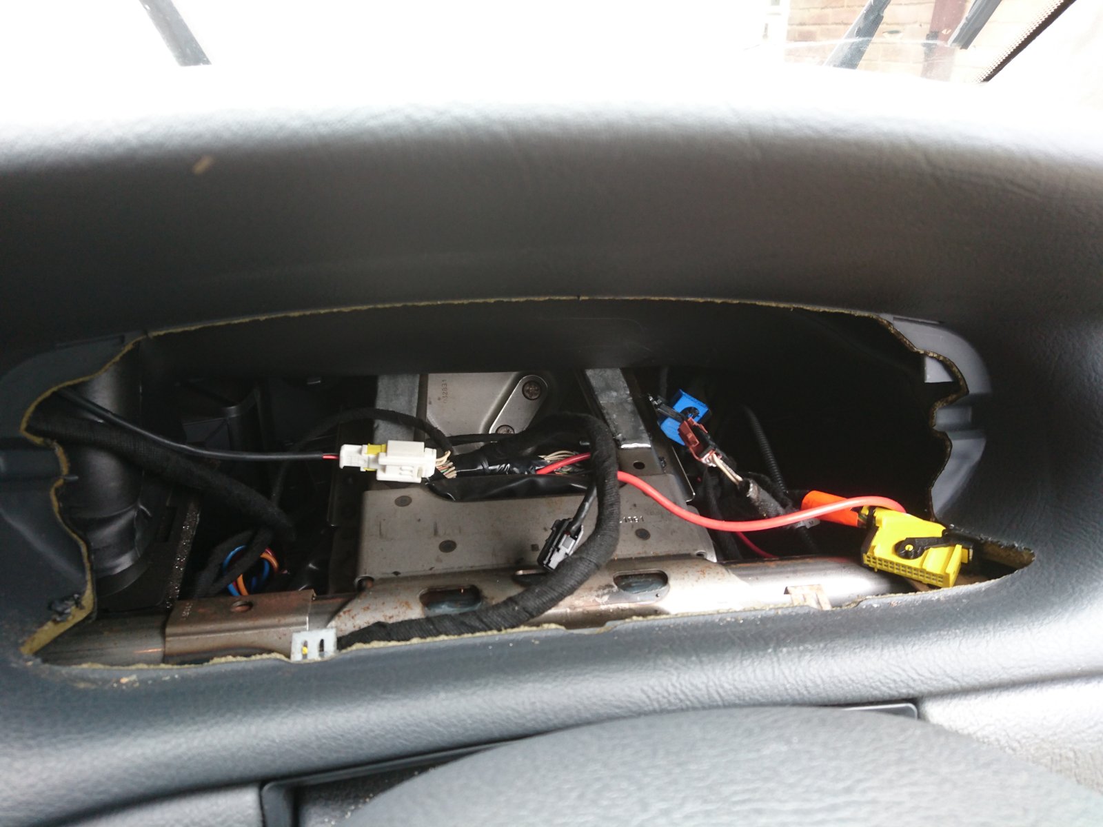

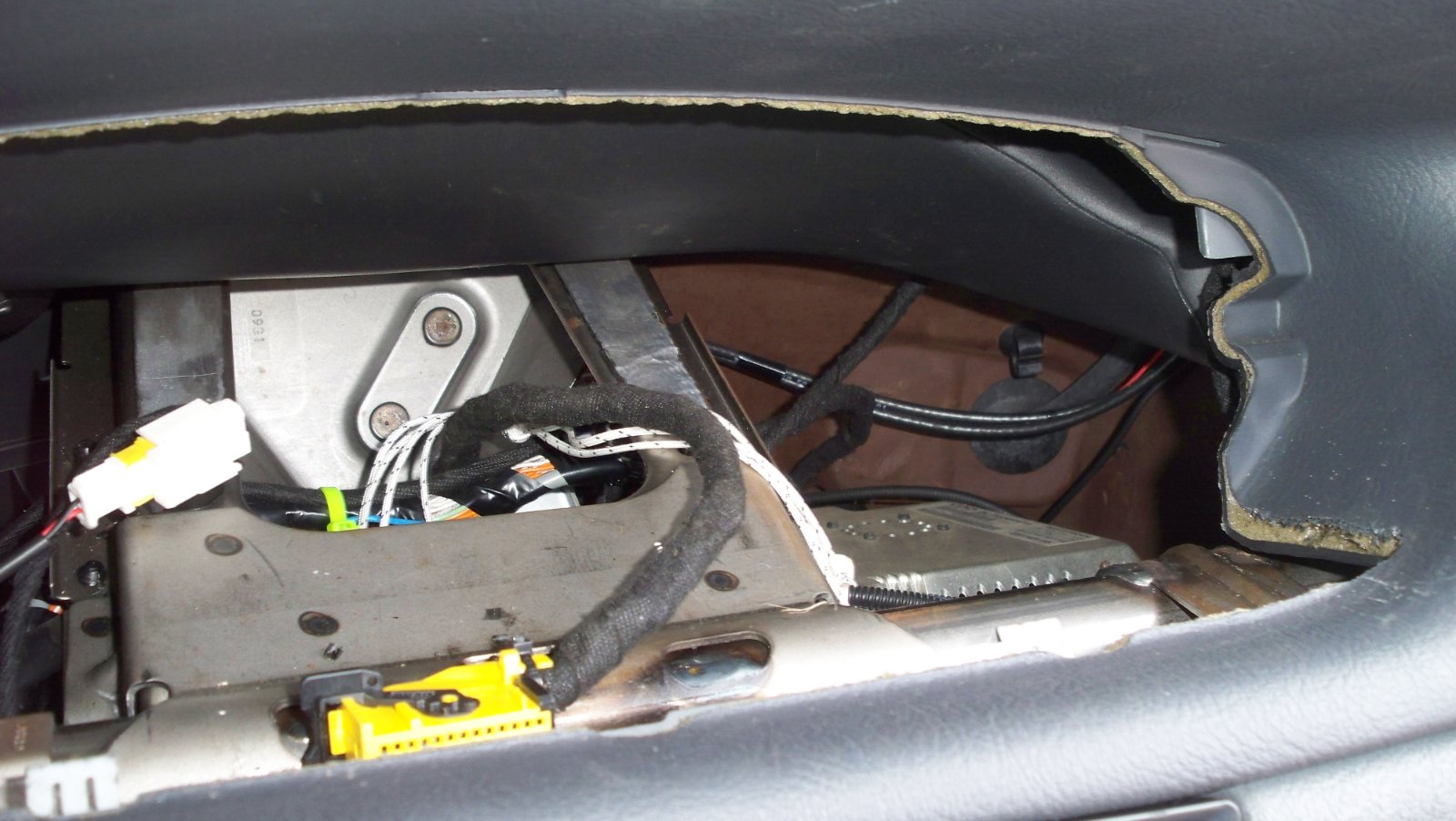

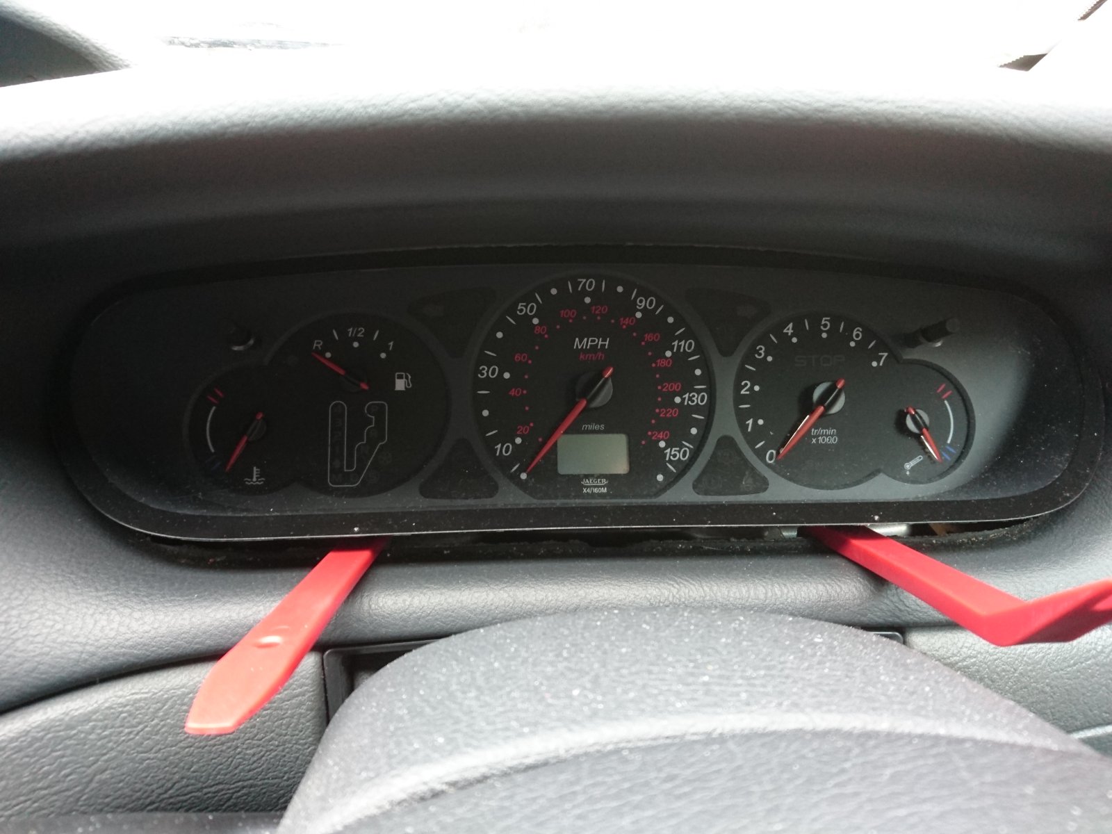

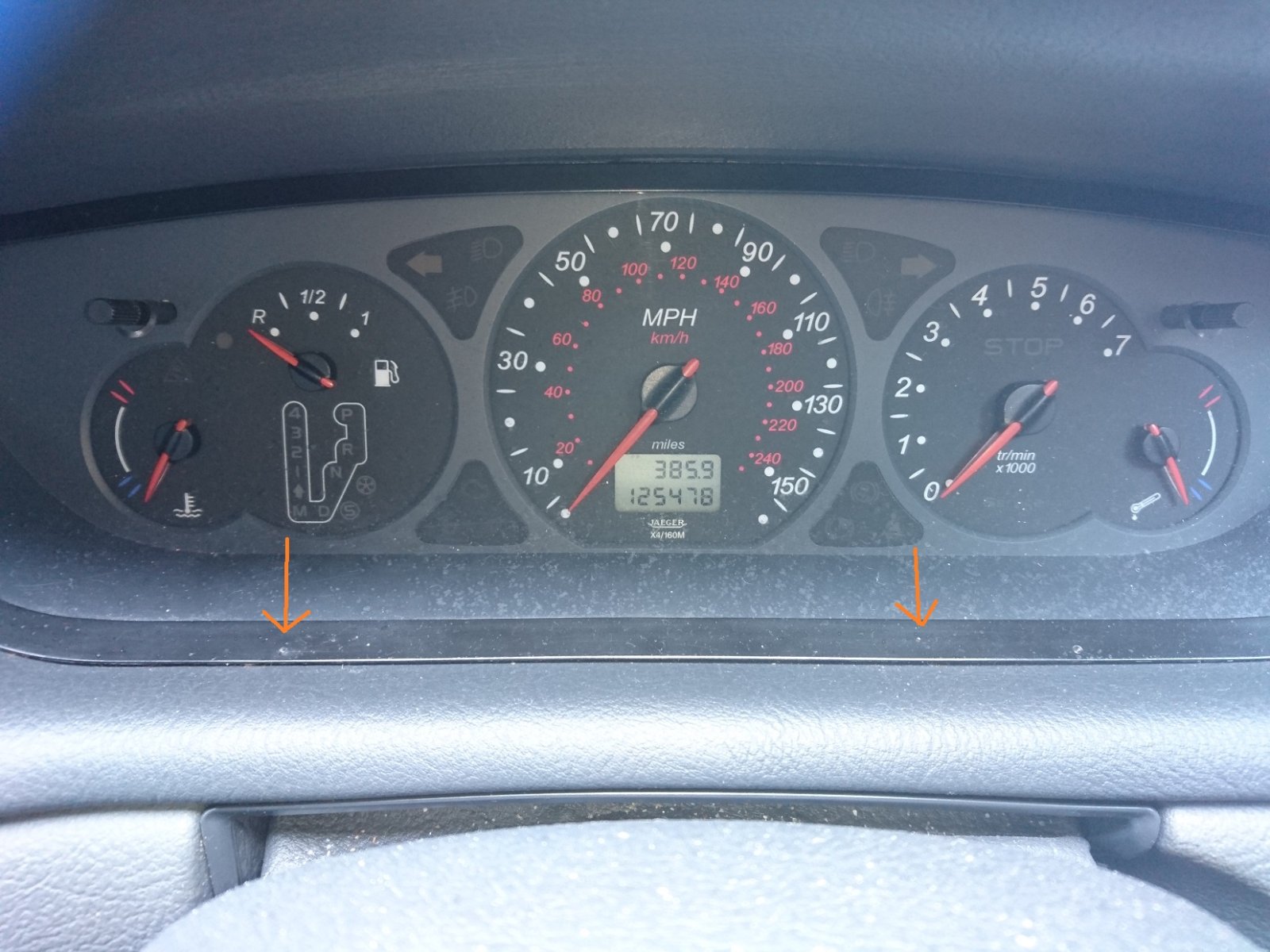

Well, as predicted I decided to have a go at the screen ECU today. I started with the car facing downhill so I would be falling towards the job and not away from it (my drive is a pain!!) and locked the steering in place at the centre position.
Orange arrows show clip point dimples
I inserted two trim tools and heard both clips release:
Trim tools in place
Trim tools in place

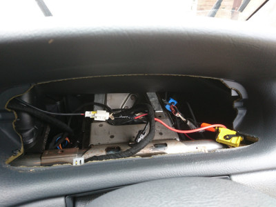

The cluster came forward easily and I disconnected the multiplug and withdrew it completely:
Aperture behind the cluster with ECU on the right

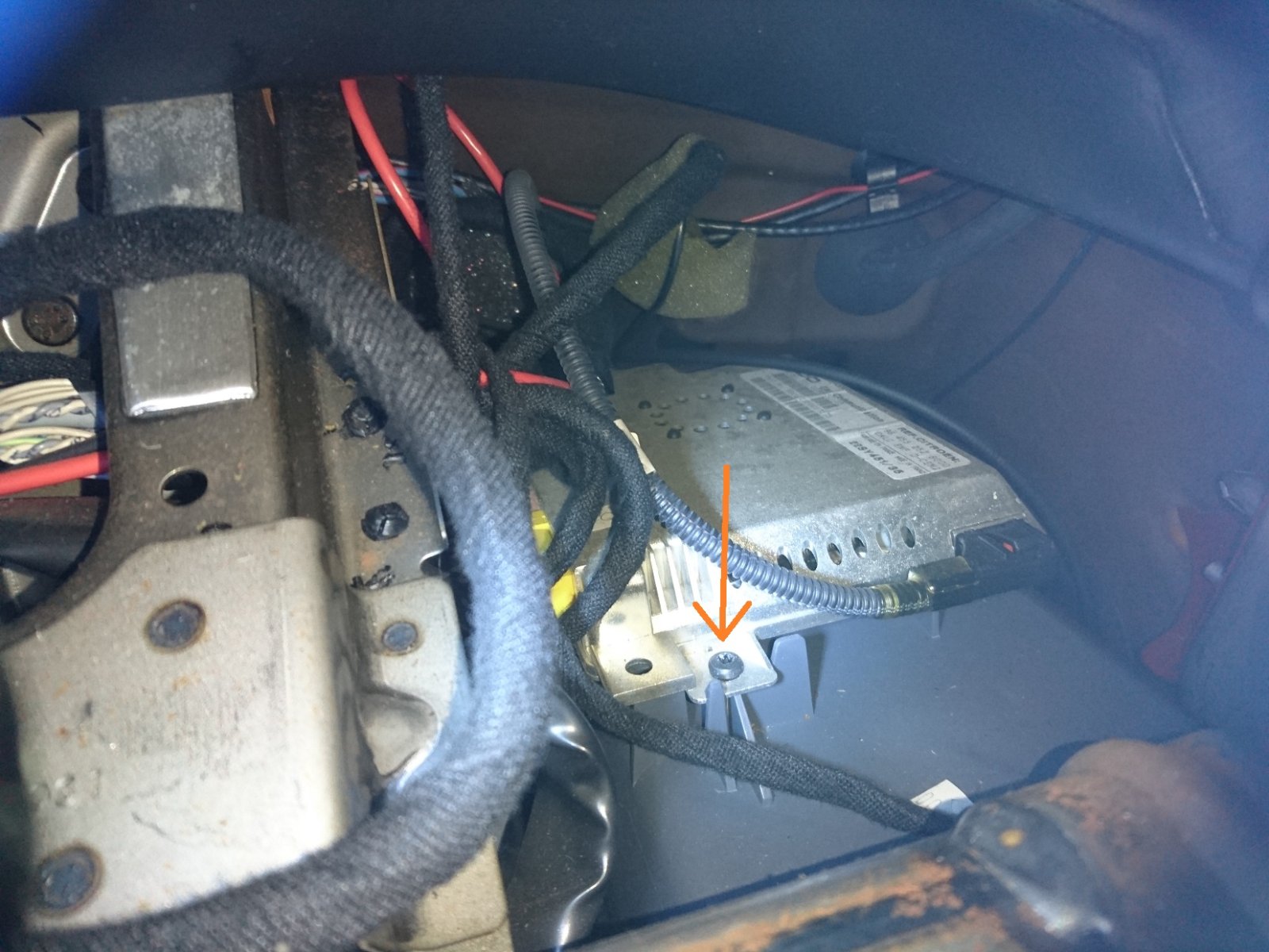

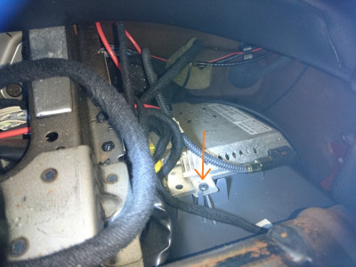

It is retained with a single screw shown here:
Retaining screw
Retaining screw
Then comes the tricky part, work out how and disconnect each of the 5 plugs in turn. At least they are foolproof and cannot be either mixed up or reconnected the wrong way round etc. Finally withdraw the ECU for inspection:
ECU aperture with plugs

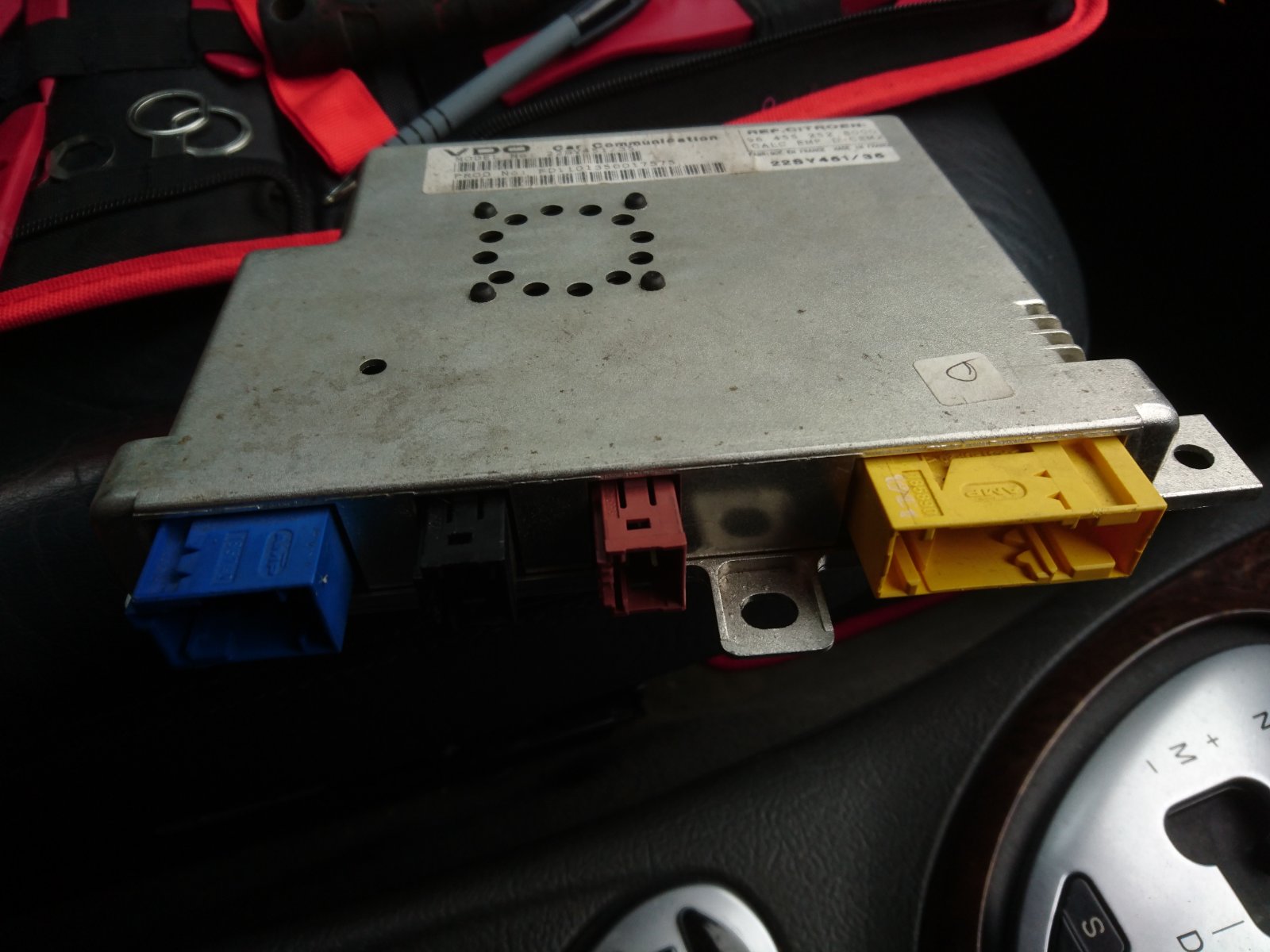

ECU out of its home
ECU out of its home

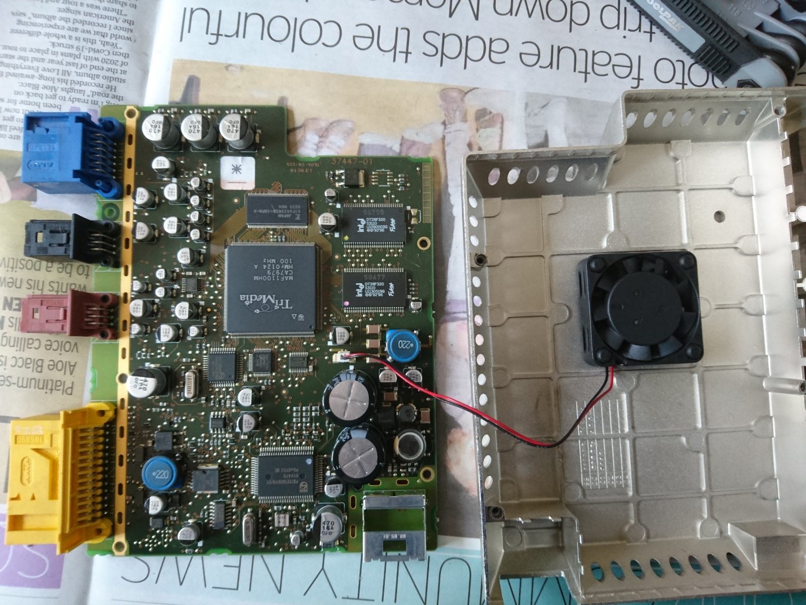

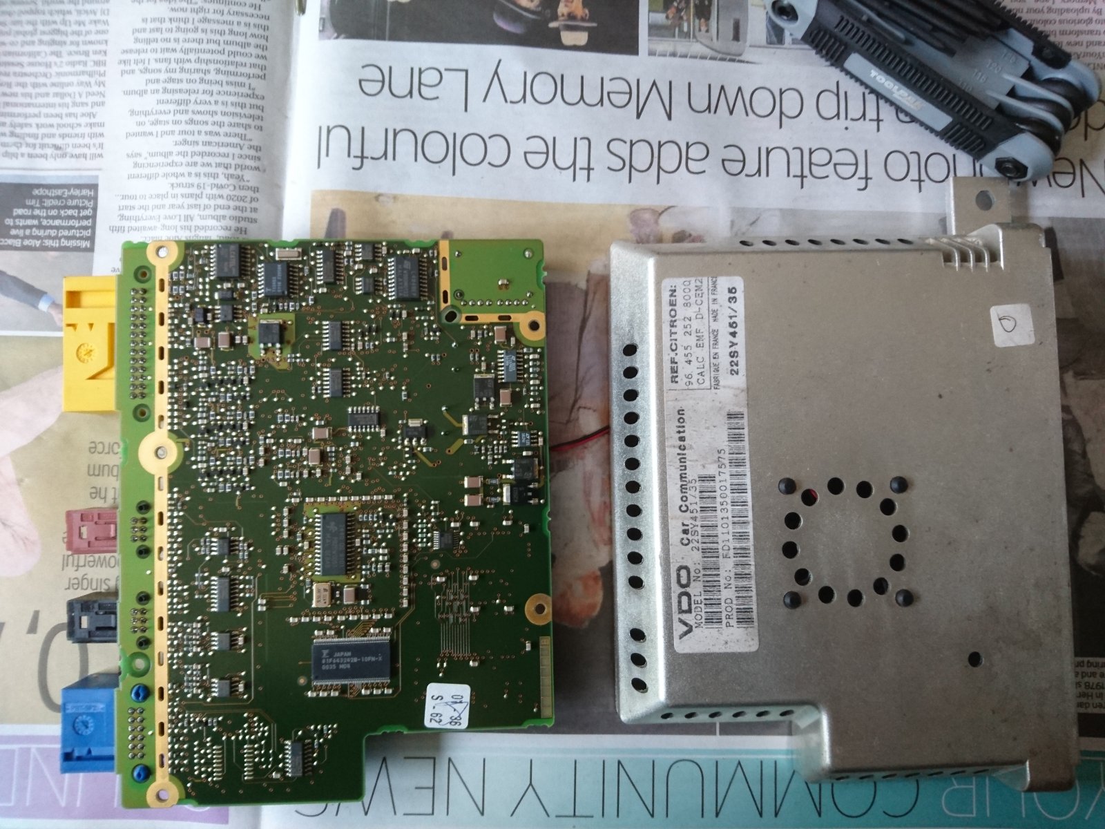

The ECU is held together with 5 T6 torx screws which I did not have a bit for. Having proved to myself, for the umpteenth time, that a terminating screwdriver will not do it I took the MX3 for a quick spin to Toolstation and for the princely sum of £3.98 + VAT equipped myself with a proper T6 driver. Once back home and with the garage bench prepared I turned on the light and watched my 4 T5 tube light unit flash twice and go out!! I moved into the dining room, where SWMBO was reading the news on her tablet, and laid out newspaper on the table ready to strip the ECU. Having removed the 5 screws and carefully disconnected the cooling fan I was a trifle dissappointed to find the board scrupulessly clean and the cooling fan clear of any dust etc. I applied 12V to the fan and it worked fine. Not good! I then examined the entire surface mount technology board with a powerful lens and discovered just two places where the solder caps looked slightly dubious. I resoldered those and then decided to fit the second cooling fan I had to the case:

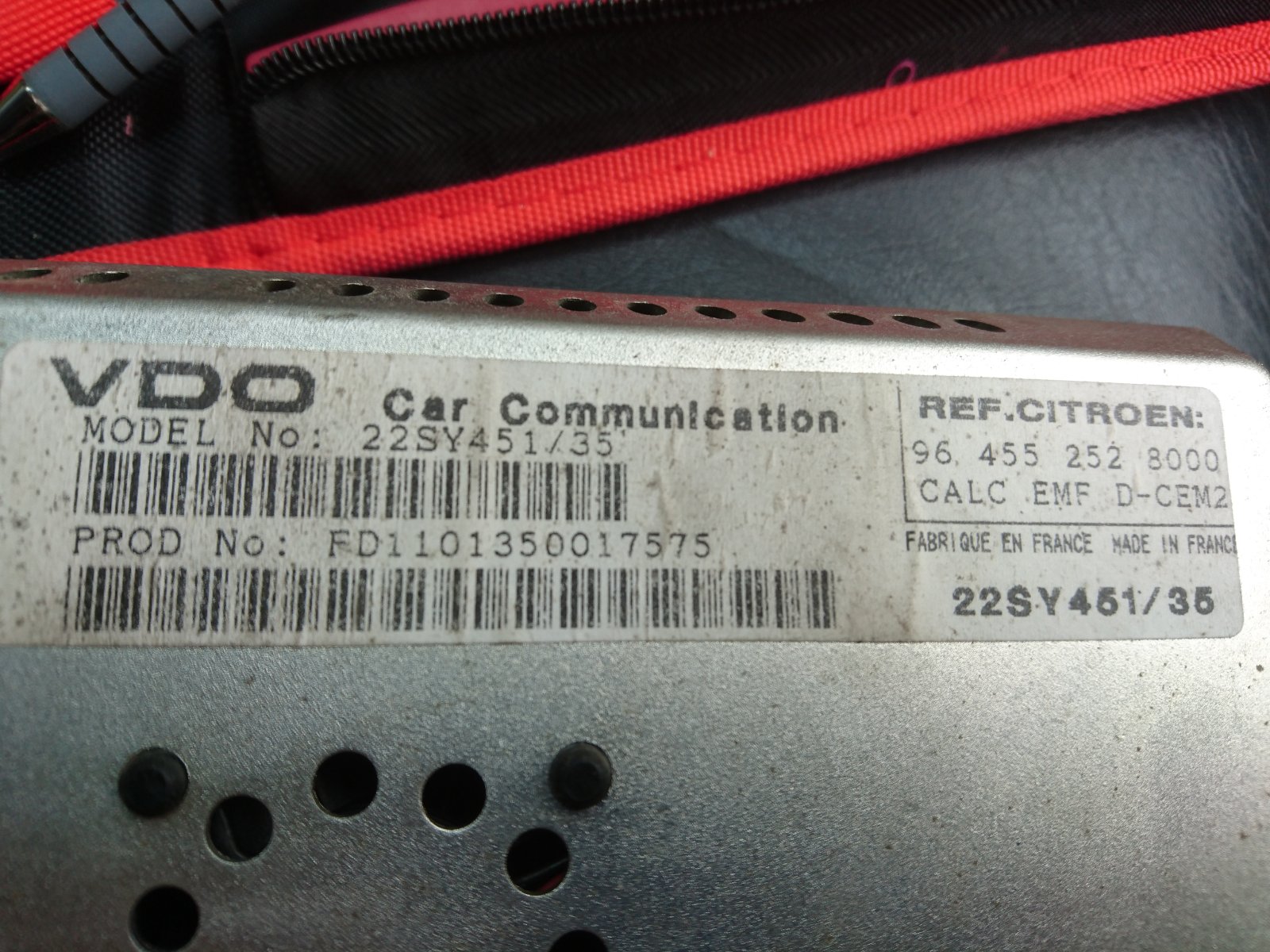

part number label for reference

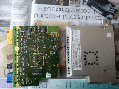

One side of the board
Other side of the board

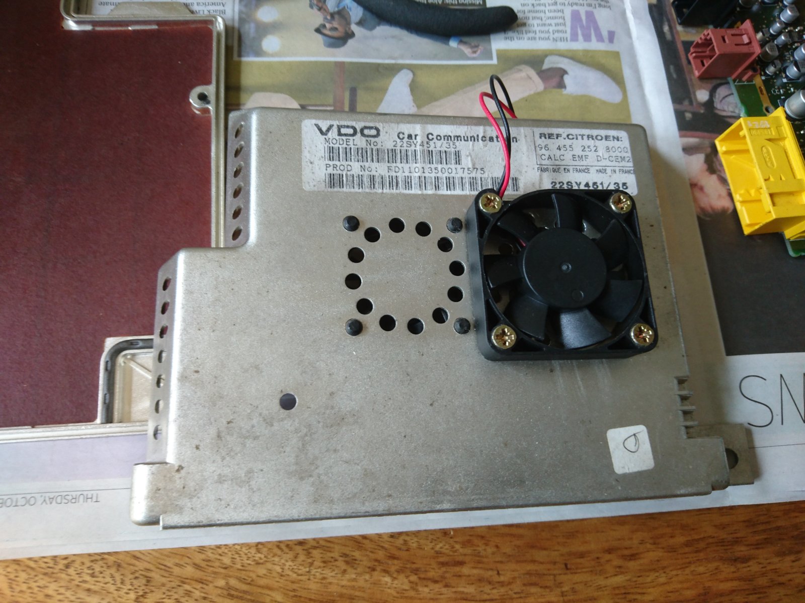

Additional fan fitted outside to blow air into unit
I fitted the blow fan in such a way that I can duct air from the aircon to it if necessary. :)
Finally it was time to refit the unit in the car and see if it worked!!!!!! :) :) 8-)
It didn't!! :( :( :( :cry: :cry: :cry:
So it looks like I'll have to get a new unit and possibly swap the boards so I have the additional cooling from the start which hopefully may give it a longer life!!
