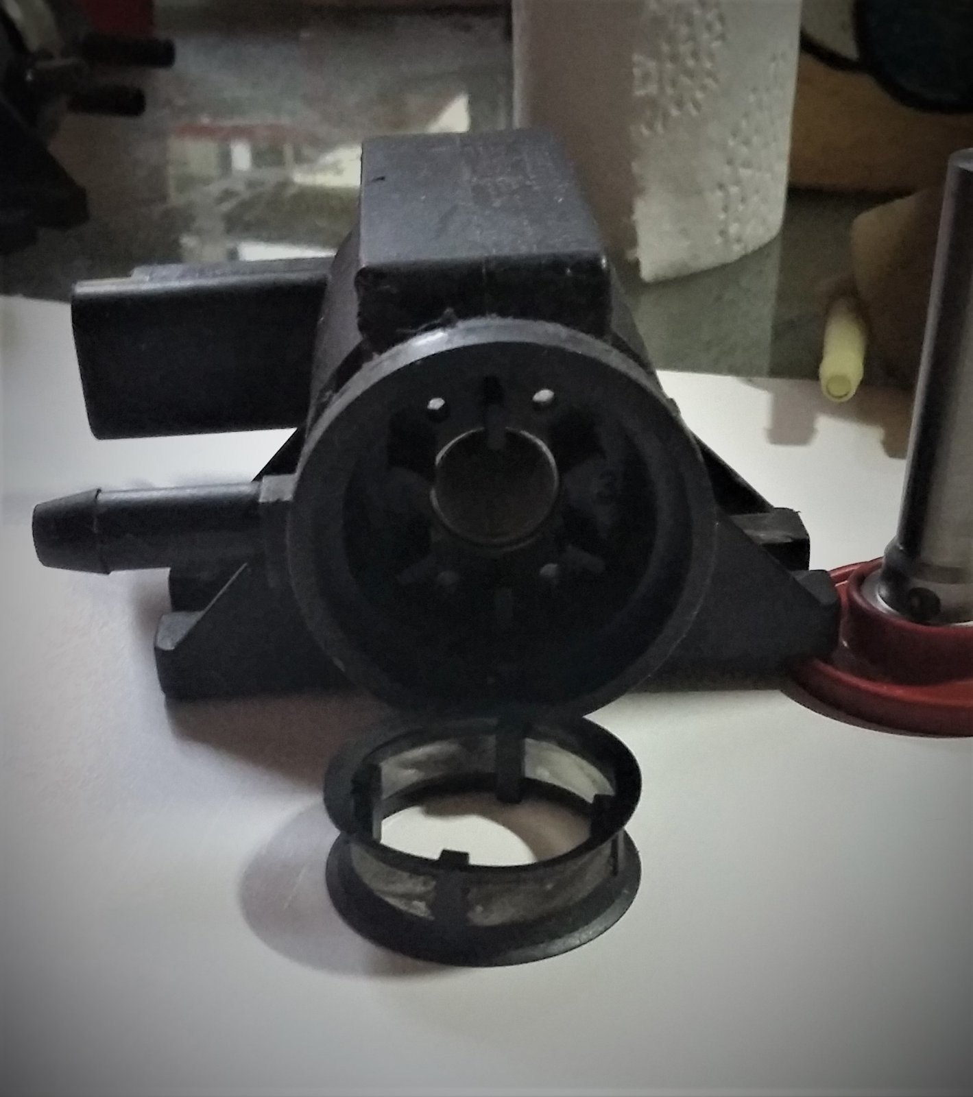

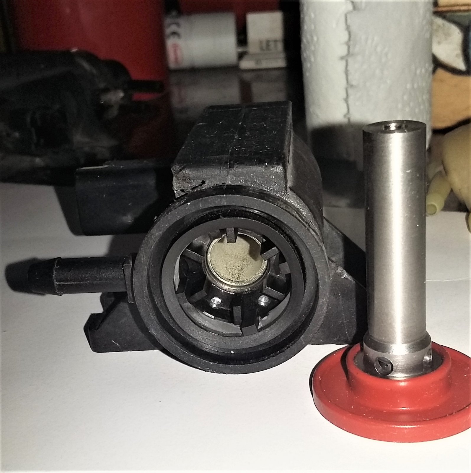

Opened the old one out of curiosity...it has a (very dirty) internal filter as well.
- x 6946
Re: DPs Fault 1 hour before MoT.....
Cleaning the filter has been known to cure issues - some of the older ones had a sponge type filter, but yours looks a bit more like gauze.

It has the outer filter as well as this inner filter....this has the same product number but is different inside than the one I saw being dissembled on the internet.

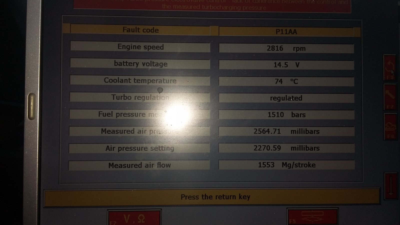

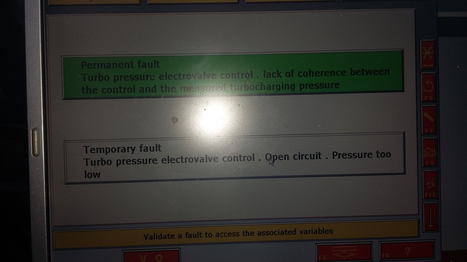

BUGGER....the new valve did not fix the issue.
New fault text.......Not to sure which way to go now

I will try a manual test of the valve via Lexia tomorrow.........Can you test the valve via Lexia ?
I was also wondering why the fault code description has change with the new one on ?
- x 6946
“...Has change”? It’s the same fault code as you had earlier P11AA.
The code has quite a few possibilities for the culprit though, as per the fault description I put up earlier.
- Posts: 11840
- Joined: 28 Mar 2013, 21:05
- x 1997
Before it was not the same description, code yes the same, the description was just pressure related before....now it has this "open circuit" stuff in a second box."
