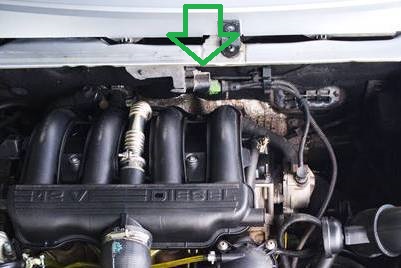

Maybe this? Dont have better pic. to this stuff going two pressure tubesYou will have the EGR valve/solenoid (#437), but I'm not sure where it is located on the 2.1 engine.

I can't confirm that that is the EGR valve/solenoid. Others here may know.

Keep an eye on that connector!
(It is the one where the Intertia (crash) Switch used to go, before it was deleted. The link is essential to allow the injection ECU and injection to function.)
XM is a car guaranteed to exercise the brain cells when it comes to electrics. Fortunately, we have detailed circuit diagrams and technical info for it, and all model variations.
