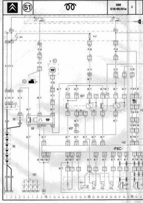

Bit of progress.
Thanks for the VIN number. This shows that the car's RP (production date) number is 7522 (= 13 June 1997). This number should be painted on a front A-post, between the front door hinges. Might say CJ7522, or something like.
From that, the correct circuit diagram for your car is 518-05/61a.
I have this, but it's not a good quality copy, so I have tweaked the image as best I can for the Bitron/keypad side of the circuit...
As Mike has said, it differs from the later circuit of Gabor's, in that his pin 10 of the Bitron goes to pin 40 of ECU, while yours (as in the circuit above) goes directly to Gnd. #620 (the Inertia Switch) was deleted on later diesel vehicles (including yours), although Gabor shows it just for information. The connection 9-->20 is continuous, no switch.
The image above is correct, but not easy to read, so you could continue with Gabor's circuit for most things, especially the connector numbers.

Look forward to seeing you club-xm, where you'll find lots of help and information, including ABS.
Getting the car mobile again is a great Christmas present, so well done for sticking with it.
Keep an eye on that connector!
(It is the one where the Intertia (crash) Switch used to go, before it was deleted. The link is essential to allow the injection ECU and injection to function.)
XM is a car guaranteed to exercise the brain cells when it comes to electrics. Fortunately, we have detailed circuit diagrams and technical info for it, and all model variations.
