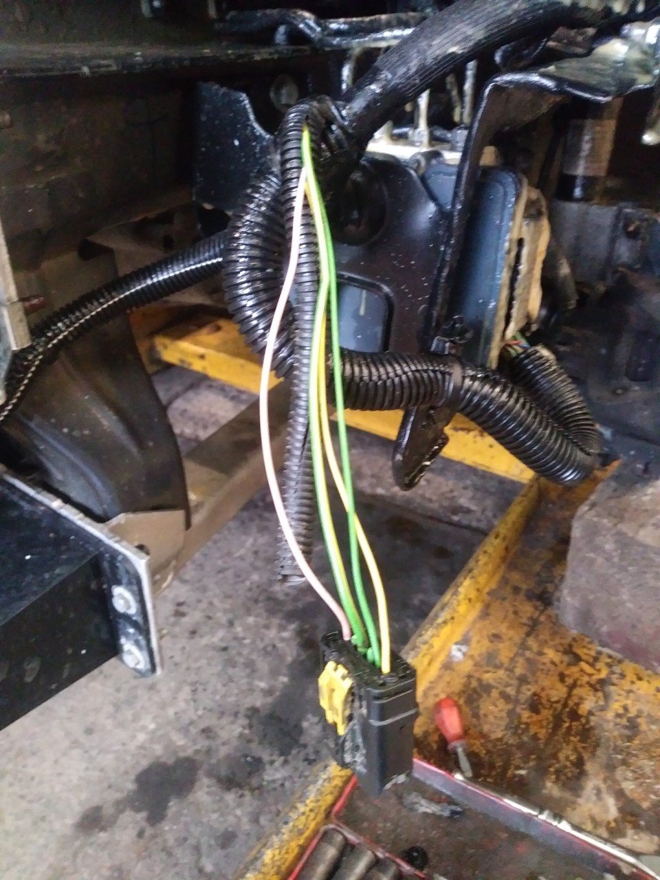

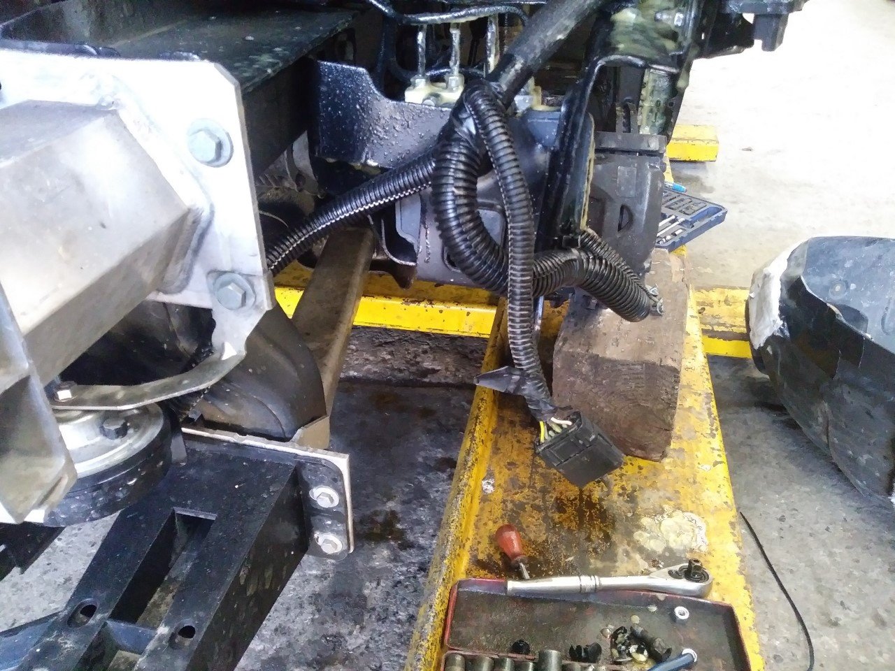

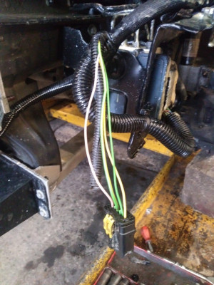

Hi, does anyone know what this plug is hanging down infront of the abs pump. Looks like there is a bit of broken plastic connector attached to it but it doesn't seem to do anything!.
Don't want to replace the bumper if it all has to come off again. Thanks all :)

Re: Accident damaged Berlingo abs fault
It's obviously part of the engine harness - but if you can peel back some of the black tape, the wiring usually has a code (4 numbers or 4 numbers and a letter generally) on the wiring sleeve, but may have fewer. If you can provide one or 2 of those I might be able to provide the purpose and therefore the component it goes to.

GiveMeABreak wrote: 02 Nov 2019, 11:38 It's obviously part of the engine harness - but if you can peel back some of the black tape, the wiring usually has a code (4 numbers or 4 numbers and a letter generally) on the wiring sleeve, but may have fewer. If you can provide one or 2 of those I might be able to provide the purpose and therefore the component it goes to.
Thanks Marc,
Unfortunately I can't see any markings on the wire. The van was stripped for assessment by the insurance company so they may have binned whatever it was connected to if anything or it might have just been lost in the accident.
Unread post by wheeler »
You need to look really closely, they will be there, the code is normally printed every couple of inches along the entire length of the wire.
see this thread for identifying wire codes > viewtopic.php?p=611812&hilit=printed+wire+codes#p611812

wheeler wrote: 02 Nov 2019, 12:01 You need to look really closely, they will be there, the code is normally printed every couple of inches along the entire length of the wire.
Had another look with a bright light and I can't see any markings other than a couple of black lines on the yellow wire ??
