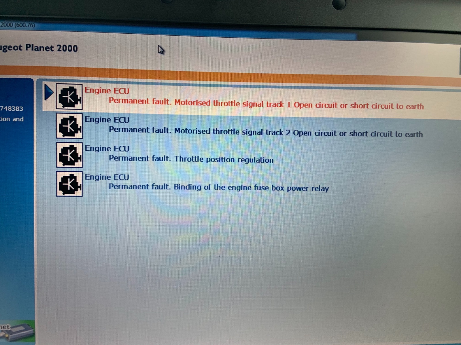

On this 2007 model the throttle position sensor is built into the throttle body..... so its going to be £150 so i want to be sure thats the correct thing to do based on the pp2000 ecu read?

Your DAM is your build number, pop your VIN up if you want to know what it is, plus it will help me identify the engine ECU for a proper interpretation of the fault code.

Ok, so your DAM number is: 11253Markdas wrote: 20 Jul 2019, 13:05 Ok, my parcel is here, plugged it all in......
Entered the VIN number but PP2000 option was asking for a DAM? No idea what that is?
So i used Diabox option.....P0122 throttle position sensor?
So is that it? I cant see how to run anymore checks of other systems?
Am I missing something?
Cheers
Mark
Here's the fault code explained - though I'm not sure about 'deactivation of the driver'
| Fault code | P0122 |
| After sales description of the fault code | Motorised butterfly track 1 signal fault: Open circuit; Short circuit to earth |
| Description of the diagnostics | Wire 1 throttle position signal: The voltage of the butterfly position signal is above a threshold |
| Conditions of activation of the diagnostics | - |
| Conditions of disappearance of the fault | - |
| Down-grade modes if fault present |
| Switching on of the warning lamp and/or warning message | - |
| Suspect areas |

Jeez there is a lot there! So do you think im safe to assume that a new throttle body will solve the problem?
Or could this still be the wiring to the throttle?
Thanks for the info....i’ll try again with pp2000 and the DAM
- x 6954
Re: Another 206 non starter!
That's the problem - a faulty wire / pin or the unit itself...
There could be 2 types of system fitted to your vehicle - either the electronic accelerator pedal potentiometer or the mechanical cable from the accelerator to the throttle assembly in the engine bay.

If you have the option to choose PP2000 or Diagbox, try diagbox. Run a Global Test and then go into the injection ECU, then select parameters and there should be some tests you can select. Some should be able to detect the pedal movement as you operate the accelerator - but have a look and see what is there.
