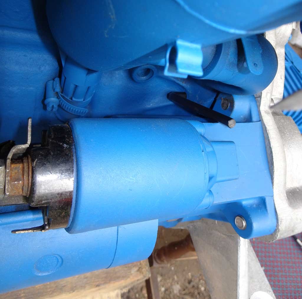

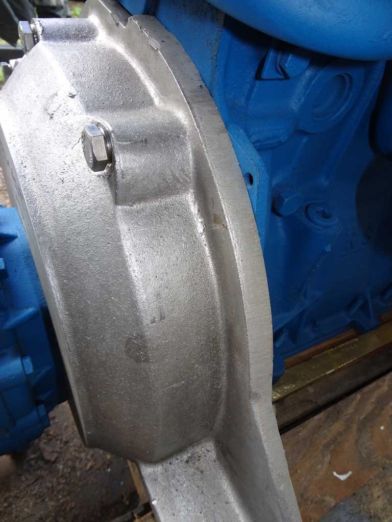

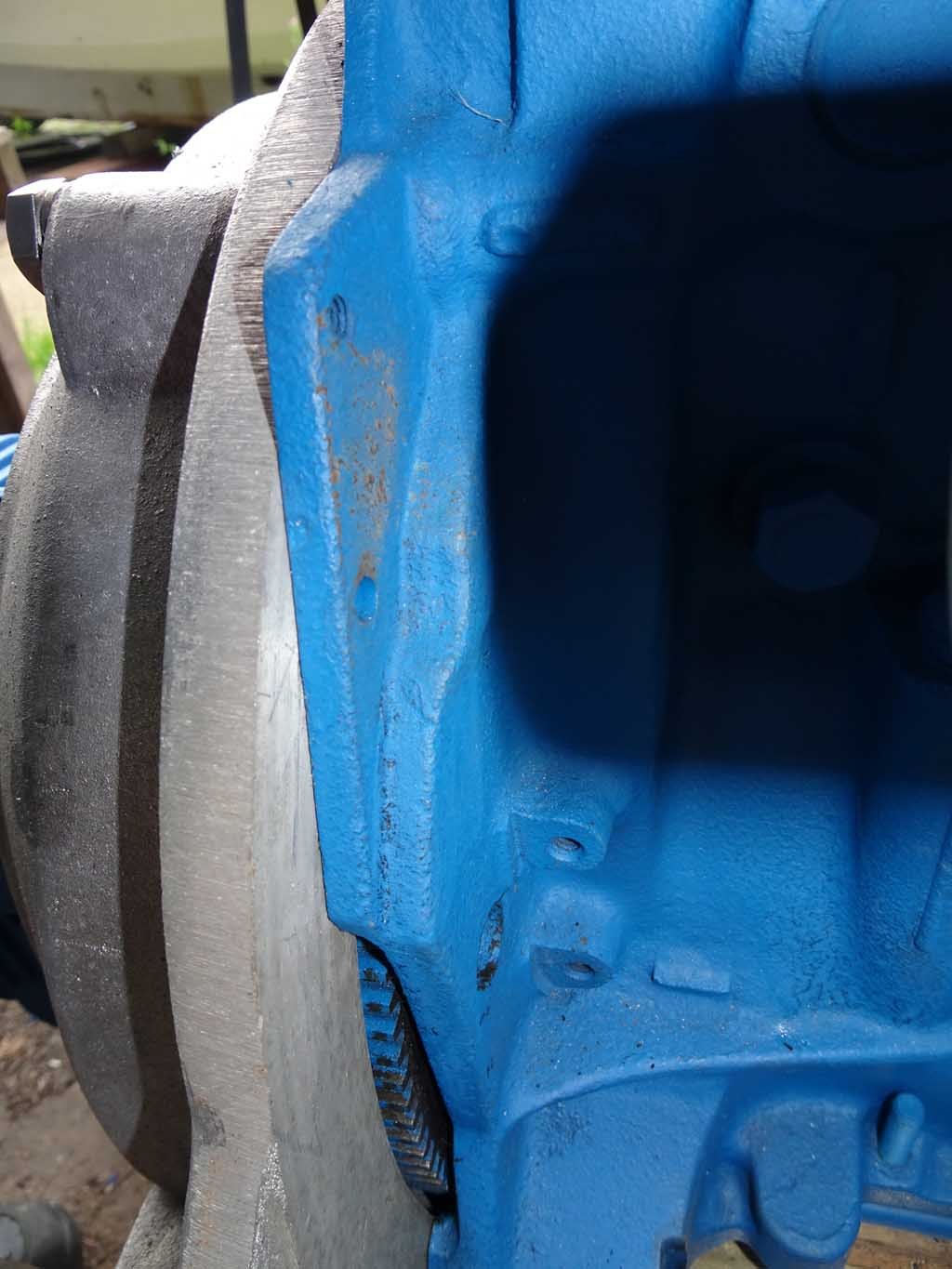

Well it looks like that TDC sensor is a no-go, with no access through the bellhousing.
That mystery hole lower down, the sensor does fit nicely in that, but the holder doesn't fit the two holes, also a few teeth showing there, wonder if it has a purpose.
As for the cambelt, I don't have the new belt yet, but I made a start in preparation for getting it. I was able to get at the hole behind the starter.
A 6mm allen key was handy with its bend, though I ended up using the long end when I found TDC, it went in all the way. The front spocketes are locked in place with bolts and I got the bottom plasic cover off without removing the crank pulley. The crank pulley nut, using a long-arm socket made turning the engine into place easy. Loosening off the tensioner was not so easy, that spring is strong, but got there. I marked the belt, but left it on utill I get the replacement.

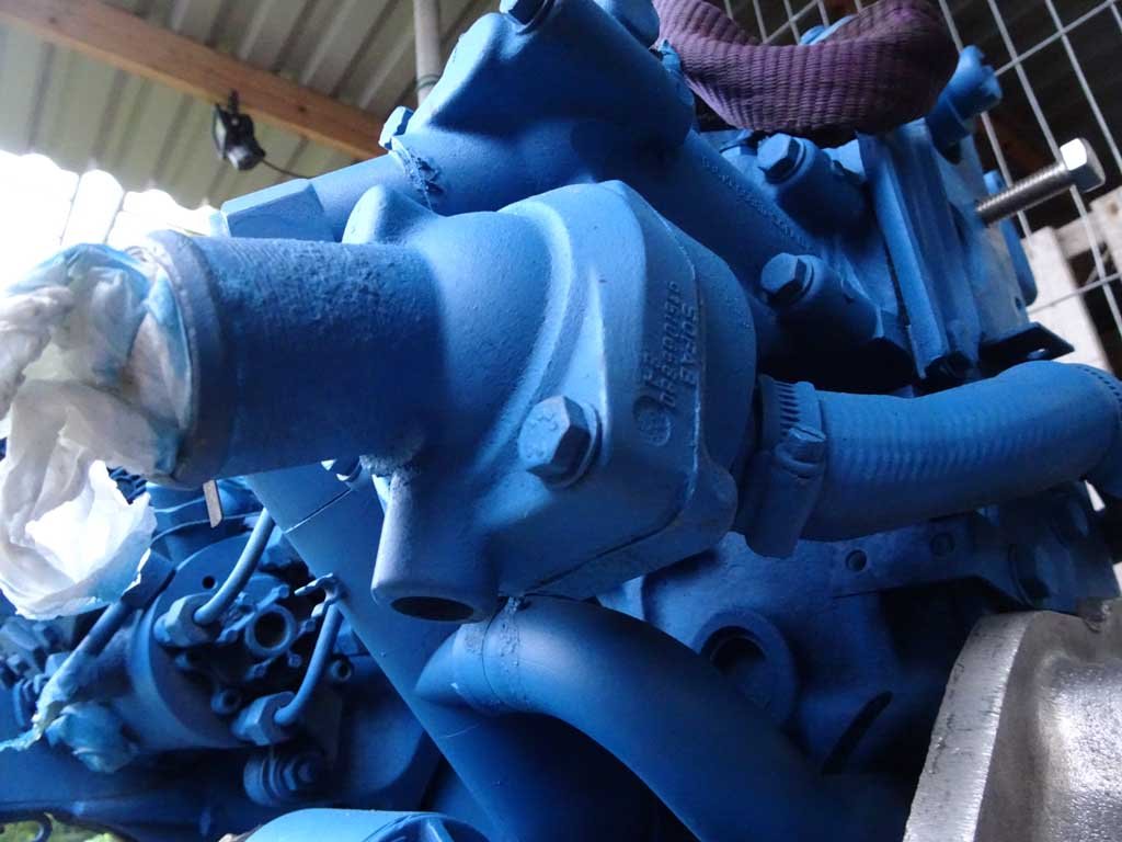

As that was as far as I could get with that, next I did what I thought would be an easy job, flush out the cooling system. It says to take off the thermostat cover and bung a hosepipe in, sounds easy.
The 4 bolts on the thermostat housing, man they were tight. Got the two on the right with the long-arm socket, but bruit force and ignorance on the bottom left bolt sheared it. The top left was also tricky as its surroundings meant you couldn't get the socket on, the small socket set (with a lot less leverage) could get part way on, but when you try that with a stuborn bolt you only make its head round. It eventually moved after hammering the socket on and pushing both ways until it decided to come loose, thought it would shear too. The one that did shear came out with stilsons.
I noticed the round bit that sticks out on the thermostat was a bit bent, not sure how, it may have been me strugging to pull the thing off that broken bolt. I straightened it out to best effect, but not sure how critical that is.
I didn't take the thermostat out, I didn't have circlip pliers quite big enough and it looked well rusted in.
I didn't put the cover back on due to shortage of bolts, didn't want to use the same old rusted up ones again and they are 7mm ones. I had a few 7mm left over from doing the sump, but only 3 are long enough. Think I'll try and get stainless, but 7mm is an odd size.

I have memories of the 'stat housing bolts being tight and difficult to undo, first time round.
Stainless bolts (and a bit of copper grease) should do it.
To avoid rounding of stubborn bolts/nuts, hex (rather than the usual bi-hex) sockets work well. Impact (air wrench) sockets are usually hex.

I have been using stainless where I'm adding or replacing bolts, and copper grease where I will want them to move again, given the salt water factor.
