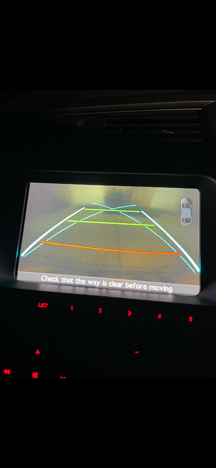

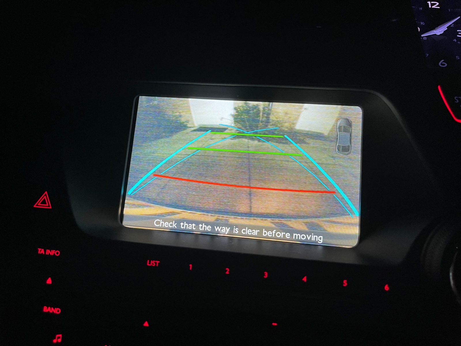

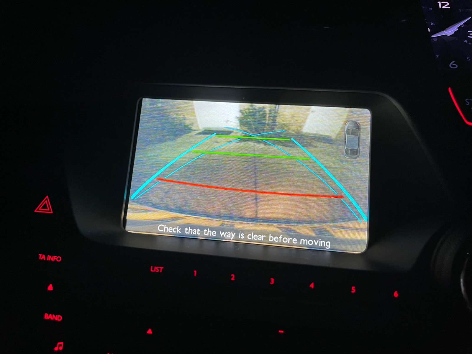

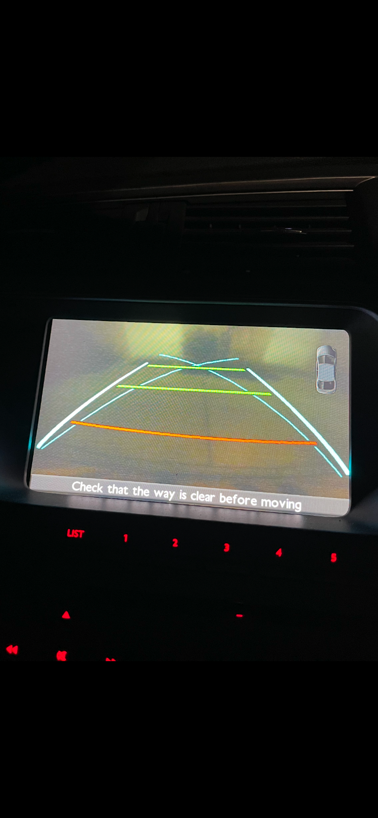

Just had to replace my reverse camera, DS5, 2014, D-Sport. Image on it became hazy. Found a £60 one online. Image is back to normal, sharp and clear during the day, not sure if it's got night vision, but it seems to be a bit better than original one at night. I also changed the reverse bulbs with LED before this. Had the car up on an elevator, and took the camera out from underneath the car, took about an hour the whole process. Camera was perfect match, so no improvisations. Photos attach, the clearer one is with the new camera and led bulbs.
